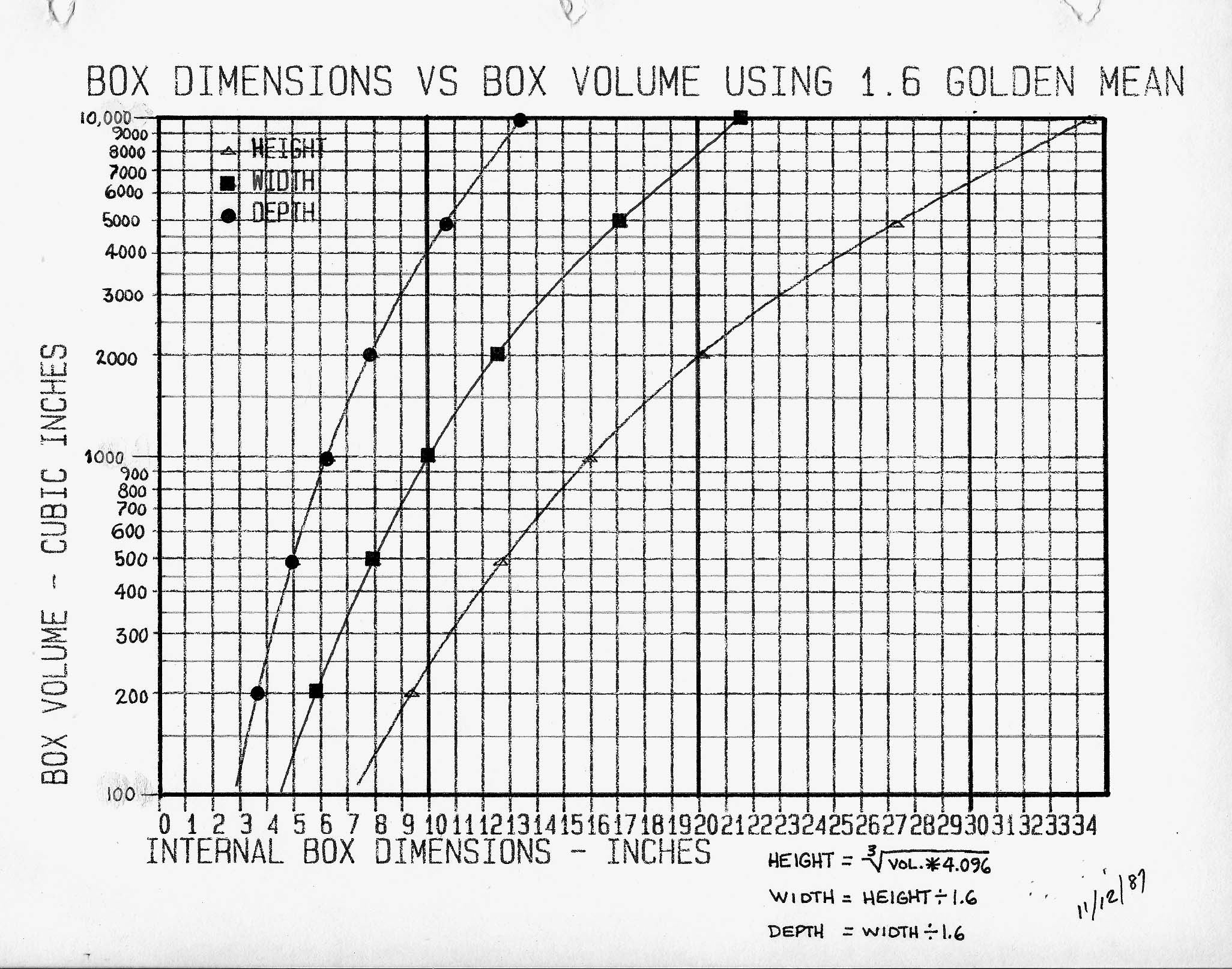

Attached is a chart I worked out many years ago. It shows plots of the depth (left one), width (center one) and height in inches vs box volume. It's based on the 0.62: 1: 1.62 golden mean ratio used by artists for centuries.
You just need to decide on what your box volume needs to be based on your driver's T/S parameters. You can use a free box calculator program available on the WWW. Just Google search.

Well certainly as you say a deeper cabinet (although an eyesore) would be better than the dimensions for this Pioneer B20 project.
It shows 9.75" wide and only 5.5" deep.
For an 8" woofer I would think that would be a problem (and even have some audible negatives?)
I'll copy that graph for future reference.
