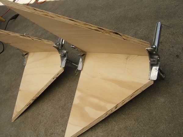

I'm doing a TB W3-1364-in-a-box and corner loading it to solve the BSC problem. A 4.8liter (internal) test box I did (just like Godzillas) put out to 100Hz free field!!
These are for the kitchen aimed at the stove (I make my own bass here
