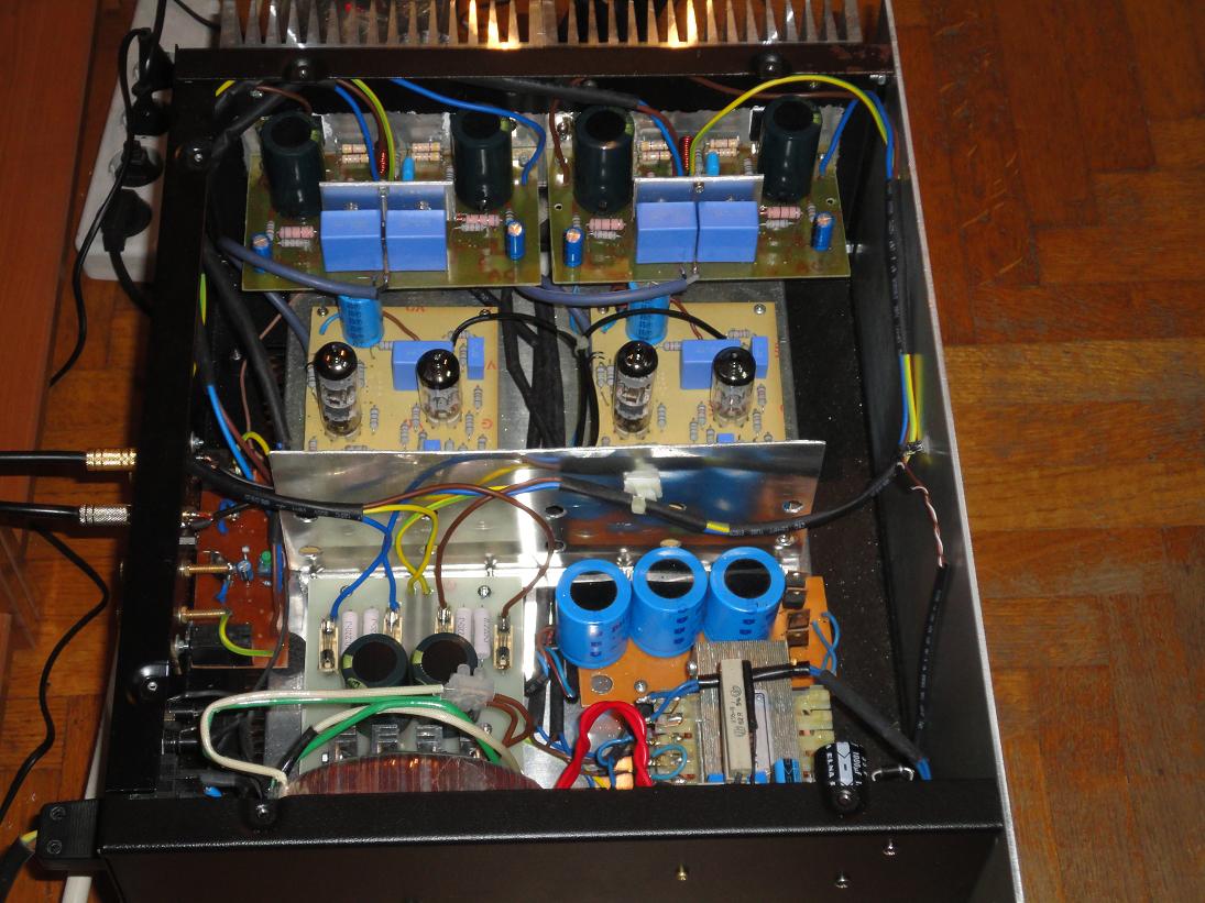

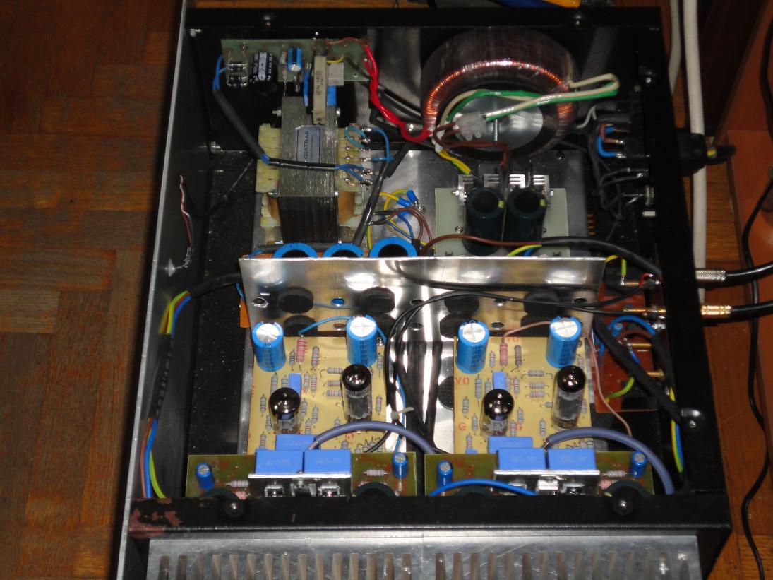

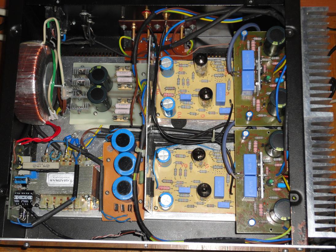

Hi to All , after a long time of experiments and troubles with different output topologies and different tube stages to drive the output stage , I finaly finish my new amp , it's a hybrid one , the first gain stage consists of one PCC85 in LTP configuration followed by a second gain stage which is the triode section of the PCL86 and the pentode section ( of PCL86 ) is the cathode follower to drive the output stage which is a class AB CFP ( Complementary Feedback Pair , also known as compound output stage ) with transistors 2SC5171 and 2SA1930 as drivers and IRFP140N - IRFP9140N mosfets as output devices .
As you see it is a very different amp from what I started to build and design in the begining , the new name of the amp is ROHH AMP , so goodbye Lunatic amp ( enough trouble with you ) and welcome ROHH AMP .
Here is some technical characteristics :
Closed loop GAIN = 27dB
NFB = -17dB
POWER : 2 * 65W at 8Ω load
2 * 98W at 4Ω
Output impedance = 66mΩ
DAMPING FACTOR = 122 at 8Ω
HIGH FREQUENCY RESPONSE 260KHZ ( -3dB )

Thanks Bigun , it sounds very good , detailed , clean and with good bass .Looks good Dimitris, tell us about the sound !
The reason is to keep as possible away the power transformers from the tubes ! .What's the reason to put the output/heatsink on one side of the chassis, instead of a more traditional layout - one on each side with the PS down the middle?
