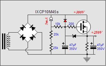

ErikdeBest,
I had some nice talks with Ari Polisois.
He published a 3* 6C33C-B on AudioXpress, and sent me
pictures of a 2*6C33C-B 2 weeks ago, same design.
The CCS's in the power supply are so simple.
take a look form what John Borskie of TubeCAD sent me...
A+
Alain.
