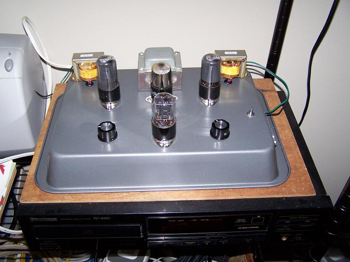

PS. love the "cake pan" amp

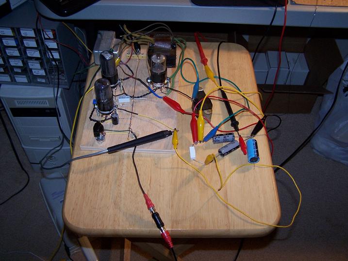

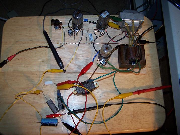

Hi John, yes thats it. It cant get any less expensive than this and still put out something worth listening to. Here are a few pictures of my project.
Thanks, Bruce. I was 'led astray' by the pics of the 'dual mono' version on the Boozhound webpage - double PTs, double chokes, etc....
