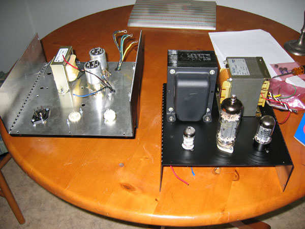

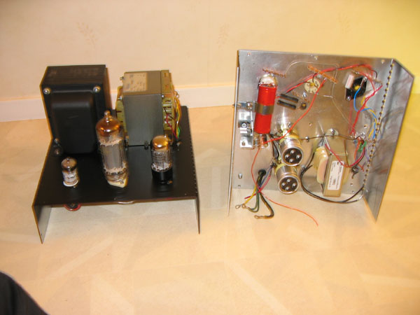

I made a prototype similar to circuit 1 in my drawing:
The amp worked quite well (except for some PSU issues that doesn´t belong here), actually good enough to be built properly.
Since the amp is DC-coupled it is sensitive to bias drift, that´s why I used a mu follower input stage.
Long after I made the proto the idea came that perhaps I can get rid of the 12B4 cathode follower if the top half of the input stage already is a cathode follower?
Half a 6SN7 wouldn´t be enough to feed the PL519 (10mA static current and 20mA peaks), but maybe a Mosfet or a high mu, high gm triode would? See drawings 2 and 3.
So, what do you think?
