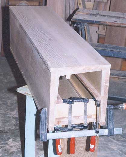

I chose to have the front and rear baffles overlay the side panels as the lumber has some real nice natural stain pattern that I wanted to wrap around the top of box. I started with a pair of 1x12x120” planks of vertical grain Douglas fir this became the sides and top. Another pair of 1x12x100” planks became the front and rear baffles. I squared up and planed the lumber, then cut ¾” MDF to the same width and laminated the MDF to the Fir with Tightbond 2 glue (you need a lot of clamps to do this). To reduce the working weight I then cut one of the 45’ inside angles for top corner joint on each cabinet. I left the top attached to one side panel to be cut latter. I then routed ¾” bracing channels into the side and rear pieces. I then rabbit cut the front and rear baffles to allow the MDF to be inset into the cabinet side panels.
So to summarize the side and top panels of each cabinet are from a single length of laminated fir and MDF with routed channels for bracing. The front and rear panels are the same yet the MDF has been rabbit cut so the MDF is inset by ¾” I did not put a vertical brace on the front panel (could be done).

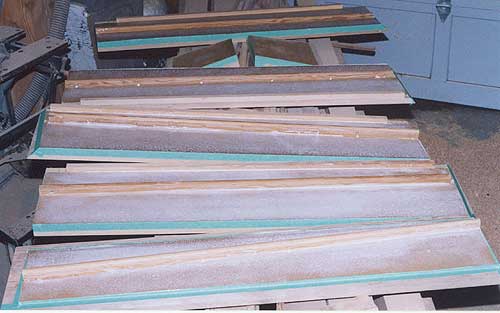

Next I made an angled sled for my thickness planer. I took a piece of ¾” MDF that the same width as the table of the planer and about 2 feet long finished it with varathane sanded to 300 grit and applied 4 coats of carnuba wax (to reduce friction). I put a 1”x3/4” runner lengthwise on the bottom side of the sled on one extreme edge. This created a ¾’ in 12” slope across the bed of the planer. I put stop feet on the bottom to keep the sled in place on the planer bed. I then ran the side/top and rear panels through the planer on the sled to remove the MDF side of the panels. I stopped planing when the MDF was ~ 1/8” on one side and not planed at all on the other side.

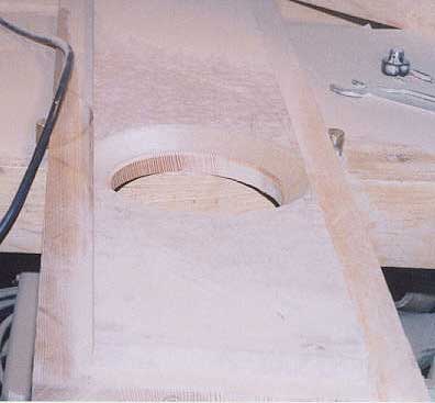

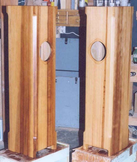

Next I completed the 45’ inside cut and removed the top from the side panels. I then glued and screwed the vertical bracing into the side and rear panels. Then I taped off the edges and painted on three coats of slightly thinned glue on the inside of all the pieces. ( I could have used epoxy resin but I did not want to open a new can for this small project. As the glue absorbs in it has a similar effect to stiffening and hardening the panel). Then I dry fit the entire cabinet to make sure I did not make any mistakes. Yeah! it fits together. Next drill out the holes for the binding posts and screw in cup hooks to hold a piece of grill clothe to act as a support for the dacron stuffing at the correct location. Then glue up the sides and be real careful to keep it square with grain wrapping around the top and sides. Drill and route out the front baffle to accept the driver. Flare the MDF to the inside and set the driver into the front baffle by 1/8”. Glue the front and rear baffles to the sides. Flip over the cabinets and glue in the port vent baffle. Route the edges flush and chamfer to reduce bulky appearance. Sand to 220 grit with a random orbital sander. Finish with three coats of Varathane natural oil sanding to 220 grit between coats, then three coats of Varathane Satin Urethane sanding to 320 between coats. Use a sprayer if you can, thin the first coat with ten % lacquer thinner to help finish penetrate and flow. Wire and install binding posts, put in grill cloth stuffing holder.
Next I had a couple of pieces of granite cut to the cabinet width and length plus a 1” shoulder all around and 1” thick. I drilled the bottom of the stone to accept a ¾” x 3/8” plug for a screw in leg. Then through drill 3/16” holes to allow anchoring screws to pull the cabinet and base together. Epoxy the plastic leg plug into the drilled holes. Finish the stone with three coats of Websheen (Xylene based concrete floor sealer, finish). Flip cabinets onto top put a bead of silicone on bottom of edge side panels and use 3” #8 screws to pull the base and cabinet together. Allow the silicone to ooze out and dry. Razor knife the excess silicone off after it dries. Flip the cabinets over and line driver inset with felt (real skinny piece, use silicone as the adhesive) Install the drivers.

Scott's speaker sans driver, more pics to follow....

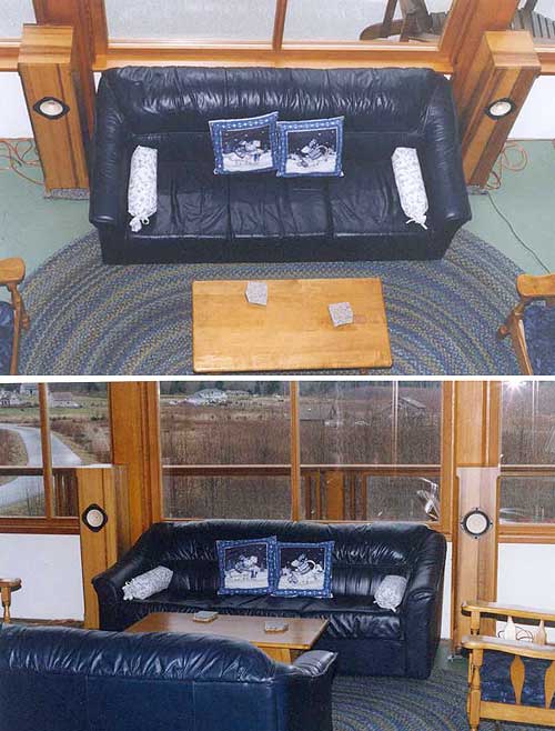

The column presentation is quite puposeful as it mirrors the design of my house. It really helped with the Wife Appreciation Factor. The cabinets seems to blend into the timbers on the window nicely.
