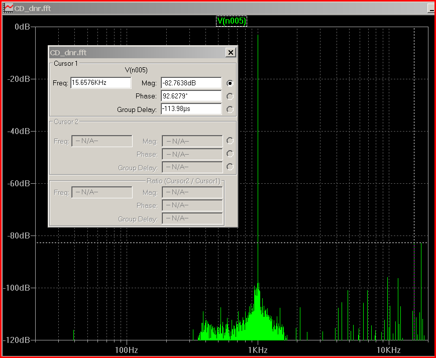

Yes, I only need the one frequency, 1KHz. It is for a tone test on induction loop equipment. We've tried using an MP3 player but the conversion from the test CD changes the tone so it is not an accurate reproduction of the 1KHz tone. I have used my iphone but I really don't want to lend that out, plus the output is not quite high enough before distortion kick in. My thought was to have a tone generator that could easily be recharged through USB. When it's charged, it could be taken to the site for test. I could be easy on myself and build a 9v tone generator, but what's the fun in that.

I'd be suprised if mp3 really botched a single sine
I didn't really believe it myself until I tried it.
But that is beside the point. I want to build a stand alone 1KHz sine wave generator powered from 3V
I don't see big problems -80 dB spurs are pretty good compared to what a "simple" analog sine oscillator will do
no way you're going to get the narrow linewidth even a poor xtal in a cheap DAP will give
I created a 1 kHz sine in Ltspice - exported with the .wave function
used foobar2000, lame 3.99.2, encoded as mp3 v2,
reconconverted to .wav - back in to Ltspice
below is a 1048576 point fft of 10 seconds 1kHz sine > 16/44.1 .wav > mp3 v2 > .wav
