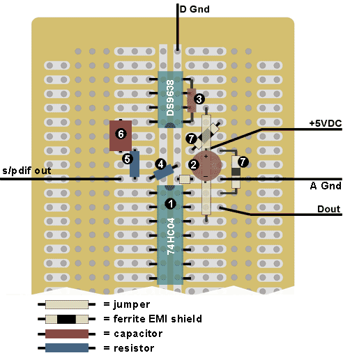

AudioNewb said:Okay, then, we're off and rolling! Here's the final parts list in case anybody else is interested:
1. Mouser part #: 575-413314
110-13-314-41-801000
Mill-Max Capacitor Sockets
14P GLD PIN GLD CONT
2. Mouser part #: 647-UHE1H560MED
UHE1H560MED
Nichicon Low Impedance Aluminum Electrolytic Capacitors - 105 Degree
50V 56uF 6.3X11
3. Mouser part #: 80-C412C104J5R
C412C104J5R5CA
Kemet Conformally Coated Axial Ceramic Capacitors
50V X7R .1uF 5%
4. Mouser part #: 271-97.6
271-97.6
Xicon 1/4W 1% Metal Film Resistors
1/4WATT 97.6OHMS 1% 50PPM
5. Mouser part #: 271-330
271-330
1/4WATT 330OHMS 1% 50PPM
6. Mouser part #: 505-MKP20.1/100/5
MKP2-.1/100/5
Wima Polypropylene Film Capacitors
100V .1uF 5%
7. Mouser part #: 623-2743001112LF
2743001112
Fair-Rite EMI Shield Beads on Leads
LF Z=68 OHM @ 100MHz
Mouser part #: 511-74VHC04B
74VHC04B
ST 5V Logic (HCF4xxx, M74HC/HCT, 74AC/ACT, 74VHC/VHCT)
DIP-14 Hex Inverter
Digikey part #: DS9638CN-ND
DS9638CN
IC DRIVER DUAL HS DIFF 8-DIP
Radio Shack part #: 276-150
Multipurpose PC Board
All the parts to build two of these things should be well under $20. I'll post a photo when I'm done!
Finally got around to building the thing. I don't have it hooked up yet, but I had completely neglected the actual size of the components in my original diagram, and that threw me off a bit. Might have been easier to use regular protoboard instead of the the stuff with all the traces I'm using (what I had laying around).
New diagram is attached...hopefully I'll get music running through it sometime over the long weekend!
