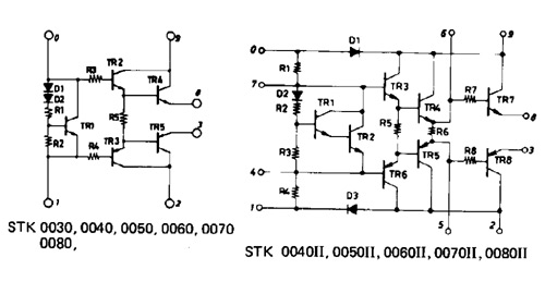

I found this info in an old pdf data sheet.
STK0040 is described as Single Channel Complementary Darlington Power pack.
Specs are: Supply volts max +-48V
Collector Current max 5A
Supply volts at rated output into 8ohms +-33V
Output power at 8ohms 33W min
Don't have any application circuits - equivalent internal circuit is shown below.
Hope this helps some
