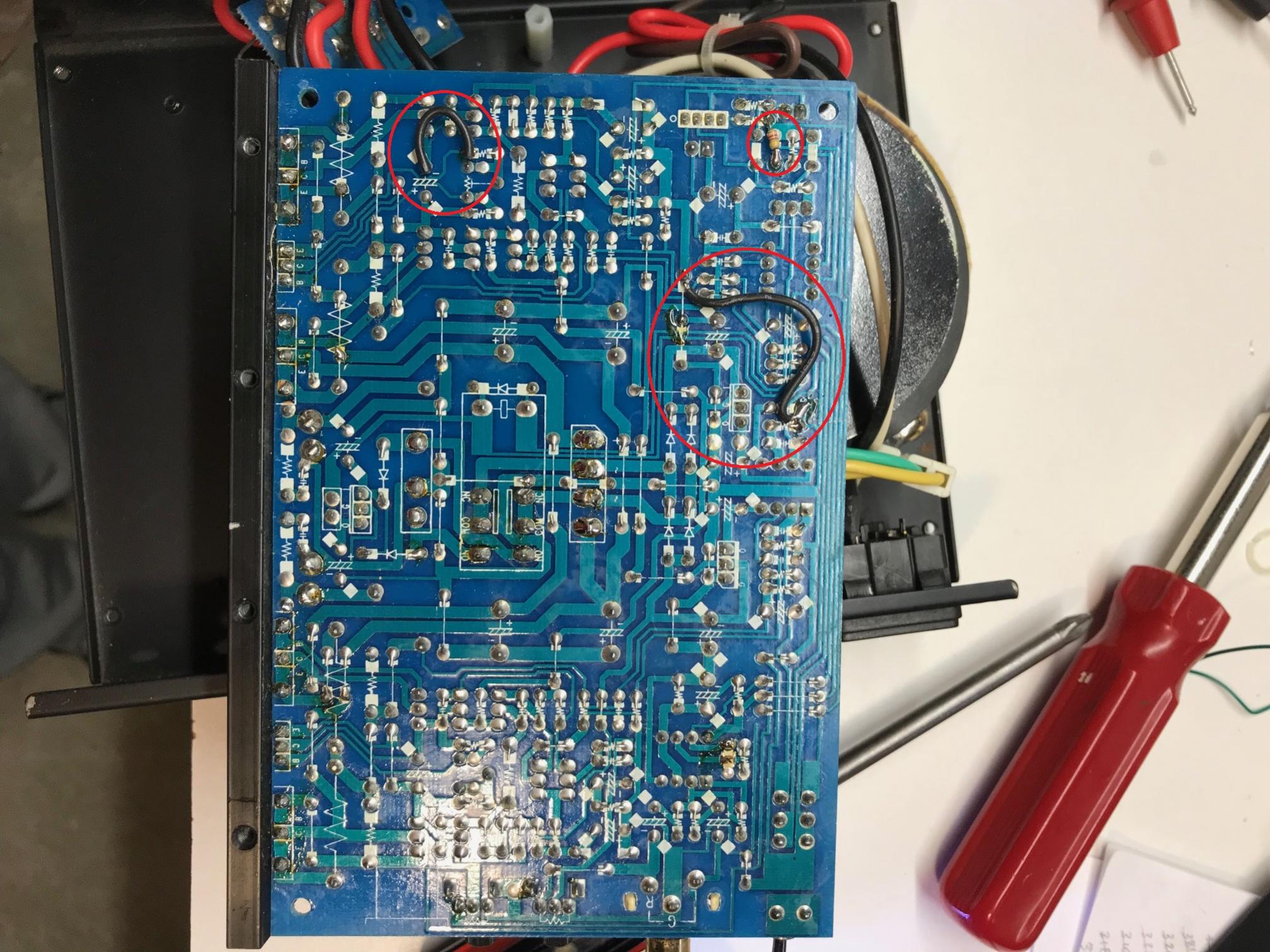

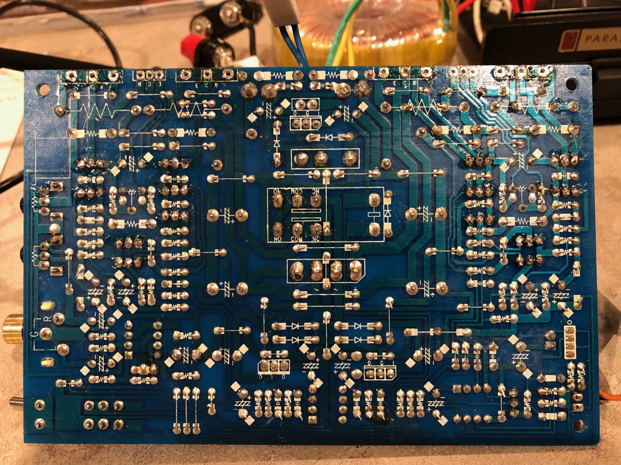

Here is a pic of the bottom of mine - curious if yours has these 2 wires and small resistor. Mine looks like a DIY add, so I have taken them all out (didn't help or change my issue)
I had one leg of the "shorted" channels big pink resistor that was un-soldered from the board. Not sure if it was heat or poor soldering, no marks on the board and the solder was fractured, not melted.
The bad output was on the left channel as was this resistor. When I changed everything the left channel is OK (not perfect) but the right channel now has full voltage on the outputs.

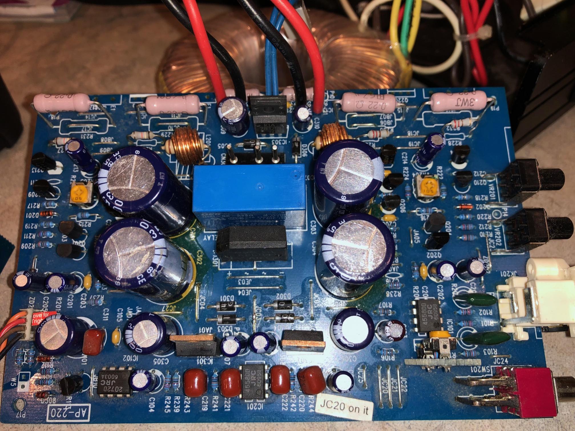

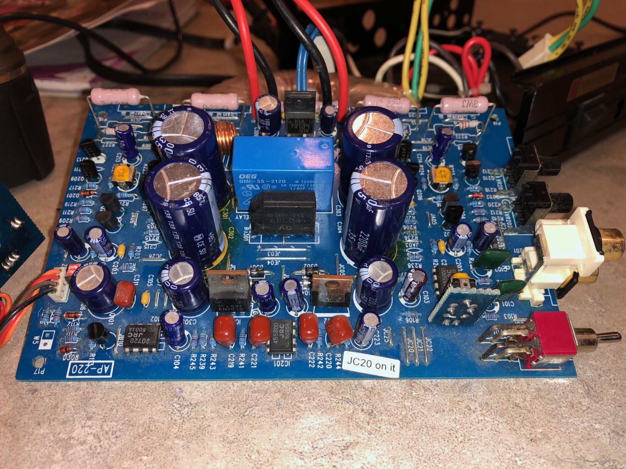

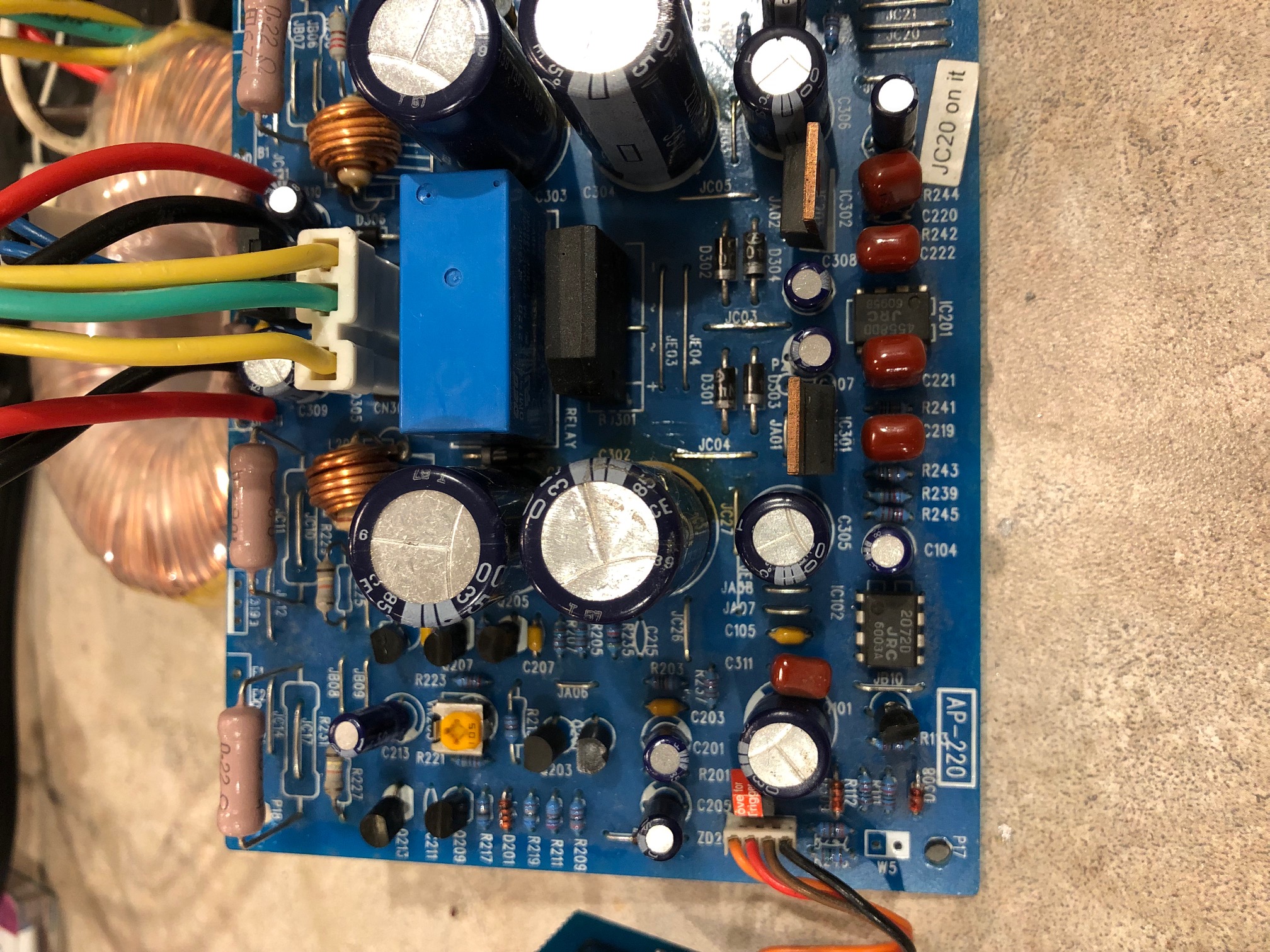

Thought I would post here first to see if there are any responses.
I recently moved so I pulled this back out of the closet to see if I can get this running for an office system. Original issue - with a DBT the relay would click in and out every 1/2 second. I tried with 25, 40 and 60w bulbs and the only difference is the speed of the clicking and with a 60w bulb the power transistors would start to heat up.
First thing I did was pull all transistors and test with a DMM and a transistor tester (from eBay) and only found one bad small signal transistor and replaced it with a suitable replacement (c639, with a leg-adj., reversed C2240) for now and will get a correct one once it is back running.
I put all the small-signal transistors back in the PCB, but left out the driver/power transistors to do some testing.
Current issue is -
Left channel 220r resistors (R225/R227) in-front of 0.22r emitter resistors are getting quite hot - small amount of smoke with a 60w bulb in the DBT.
I took some voltage readings and show ~30vDC on those resistors.
The other interesting thing is that I get ~28vDC on the Collector and 24vDC on the Emitter of the power transistors, but when the relays clicks out of circuit (takes 5-6 minutes with the drivers/power Transistors removed) I get -5vAC on the Base and Emitter, but still have 24vDC on the Collector. Not sure what that tells me/you if anything.
If AC is getting through, does that mean a Capacitor is bad? They look OK, no bulging or leaking, but I haven't tested them out of circuit.
I don't have, and cannot find a schematic - so I'm a little lost on verifying resistor values and mainly checked for reasonableness and that none were OL, and I have not found any that seem out of spec.
Included a few pictures in hopes that will assist. Thanks.
