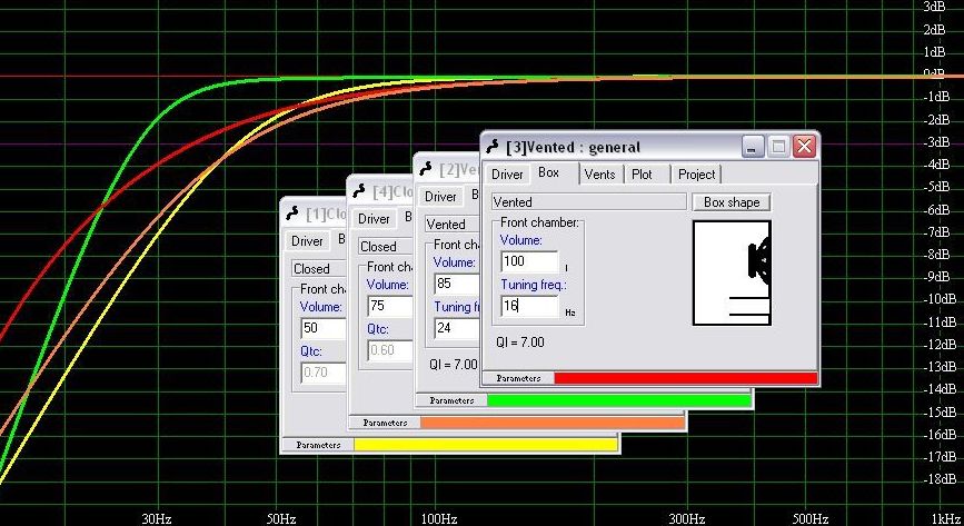

Attached is some simple modelling of the Scanspeak.
The shown "room friendly" vented alignment is somewhat impractical
IMO requiring a very low vent frequency and a big box for a 10".
A half the size sealed box seems more practical.
Sealed versus vented there is no simple answer IMO.
The two vented alignments shown will sound very different (albeit
my experience with such alignments are at higher vent frequencies).

WinISDbeta
As I said "simple modelling" so Vbox is the effective box volume.
I understand "full stuffing" can increase box volume by up to 40%,
(depending on what you read / tests you peruse, I'm not sure)
so 35L fully stuffed can be <=> 50L.
WinISDbeta is quick and simple but very limited, it simply
saves doing the basic maths, I just plug in Vas, Fs and Qts.
The basic maths for Vas, Fs and Qts indicate that to bring
up Qts from 0.3 to 0.7 you need ~ 50L, and this brings up
Fs 18Hz to Fbox ~ 45Hz, as it is Q = ~ 0.7 Fbox = ~ F-3dB.
I'm not familiar with all of what Unibox takes into account but
no doubt it is far more accurate that WinISDbeta for real boxes.
http://www.rjbaudio.com/Audiofiles/FRDtools.html
States Unibox is the best free box simulator.
I also use WinISDProAlpha which is more advanced than Beta.
Its friendly to use but again I do trust it completely, but the
quick power handling / excursion modelling is useful.
Also useful is the quick (incomplete) modelling of additional
active EQ for vented 6th order alignments, sealed 4th order.
/sreten.

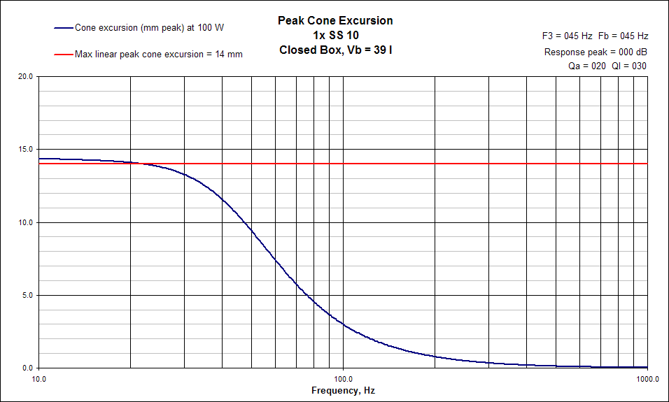

Attached below is a unibox cone excursion sim of the Scan-Speak unit. It hits its Xmax of 14mm at ~80W <30Hz.
My amp will drive a 4-ohm driver to 200W.
Would that be considered excessive?
Glen

G.Kleinschmidt said:
Anyway, a quick Q:
It hits its Xmax of 14mm at ~ 80W <30Hz.
Glen
Is is the 200W power excessive ?
In a high passed subwoofer application the general argument
is that amplifier power and linear Xmax should be moreorless
equal, if the power is lower you get cleaner bass, but if it is
higher you get more headroom higher up where the driver
is power handling limited rather than excursion limited.
For HT one could argue power = the excursion limit, for
music one could argue for more headroom higher up.
However I presume we are not talking high passed subwoofers.
That is : the amplifier is producing the voltage swings for
the whole frequency range, not just the high passed bass.
In this case excursion limiting at ~ 40% of the amplifiers
maximum power is more than adequate for music.
How much more than adequate it is can be argued about
but the reality is AFAIK 1/10 to 1/4 is more than enough in
(1/10 = classical, acoustic stuff etc, 1/4 = bass heavy)
nearly all cases otherwise normal domestic speakers would
always be overloading in the bass when given some juice.
(Has to be said cheap speakers do overload in the bass)
Or put it another way, a speaker than can handle say 200W music
program (400W peaks with mild clipping) and handle a minimum
of 50W rms at any bass frequency would be regarded as having
outstanding bass power handling.
If this is allied to very good bass extension (which as you go
lower reduces power handling) then you are in the realms of
outstanding bass full stop.
If set at 1/2.5 < 30Hz this is well into the comfort zone,
so no, the 200W amplifier capability is not excessive.
In reality at the amplifiers maximum clipping limited
volume with nearly all music it will never be exercised.
/sreten.

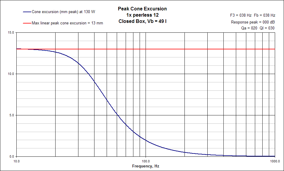

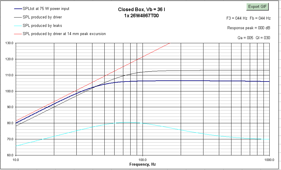

Hi blue,
I learned how to use Unibox properly and that has been a real bonus for this kind of modeling.
Before, I worked out box volume and alignment by formula and used different calculators but this was either tedious and time consuming or just plain inaccurate.
A few years ago, I had a 12" Max Pentivent speaker that I used in a sonosub, The calculator that I used at the time lead me to expect that a 350 litre vented box was right.
Short from a long story is that the Pentivent was running out of excursion in that box at less than 25 watts! I found this out by modeling it in Unibox, long after I pulled the Pentivent out and burned the sonosub out in my back yard.
You can't judge how a driver will behave by power rating. It needs to be properly modeled and simulated. Unibox has not let me down - everything I model has worked exactly as predicted.
i persume the excursion graph in winisd or bassbox that i use are similar to what you are saying about unibox. my problem is knowing how much power to apply to the graph. does my 240w plate amp need 240w applied to the graph ,or, since i will never have my amp at max, should i use 50% or 75% or?
i guess i am asking do i model for max power or normal listening levels?
blue934
blue934
I model max power.

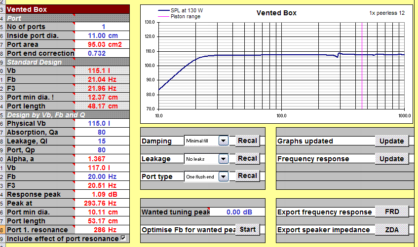

A lot of what you are saying was mentioned above in sreten's post. I don't do it that way.
For me, there is no "normal" listening level. I like to crank it more often than most and I don't want my drivers struggling with the load.
You need to decide what you want out of the design - what will be the spl at the power level you think you won't exceed? To get an acceptable level at low frequency requires power, therefore power handling ability.
In my post #33, the projected frequency response has the speaker (driver and port) producing 104db at 20Hz at 130 watts. This is within the drivers linear excursion limit.
Is this enough or is more output needed? If your amp is only able to produce 100 watts, you don't need to worry that your driver is distorting from over excursion.
