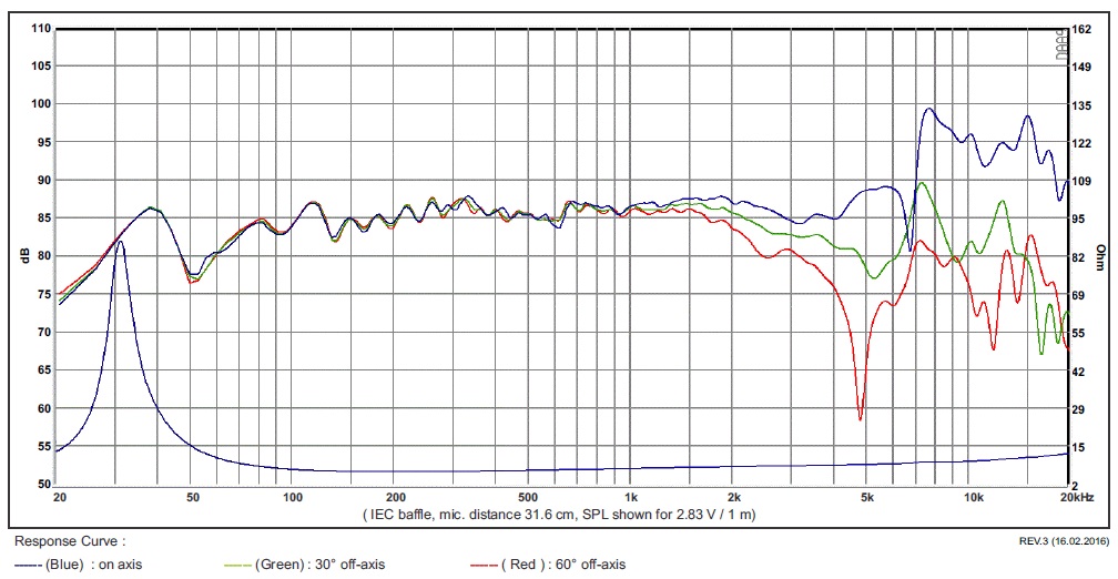

Yeah ... I like to grab things at the lighter end.... Right now (on a request from a friend, who already bought those despite my warning) I try to tame THESE to work with an SB 26STAC.

Easy you think? Try to get rid of the crap between 7 and 15k with a simple notch....ain't working, with two filters it goes dead, looses all impact...
No notch required, just toe that thing in and enjoy...

And yes, they are crawling through without the notches, and ruining all the top octaves

Right, I just attached the FR graph, but forgot to tell, it is the SB17 NAC series alu cone miracle... Which is an almost perfect driver, at least up to about 3 kHz.
The rest is crap . (mostly)

That's like saying "my week only consists of sundays". Or "I only drive the straights, I just leave out the bends".
Like I said, you can't just magical wish the other angle responses away. It's probably new to you but even these add up to the tonal balance - because you've got also reflections in the room! Ofcourse that can be neglected if you've got an infinitely big room (without floor) or perfect absorption. You really never heard about the energy balance? (don't know if that's the correct term, 'Energiebilanz' in German) There is actually an energy balance in the room, if you've really never heard about that, now here's the ideal time and reason to start learning something new. Ignoring physics doesn't make them go away. Really.
