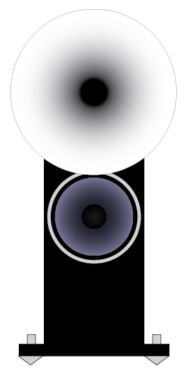

Here's an idea, mount it on a OB and add a sealed 12" woofer and cross actively at 300Hz
It will be mounted in a sealed enclosure with a JMLC 400hz horn crossed line level at 500hz over to a pair of Seas A26RE4, also sealed At the moment they are playing naked without a baffle.

BTW, I thought for a while, with the SEAS woofer, you can make a Quad ESL style OB with simple cap and inductor first order crossover!

The woofer will be active with a plate amp, and the SS driver will be crossed passive line level with a single cap to deal with horn loading.
