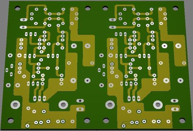

Top side
\Jens

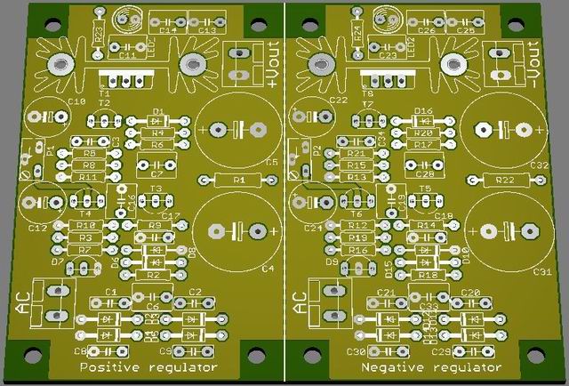

Jens, an idea :idea: not so smart now when you have put so much work into it... but... Why don't you make the pcb with a mirrored negative regulator so that the ground can be shared at the output? You can still make the pcb detachable. If you check my JSR06 PSU you can see what I mean. The advantage would be a true +-15 V PSU and in the same time to single boards.
Notice that the groundplane is divided in sections.
One more option would be having extra resistors for the feedback. Sometimes it's very easy just to solder one resistor in parallel to trim the voltage.
Per,
I don't see the point in mirroring the layout, when I have two identical sections providing a positive and negative supply. I like mirrored layouts, but only when there is a need for it due to mechanical considerations or signal flow. The layout is as close to identical as possible as I have used complementary parts everywhere possible / needed.
The gnd plane can be separated – no problem - I just thinks its going to be a forum decision so that most people will be happy with the choices made.
I added a multi turn trimmer to make adjustment easier.
An idea could be to piggybag the positive and negative supply to save space.
\Jens
