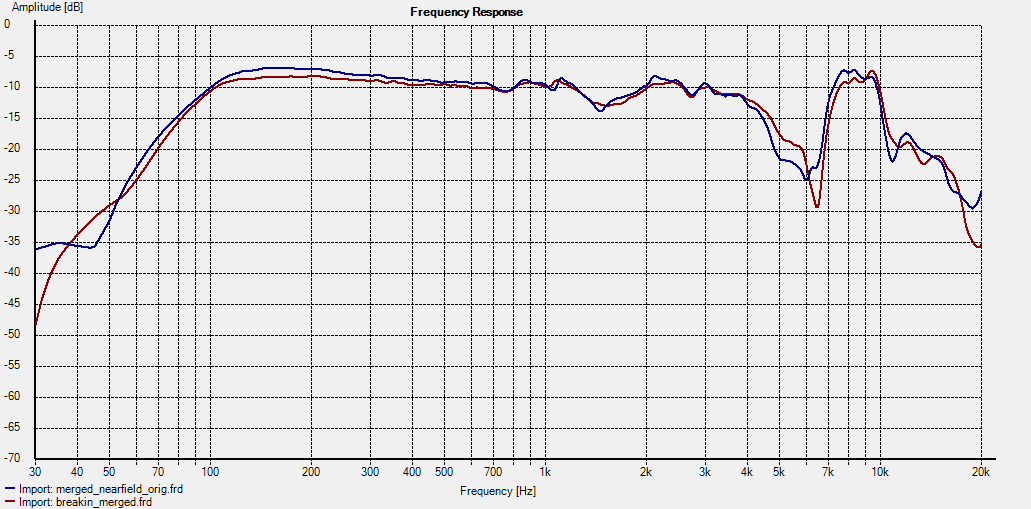

yeah it really bugs me when things don't turn out like I expected :) I did about 30 minutes of 30Hz this evening and then did the nearfield measurement again (with the 70Hz tuning). It flattened out the response somewhat. Still not going as far as the sim, but definitely better :) I might leave it running over night with some lowish level 20Hz.
Note that the upper frequencies are more likely affected by a change in the foam, as I kinda ruined the first bit when I stuffed it in the port to try sealed ;) this measurement is with what is left of that foam sitting in the top of the box with none on the rear. It did only affect after about 1K before so I don't think it will be changing anything down low.

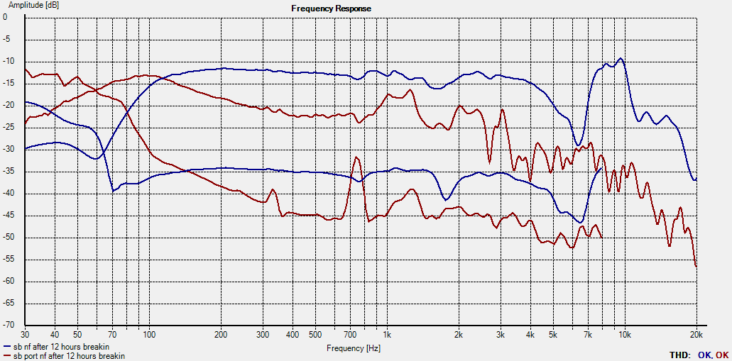

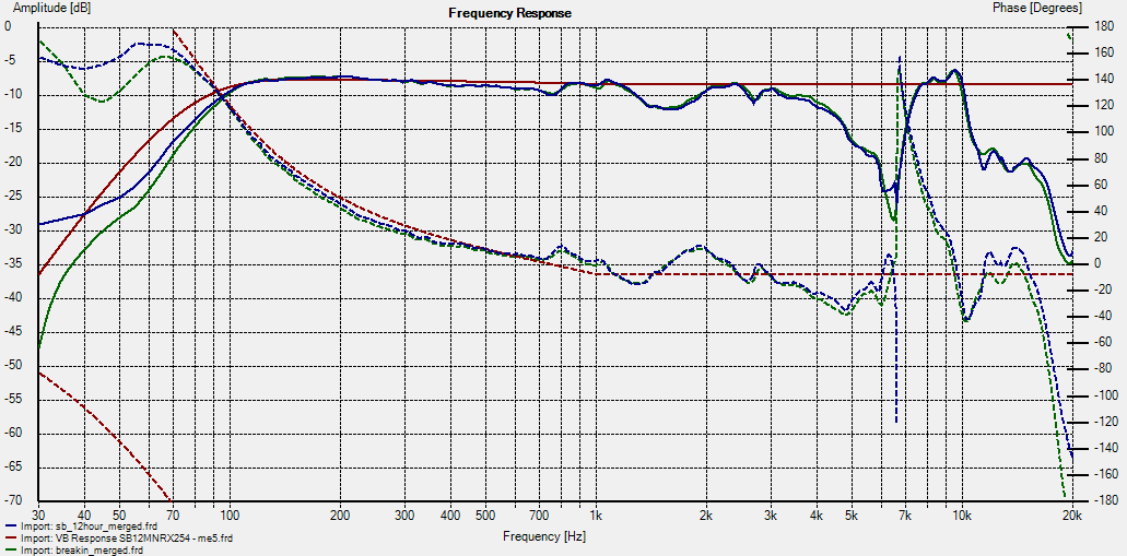

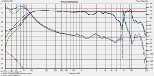

After running for 12 hours there is a slight improvement in low end response compared to last night. Blue trace is this mornings measurement. Apart from below 100Hz it is matching the sim pretty well now. I might leave it running 20Hz for a bit longer.
note I also change the sweep to start at 20Hz this morning. Last nights measurement had the sweep starting at 40Hz.
Second pic shows THD of the NF woofer and port measurements. I find it interesting that the THD on the driver is very flat above the box tuning frequency, but the port shows big variations... all have 1/16 octave smoothing.

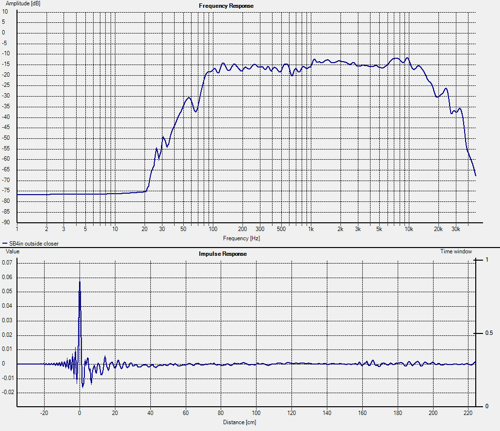

Although I haven't really progressed on this, I thought I would upload a measurement I did of the (still clamped together) box, on Easter Monday.
The measurement was taken outside off my Verandah pointing into the yard, giving quite a bit more usable distance before reflections.
Attached is a 1/8th octave smoothed response curve. All in all it looks pretty good to me. I decided on 1/8th smoothing because gated I can only get down to about 200Hz. It is interesting comparing it to the measurements above.
I think that with a broad notch (assuming I can develop one) between 5 and 10K it should smooth out quite nicely.
All I have to do now is get off my backside, glue in the braces, and glue on the back panel. Oh and make the second one :rolleyes: It's looking like this is going to hit the one year mark soon if I don't get moving.....

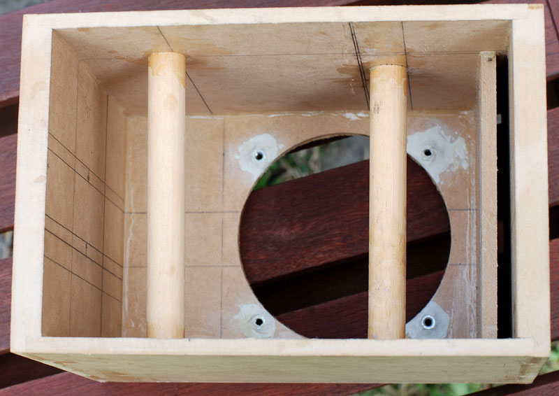

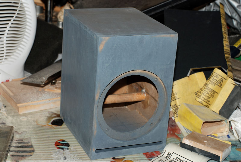

For completeness some progress photos ;)
Note the extremely wonky installation of braces. I'm sure being slightly staggered improves things :p I was quite surprised at how effective they are actually.
Also note the extremely dodgy sanding of the primer. Superb finish these will not have ;)

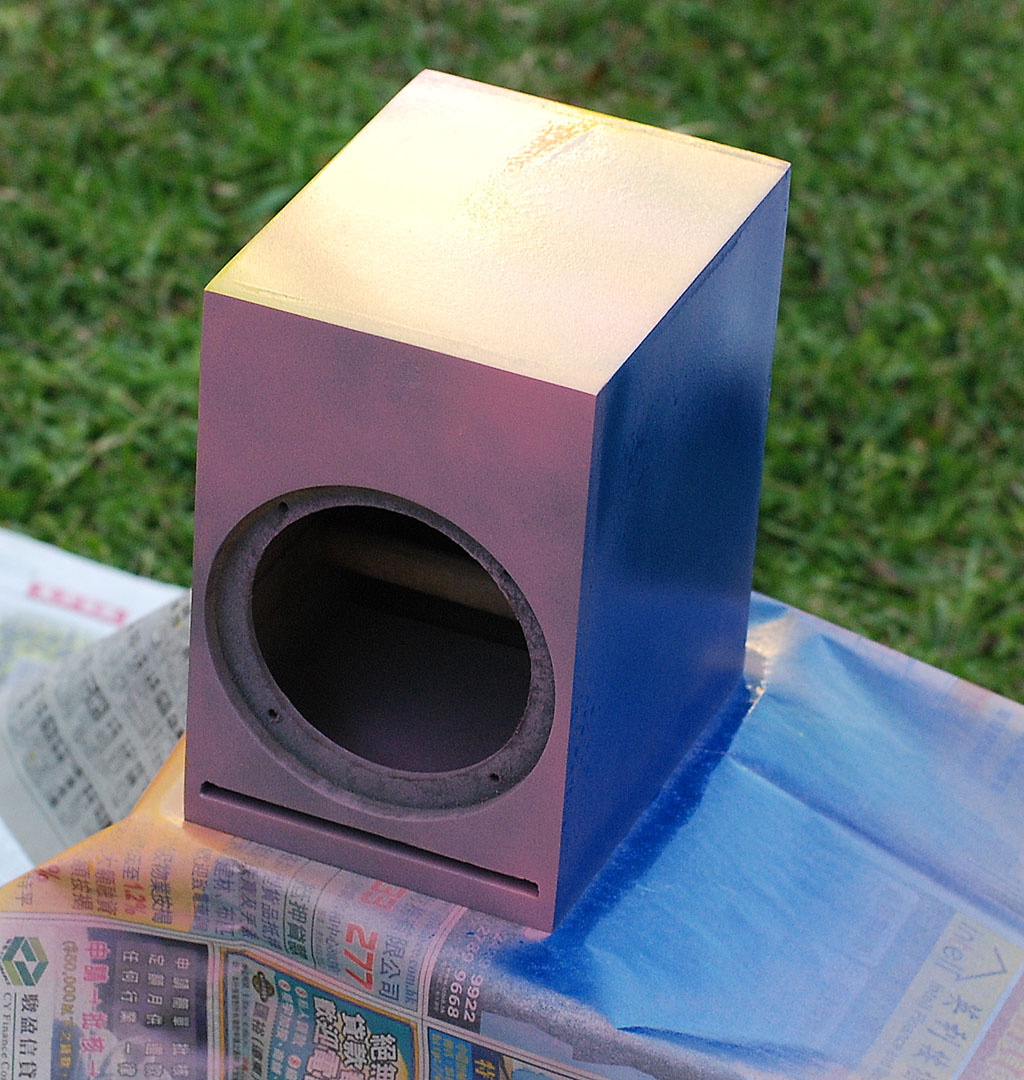

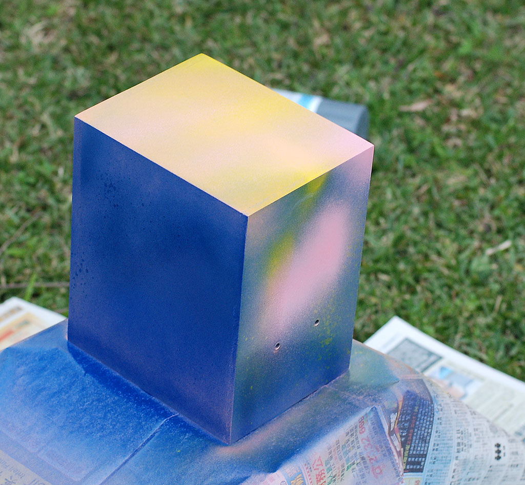

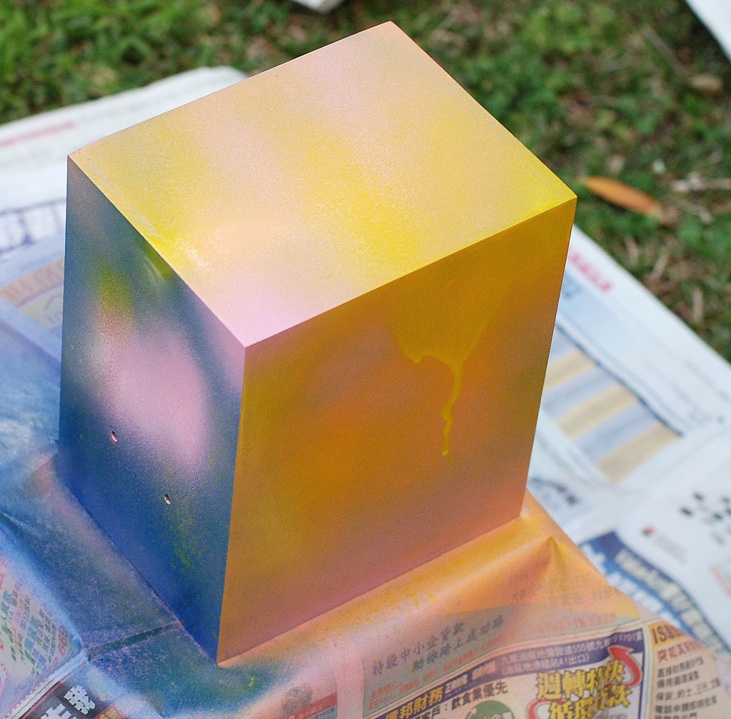

just another photo update ;) I came home early yesterday and my 5 1/2 YO and I set up the speaker in the back yard and she sprayed it to her satisfaction :D
There is a large run on one side where she got a bit over zealous with the yellow, but it adds texture ;)
Overall I think it looks pretty funky.
Tony.

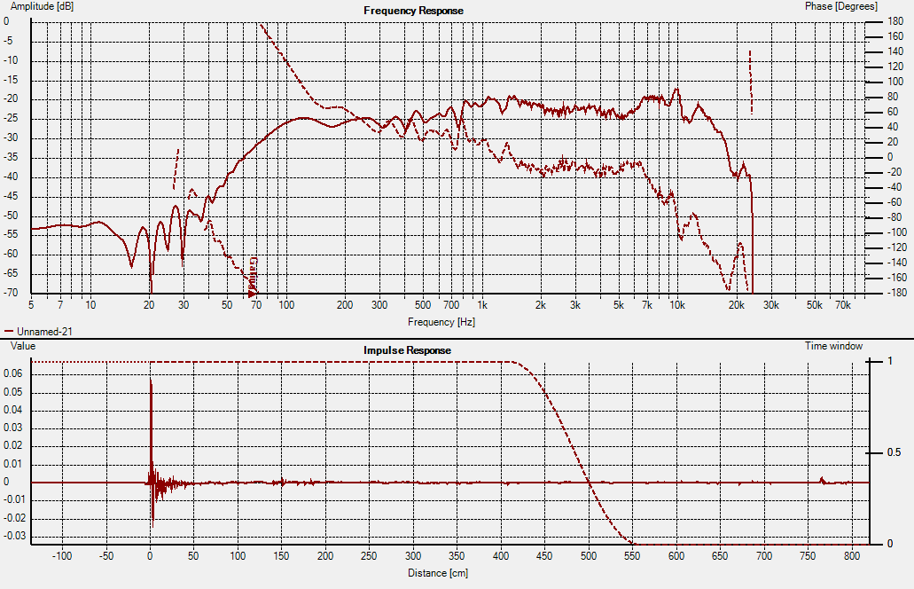

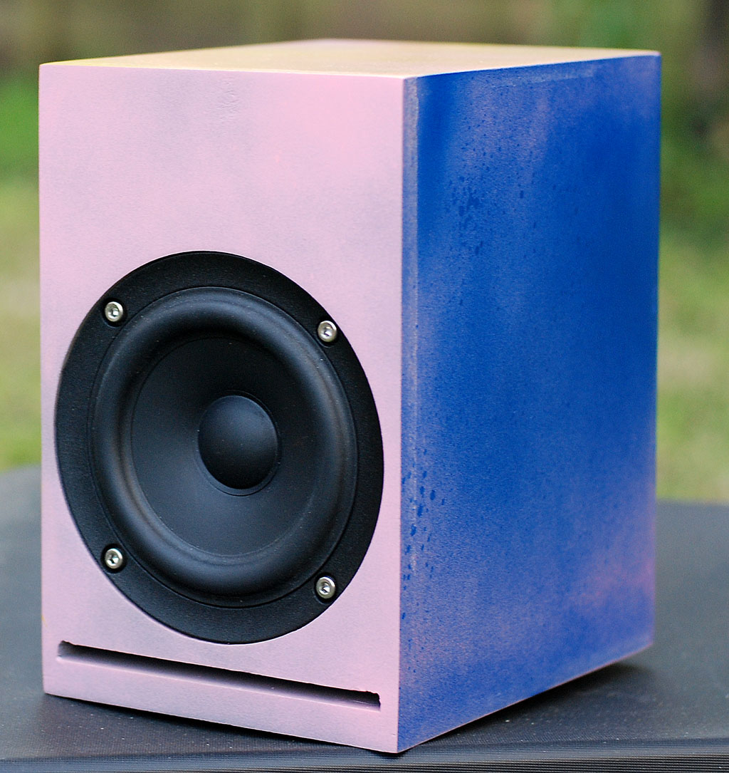

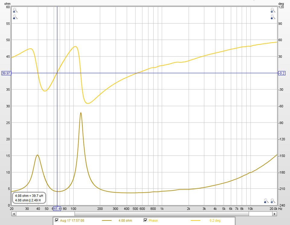

Latest pics and impedance measurement.
Tony.

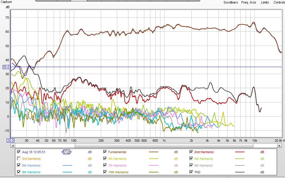

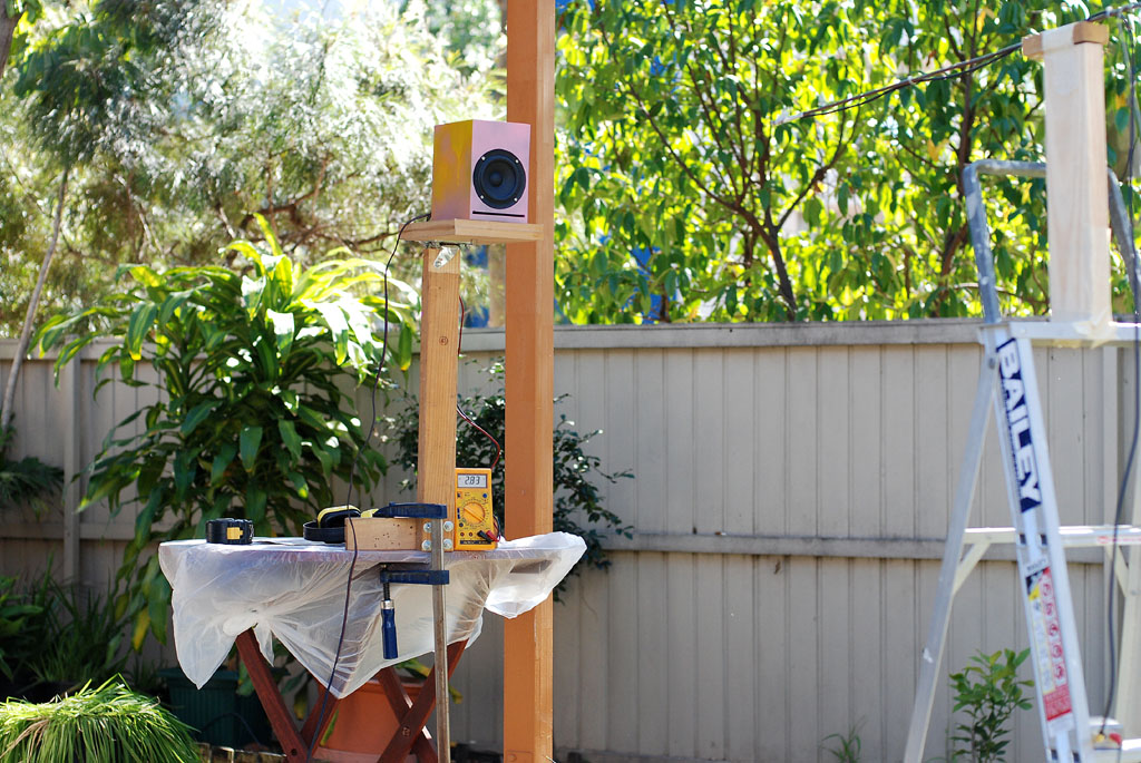

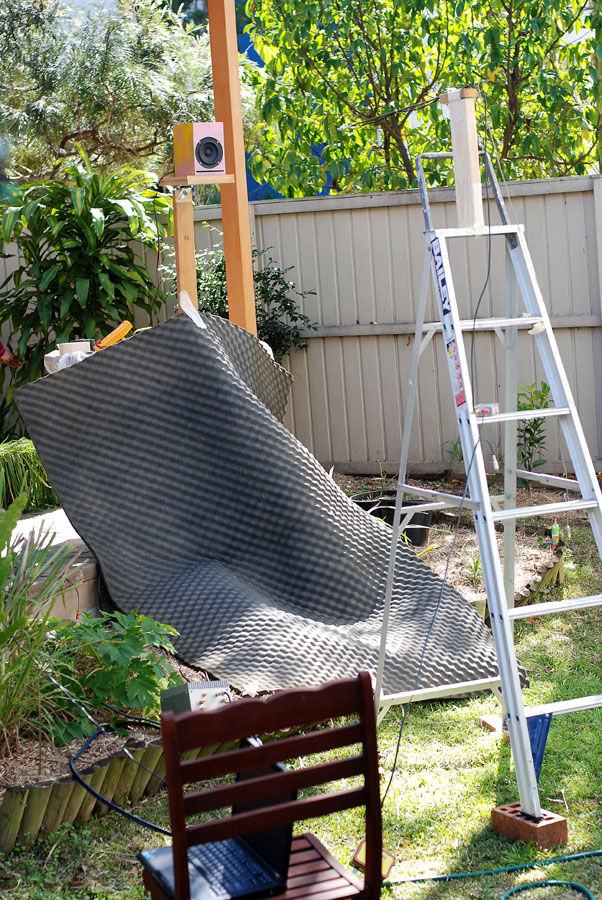

OK here is a measurement taken outdoors with REW showing SPL and distortion. Measurememt taken at 2.83V however not properly calibrated to give accurate spl level. It should be around 88db I think.
It wasn't ideal for measurements today as it is a bit windy, but not too bad just the same. edit: just added some pics of the test setup. The speaker is on a table on the verhandah, I think that the minor reflections in the impulse are probably from the roof above, I'll have to try some experiments out in the yard as well, but it is rather narrow with another house's wall down one side so I tried to position at an angle to any major reflective surfaces.
Tony.
