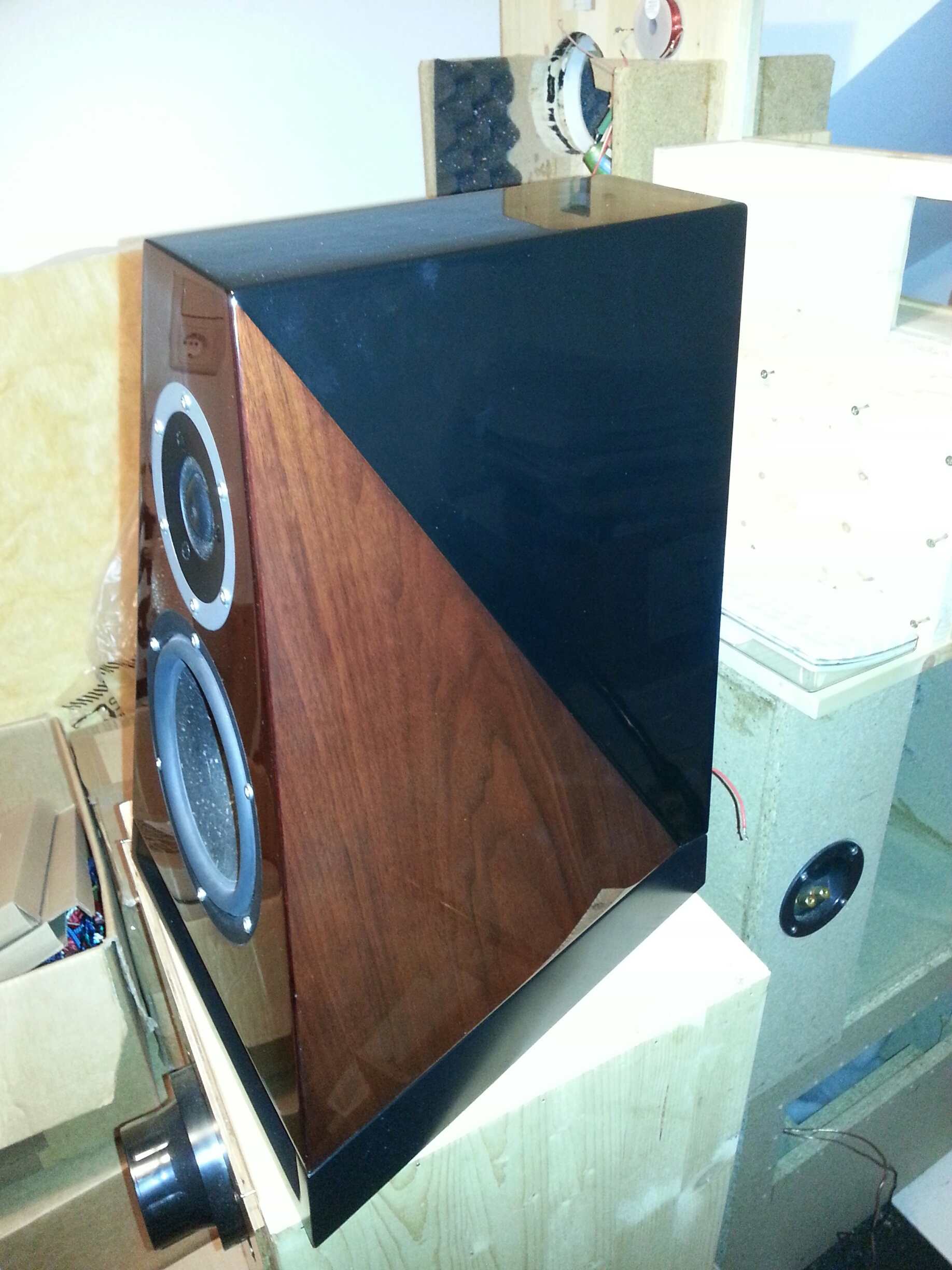

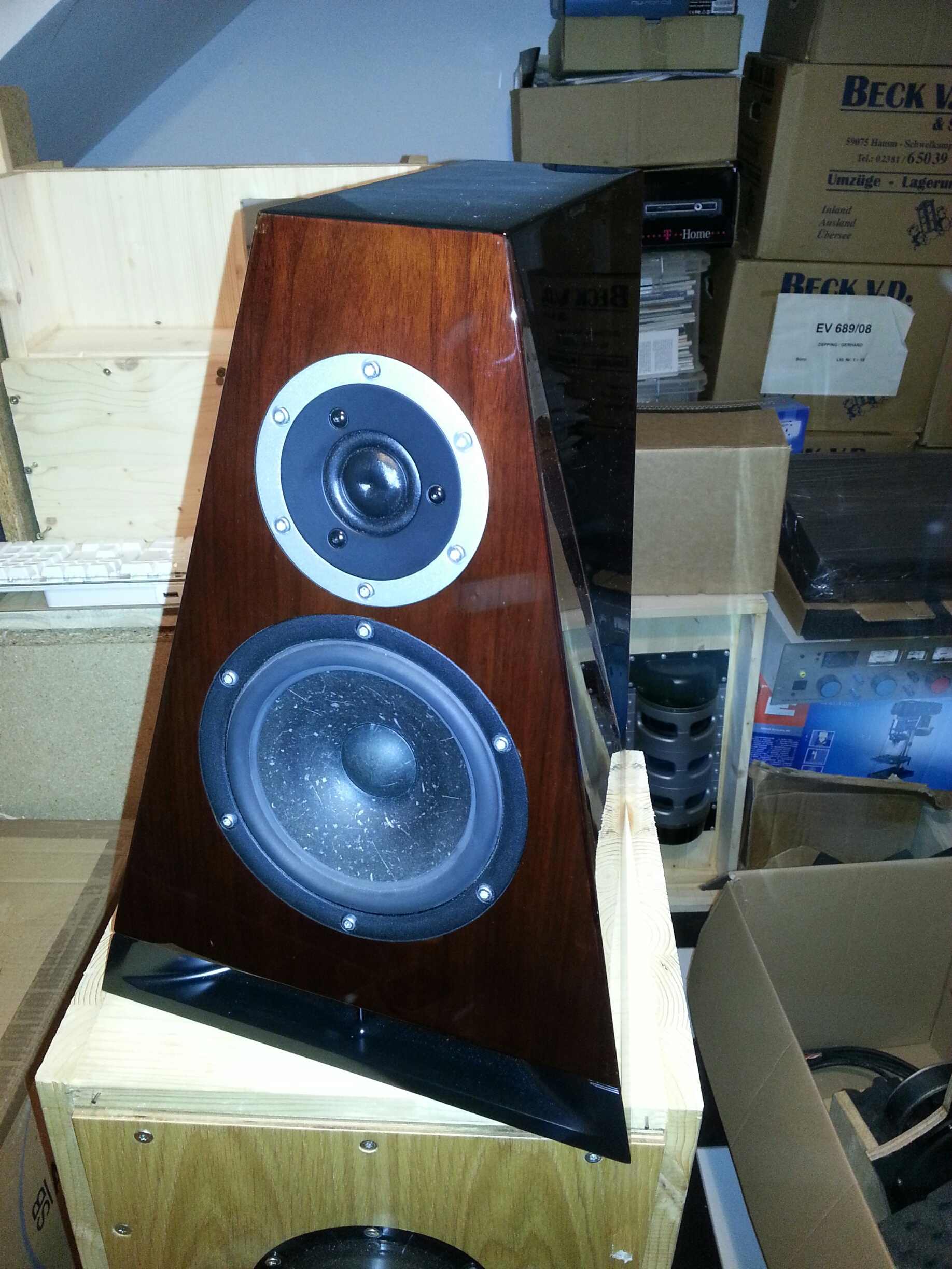

Here is the pair i sell.
Sorry for the poor photos.
My son has taken them with his cell phone.
They have collected some fingerprints that can be wiped of.
They are like new otherwise.
The drivers are mounted and the wires come out in the back.
There is no crossover but i will include a schematic.

Awesome, but what will be price shipped to USA ? LoL
How ever, if you don't mind sharing design PM me, i am sure i can build them ... But - if answer is NO, i understand
Sorry, i can not give out the CNC data for this cabinet.
I got payed by SB to design it with Michael Böresen so they own the design.
What price are you thinking about ?

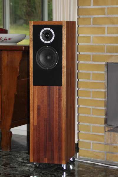

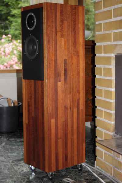

I have recently finished a set of Satori speakers - inspired by among others this thread. I ended up building them in a floorstanding version due to design issues (wife). The top section is 22 liters sealed. I am pleased with the sound which is very detailed and extremely dynamic.
I call the speakers SB Satori PDX. The PDX is for PC Digital XO. After finshing the cabinets, measurements decided the correct delay between speaker units, fase was linearized for each unit and frequency corrected to the desired response. This is all software settings in in the PC XO. The music signal is routed to a multichannel DAC, feeding power amplifiers in an active system. So each speaker unit has a separate signal path all the way from the PC.
The room in the lower part of the speaker cabinet is 27 liter, and this now allows me to build in bass units to relieve my old subwoofer from duty. Speaker units considered are the 10" SB29SWNRX-S75-6. As an alternative 2 Monacor SPH-225C could substitute one 10" unit. I have never heard the Monacor units, but rumours say they provide a very deep and detailed bass.
Any suggestions or comments are welcome.
