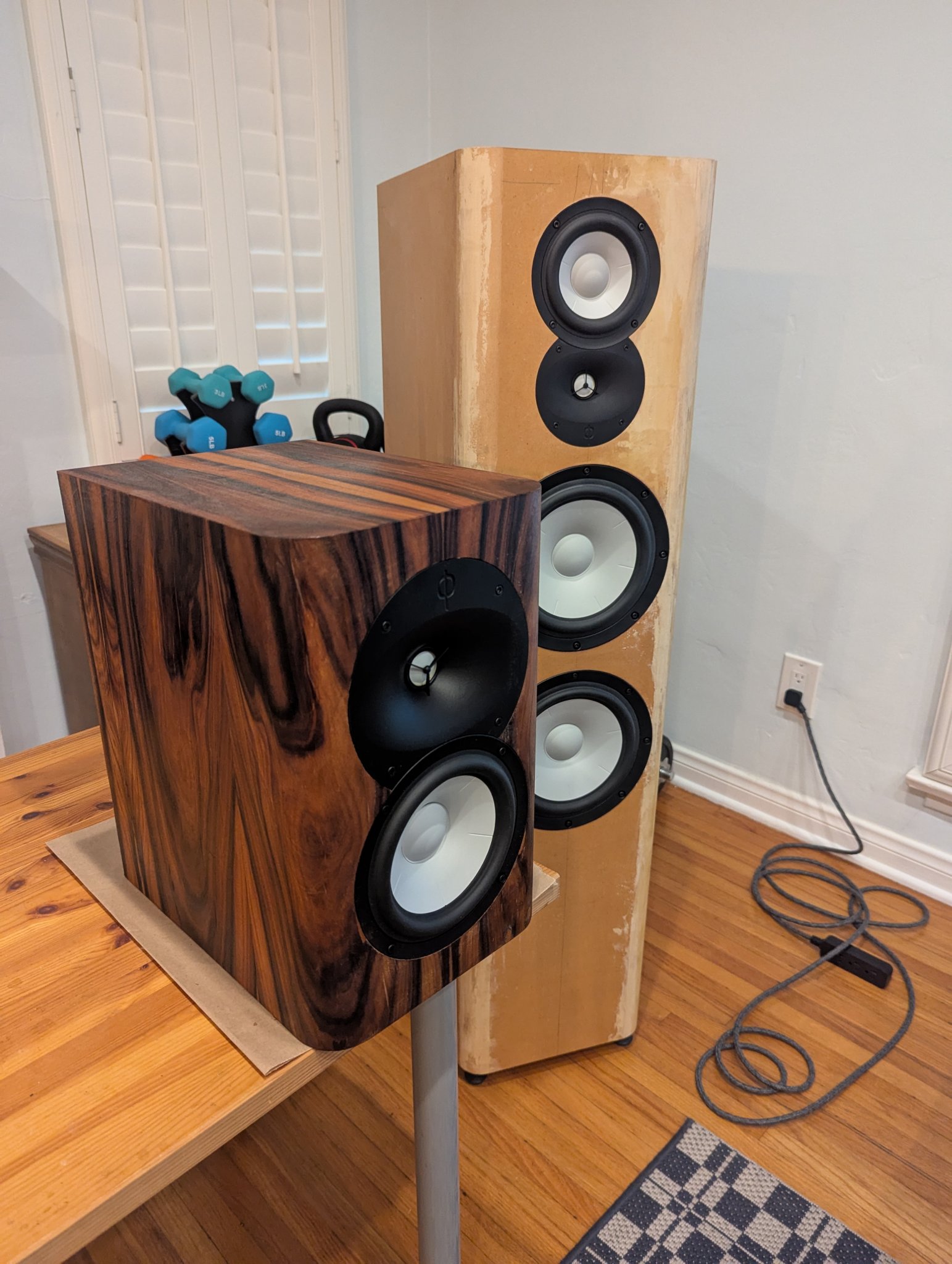

I am working on a gift for my father-in-law. looking for advice on bass alignment.
I have previously built the speakers you can see in this thread https://www.diyaudio.com/community/threads/3-way-w-sb-acoustics-ceramics-woofer-choice.348896/
My design is for an approximate 0.5 ft3 or 15 L box with a SB17 woofer and SB26 tweeter in a 6" elliptic waveguide.

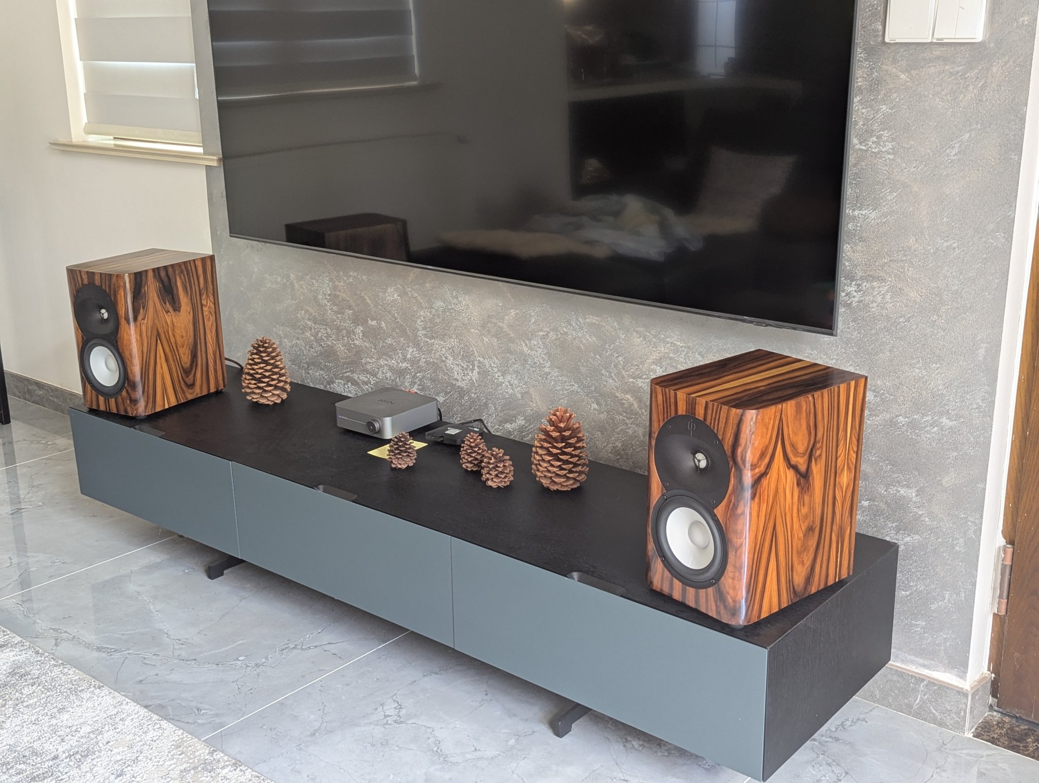

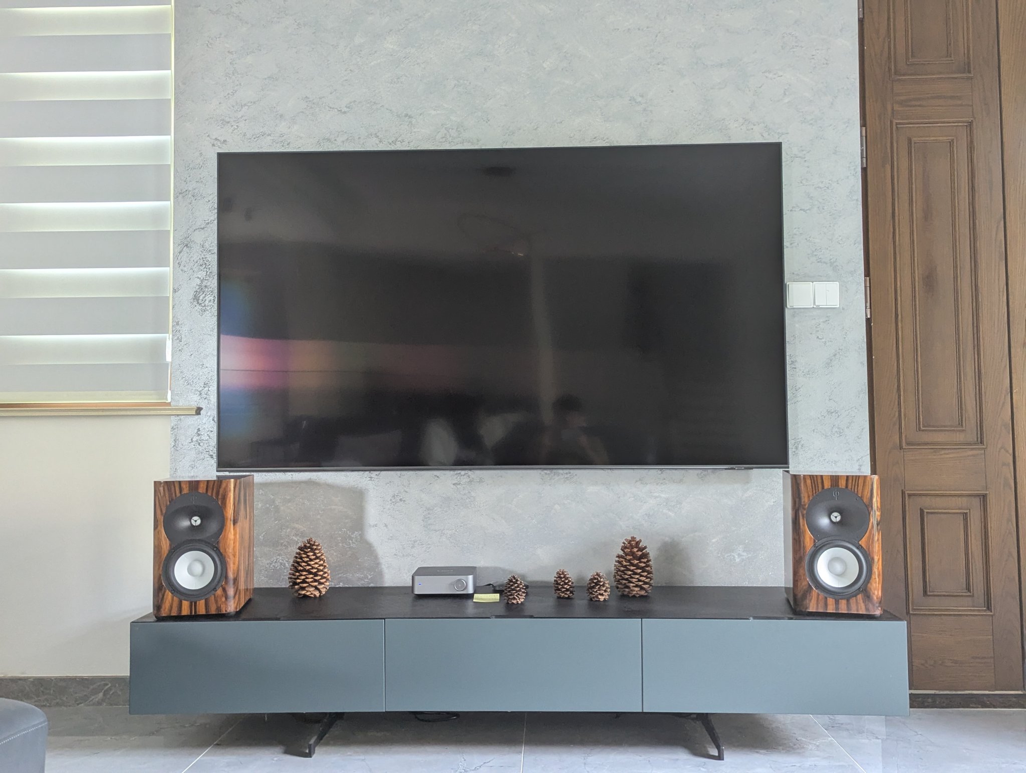

Details that will help guide advice. These will be placed on a large TV console. It is low and fairly deep, speakers would be about 12" from the back wall. Console is probably 96" wide. The room has a horrid echo, stone floors and ceiling height stone on the kitchen at the side. My in-laws live in Shanghai, so will be hand delivering the speakers my next visit. Will buy the electronics (integrated amp) when I am there. May also get a reasonable 12" powered sub as the room is quite large (estimate 18 ft by 40 ft).
Picture of design concept:

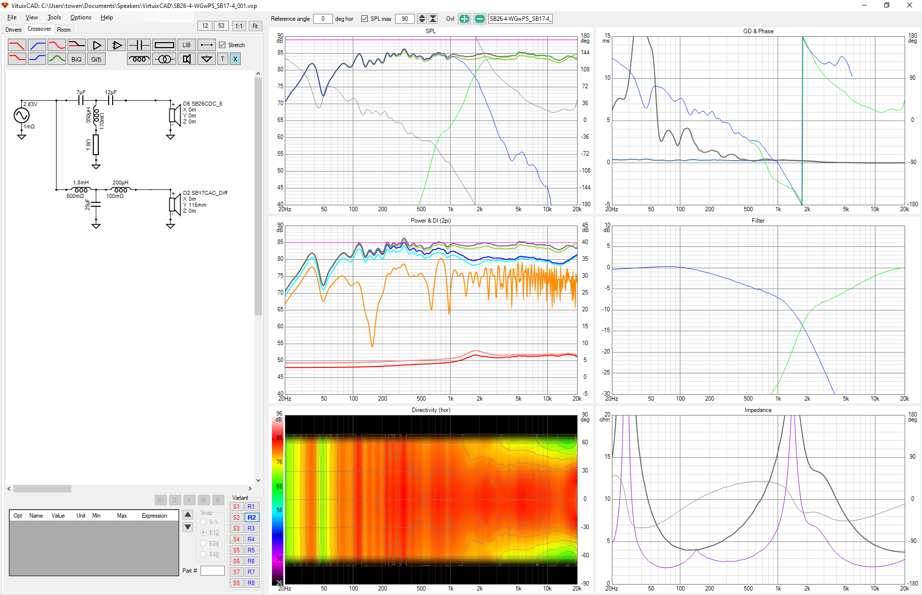

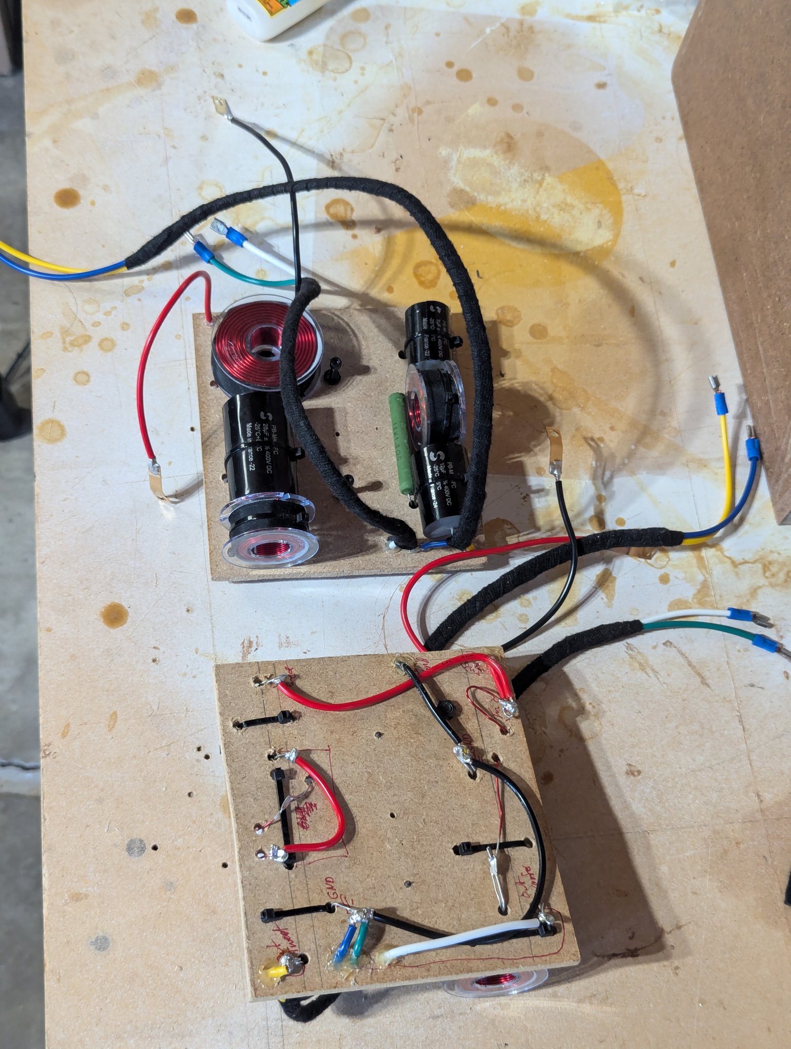

Cooked up a crossover. Tried a few things with different cross frequencies, filter orders, and adding a notch. I think this simple filter will do what I need. Huge dip at 150 is the floor bounce. Directivity doesn't line up as well as with the smaller midrange and waveguide in my other build, but good enough at the 1.8kHz cross over.

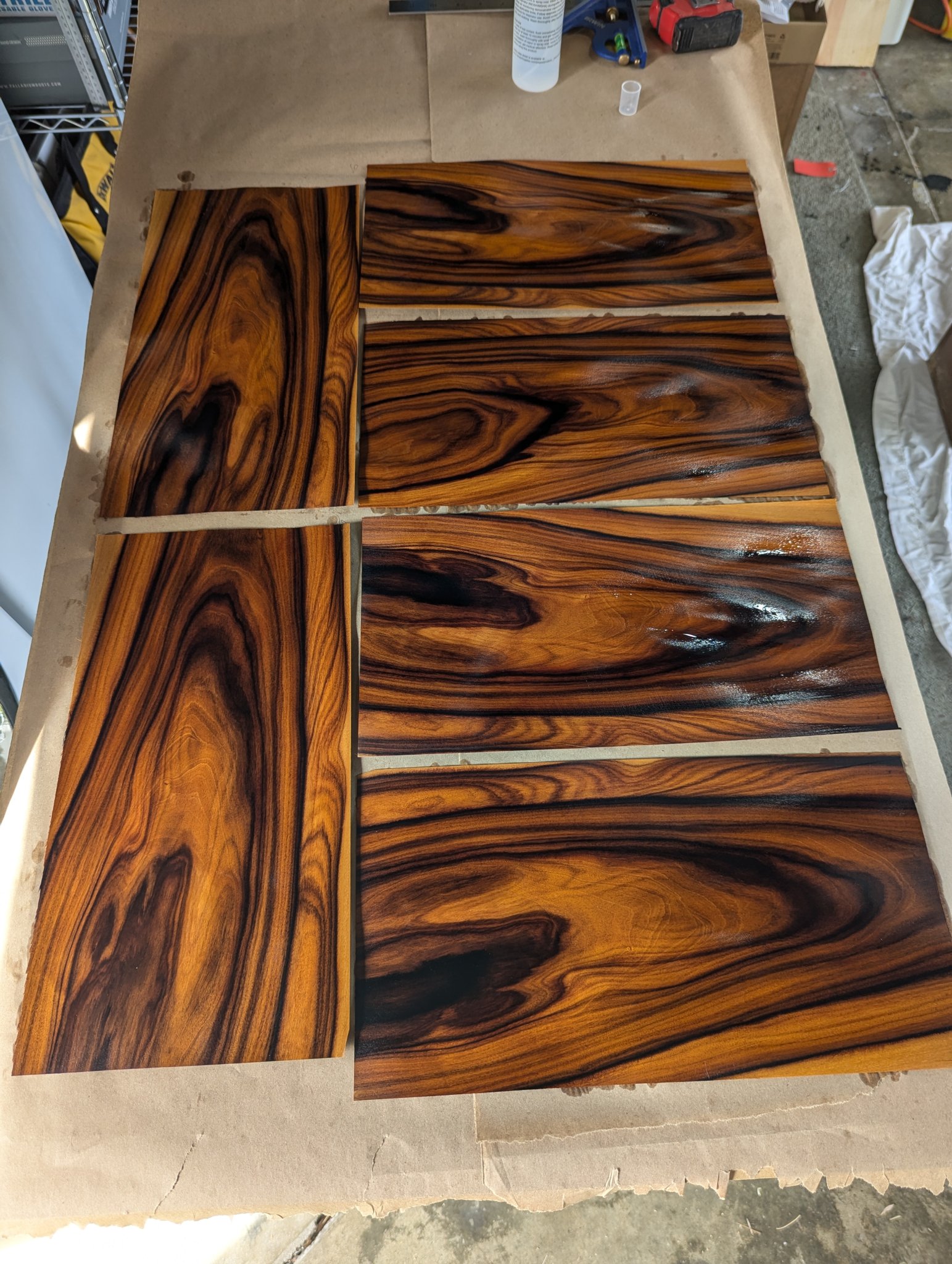

Going to order parts and start the build soon. For the cost curious it will be about $500 in drivers and cross over parts, $200-250 to MJF/SLS nylon print the waveguide (may go for glass bead filled this time), have the $60 in MDF on hand, tools on hand (~$1k for table saw, router, etc.), veneer will borrow from my stash of raw wood Bolivian rosewood (would be $150 for a decent sheet).

On that crossover design, your impedance really spikes past 20 ohms centered around 1.5khz. will this be used with a tube amp? Tubes generally dont like big changes in impedance.
Also, check out the SB Acoustics open source Bromo project. It uses the same drivers you have chosen, and the recommended crossover is available.

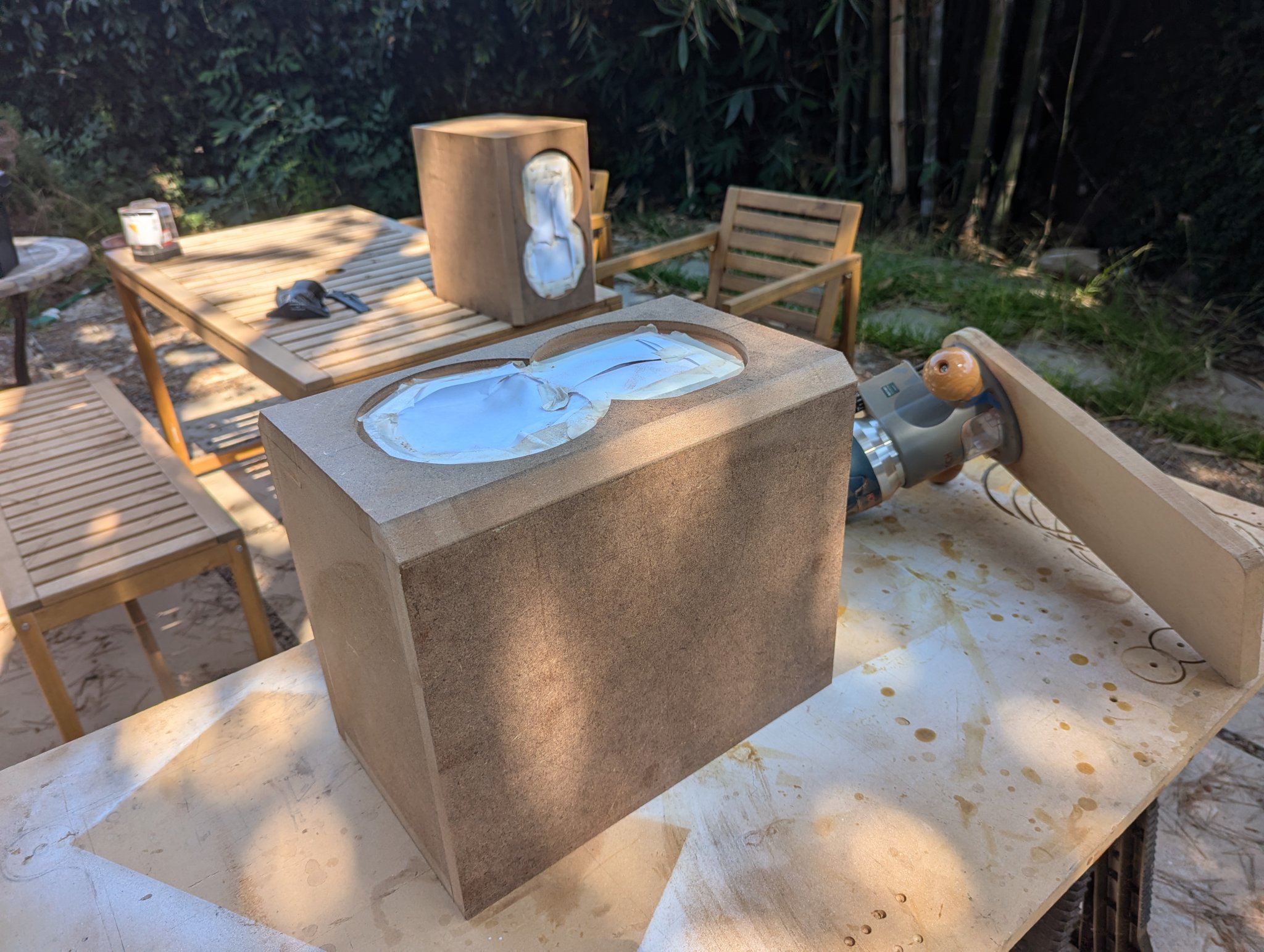

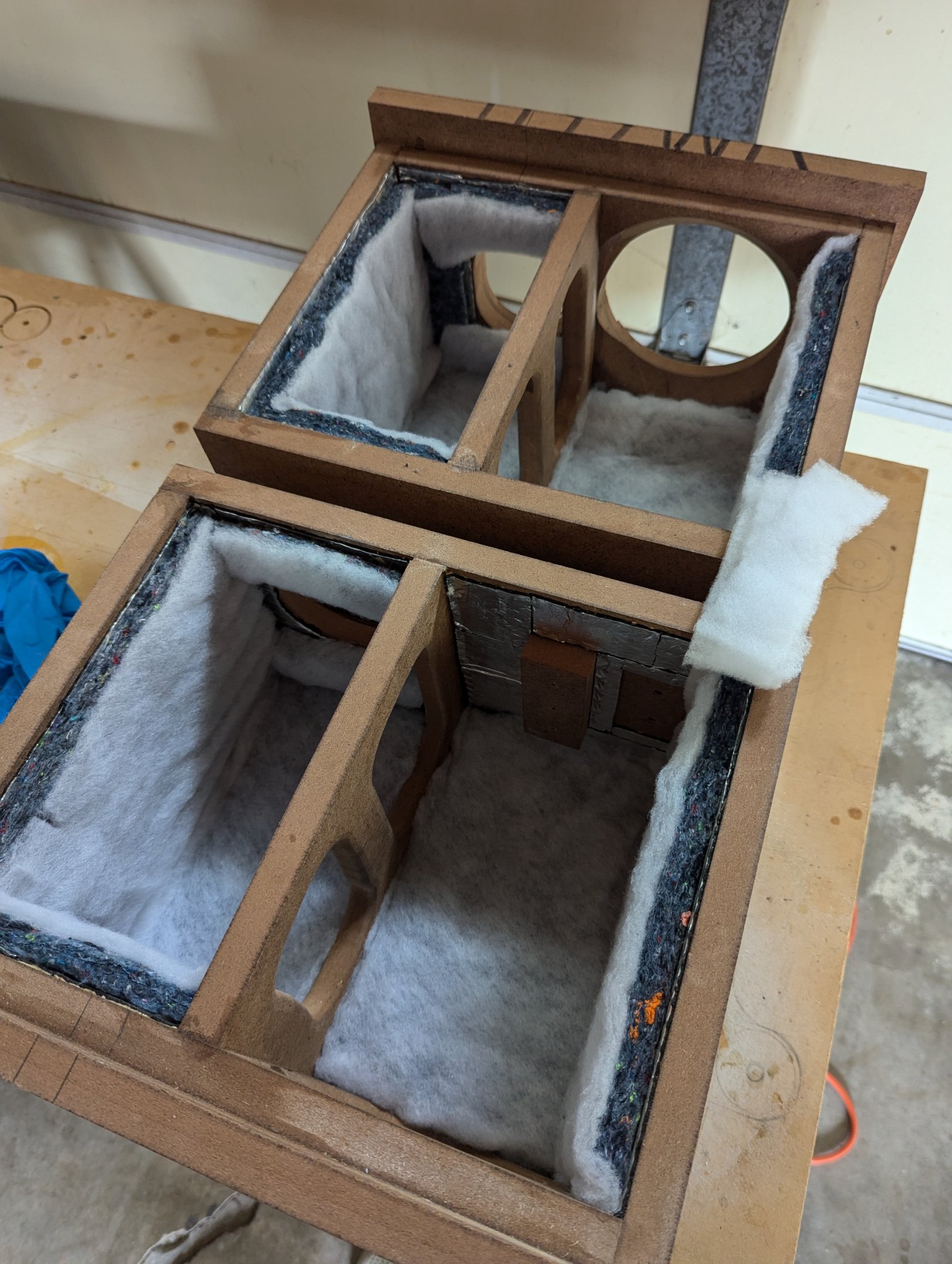

Progress with the project.

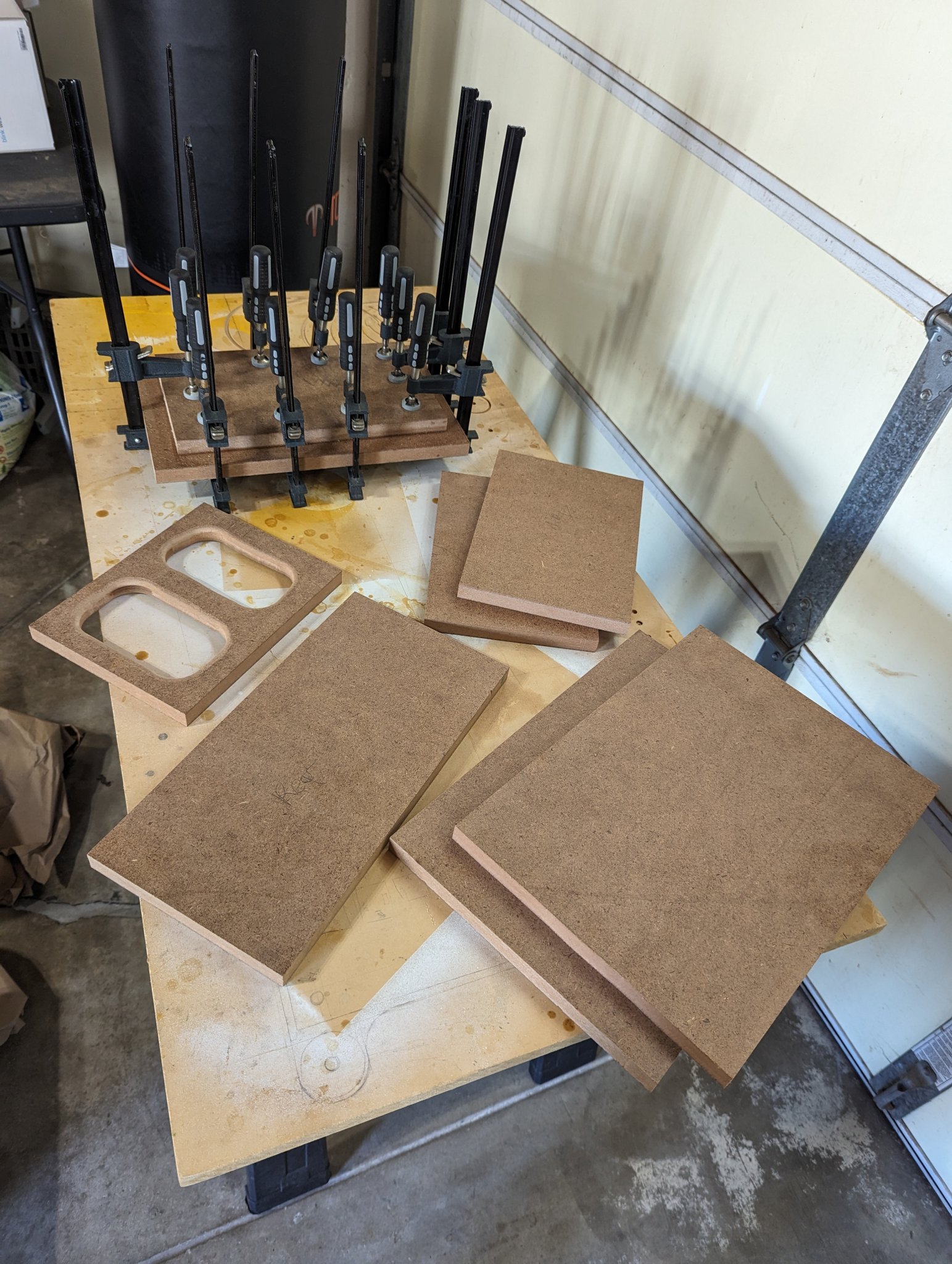

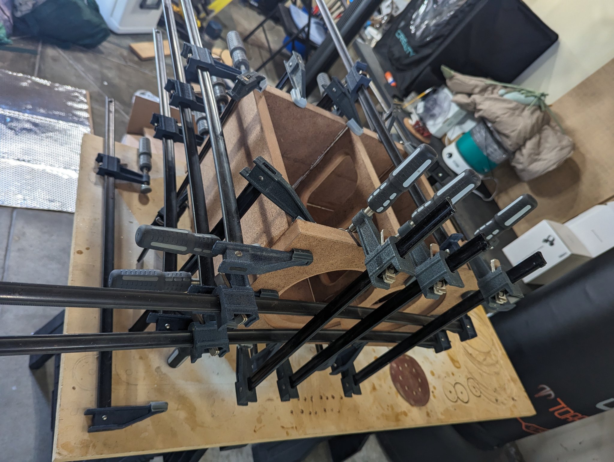

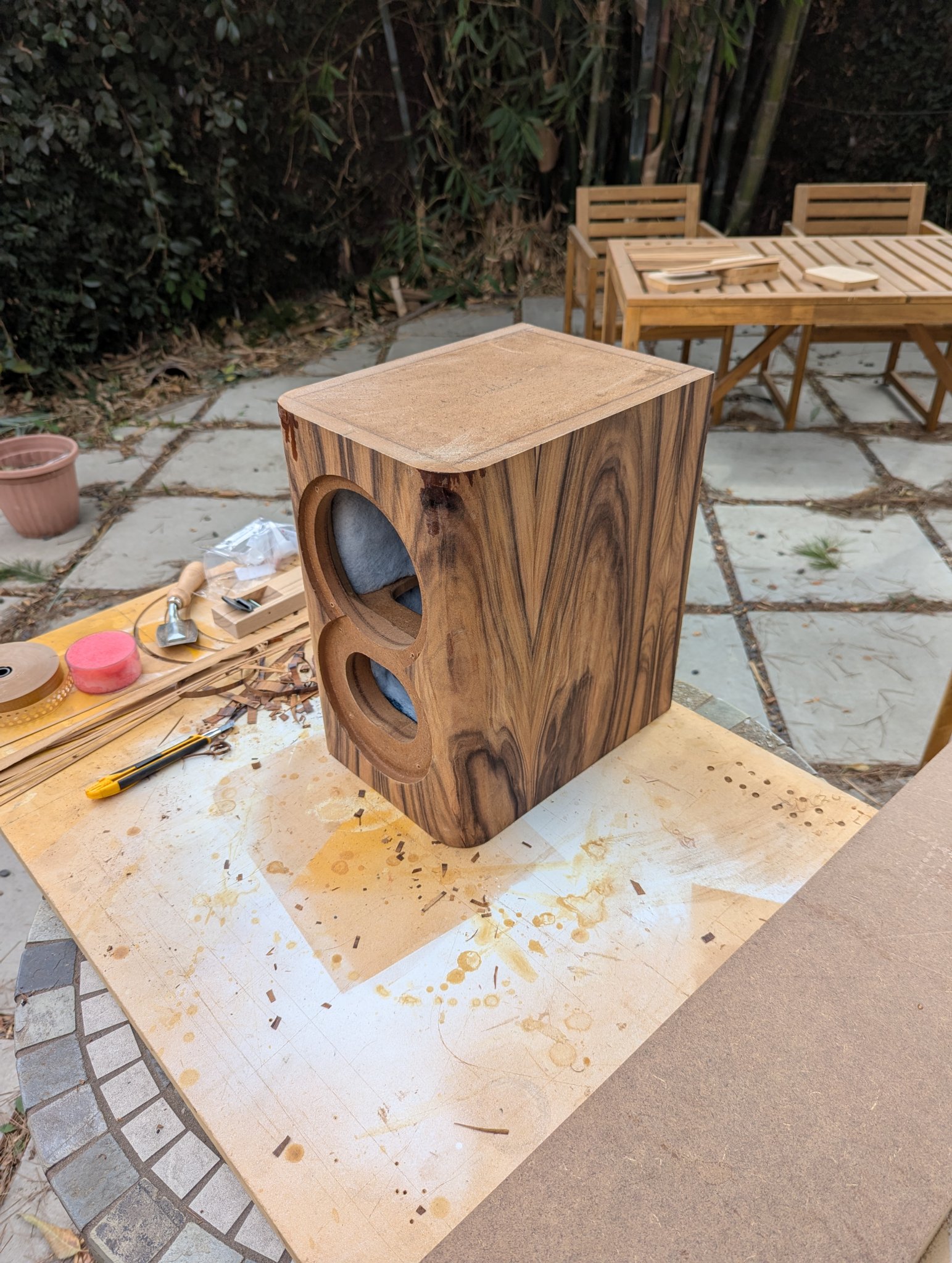

Got the cabinet parts ripped on the table saw and got halfway through the driver rebates before running out of daylight. This batch of MDF is darker and denser than what I have worked with in the past. Not quite HDF, but much denser than what I usually use.

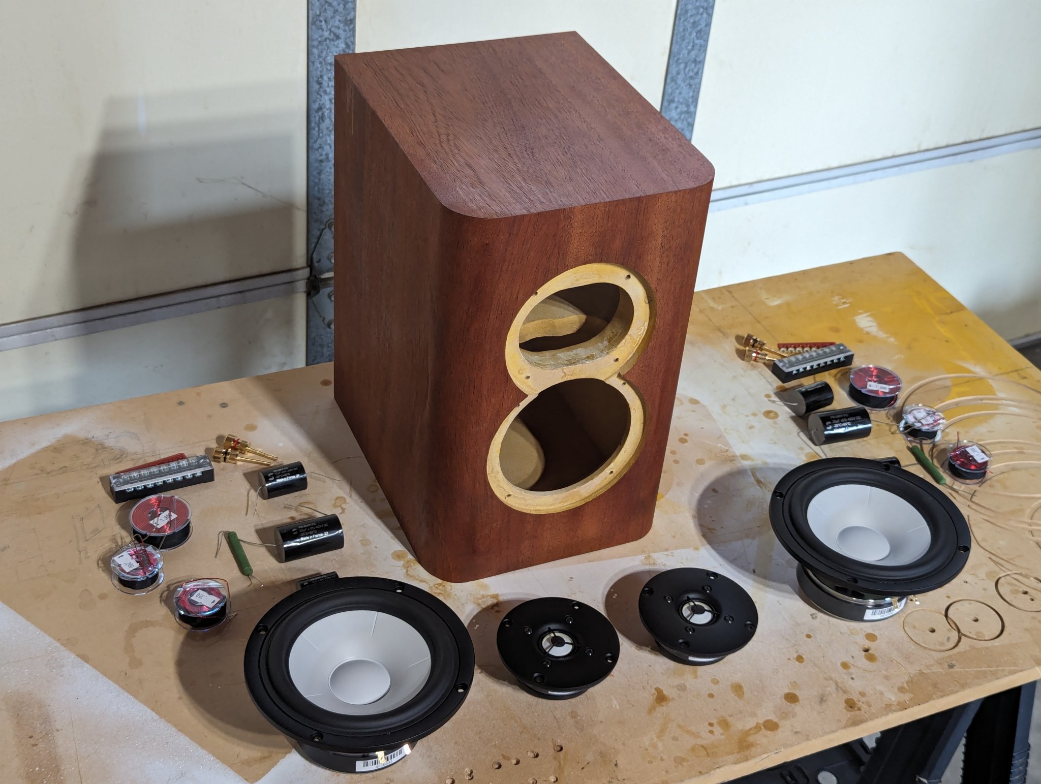

Initial crossover parts in hand. Most likely change is a slight adjustment in the tweeter inductor depending on the power response in the crossover region once everything is the in the cabinet.

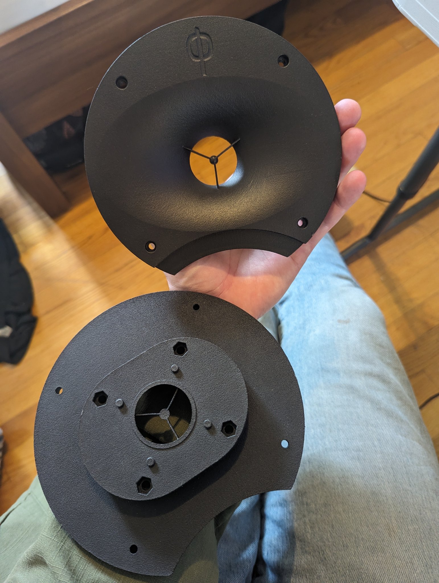

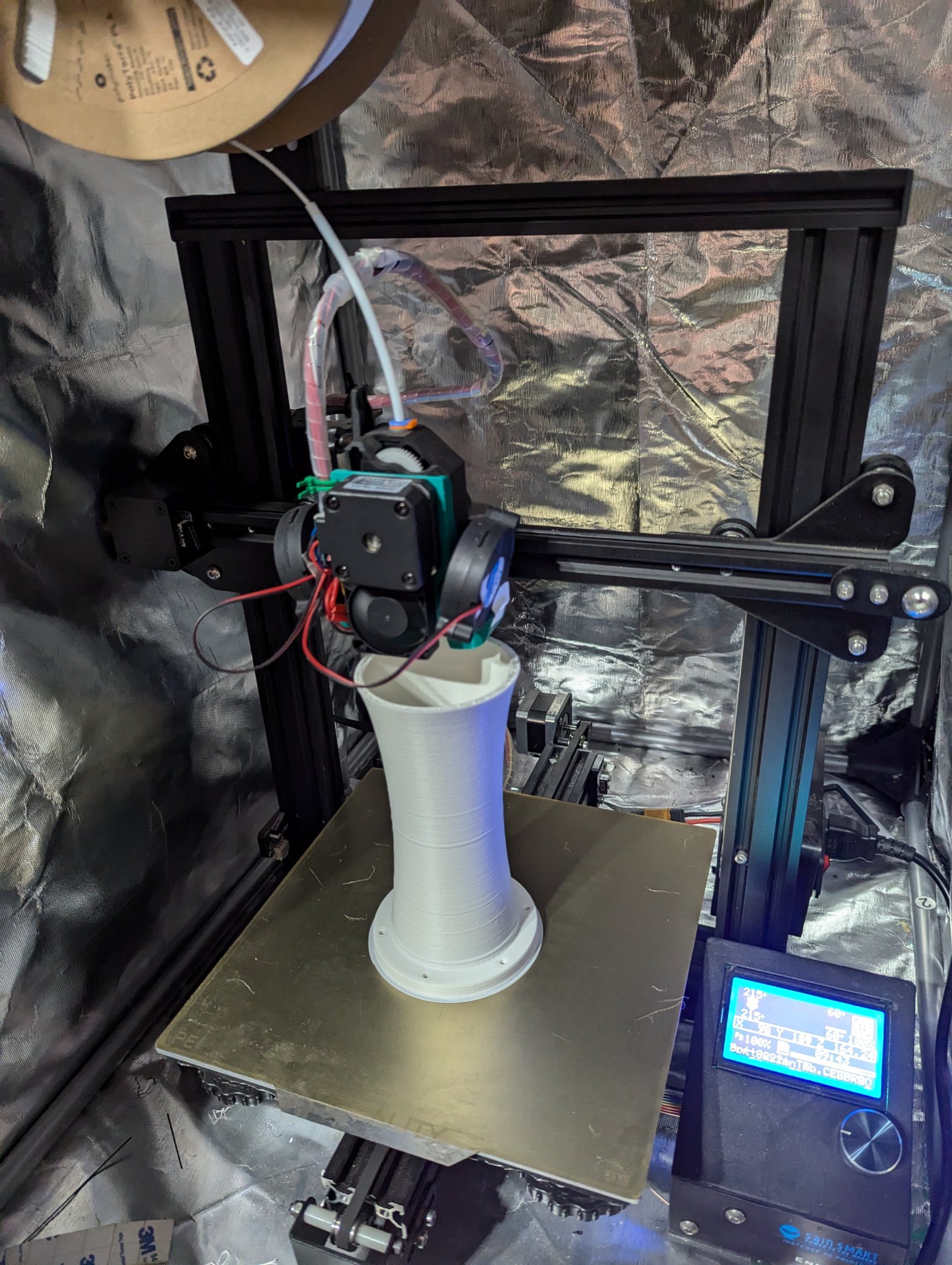

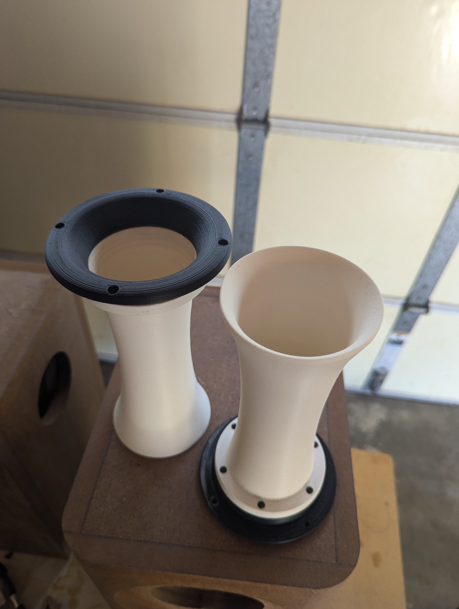

Waveguides are gorgeous. Got them done in glass bead filled PA12 MJF. Went for the higher performance material for the extra stiffness at this larger size and added more reinforcement to the phase shield over my past effort (broke and glued the shield on my 5" ones). Much better protection for the tweeter, some subtle warping that won't be noticable when assembled as it seems the printer chose their own orientation (not a big deal, could have paide extra to have forced orientation). These have to make a trip across the ocean so wanted to be more assured they would hold up.

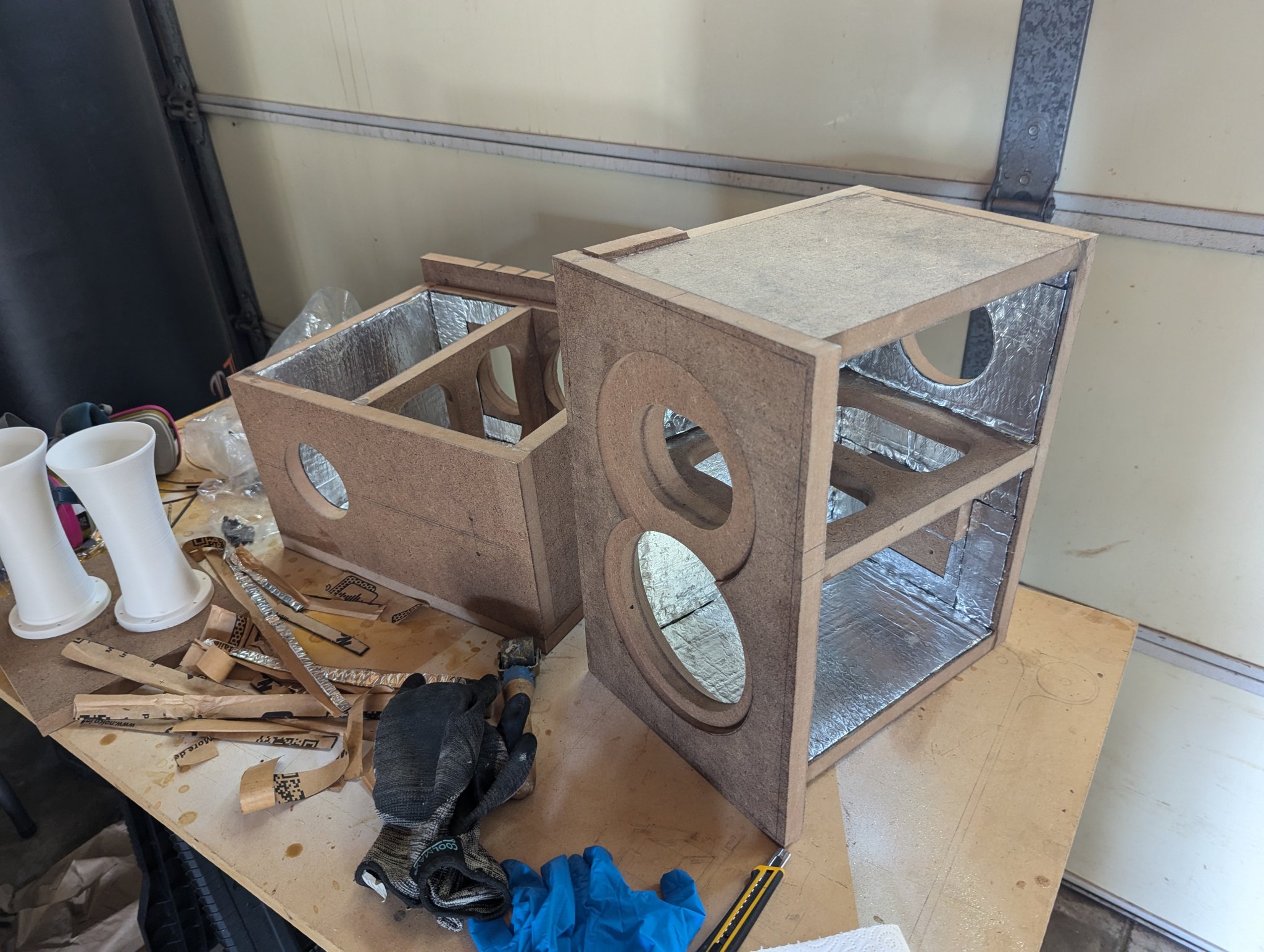

Next up is finishing the rebates and the glue up. Then we do bitumen pads and stuffing.

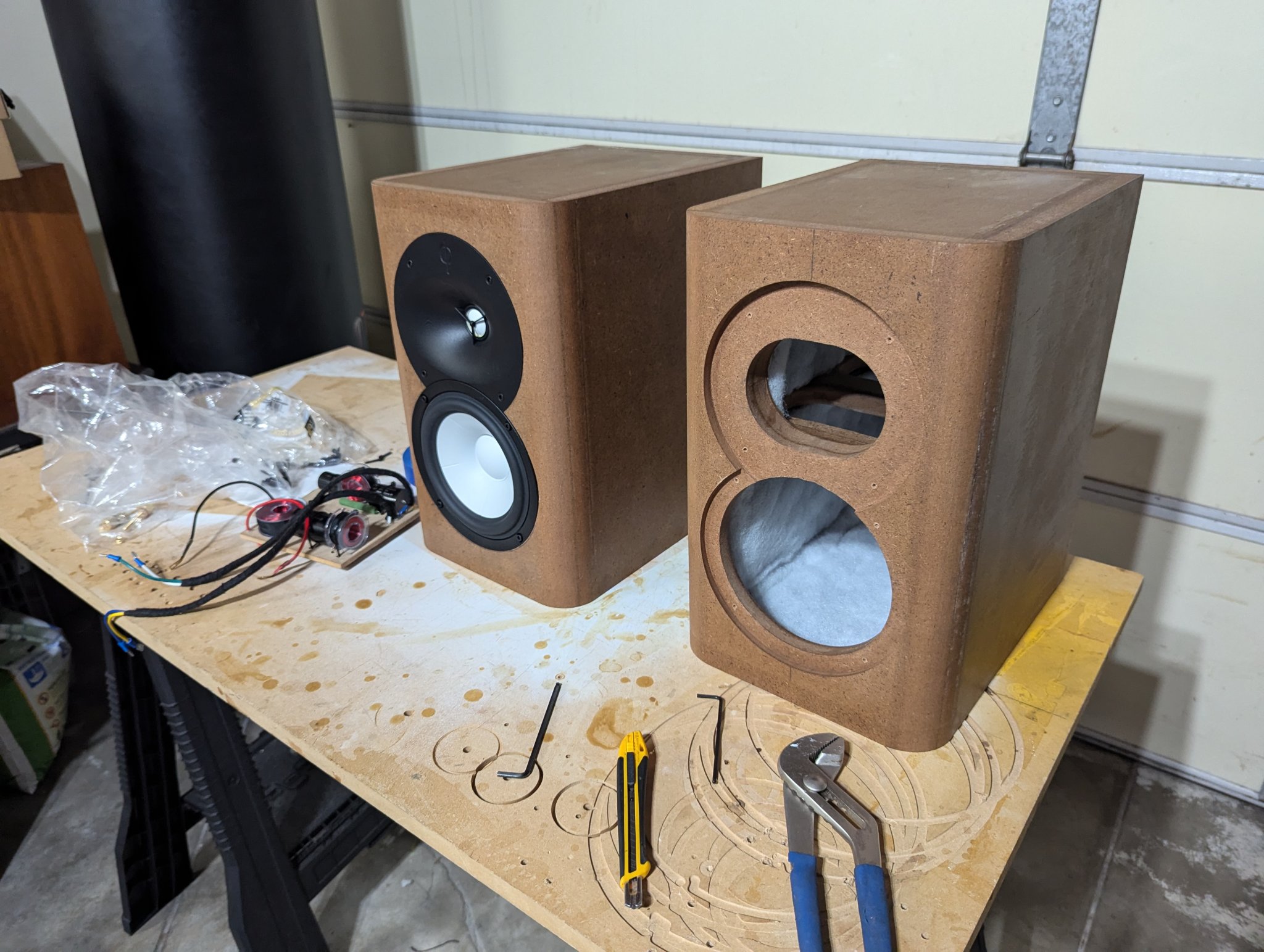

Yes, these are Augerpro waveguide profiles. Made my own phase shield (same location and size) and the big modification is the round rebate and tucked close woofer cut. Round is just easy on the router with jig. Always like close spaced drivers as well.
The assembly will have bluetack to seal the tweeter at the perimeter (not near the surround). The hexes you see will have nuts glued in and a backing plate screwed on with some foam will hold the rear cup to secure the tweeter.
