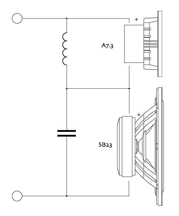

...first order cross over consisting of a 1.5mH inductor on the woofer and a 22uF film cap on the MA 7.3
Somewhere 700-800 Hz (nominally). Part size is going to need to increase.
Try connecting those parts in series and see what happens. It may help, it may not. One thing it does is lock the 2 drivers together so that the LP = HP.
attachment.php
Try with what you have
A series XO has a parameter called Zeta that describes the behaviour of the electrical filters around the XO. Zeta = 1.0 = Butterworth (with the same text book RL values as passive). Raise the zeta you get a depression, lower it a hump.
dave
