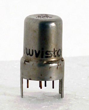

The first time I have ever seen mechanical decoupling was yesterday when I got a Tektronix plugin from the sixties, it contains something of which I do not know what it is, may be a double transistor or nuvistor, it is a type W plugin high gain differential comparator.
This thing is mounted on 4 rubber stands to prevent mechanical "noise".
I can post a pic if somebody wants.

Sounds like a C6W4 nuvistor tube. They are very microphonic.
It quite likely is...A nuvistor isn't microphonic per se but when you use it as a MC headamp you're dealing with high amplification stages at µV levels.
If it looks like this then it is a nuvistor:
Cheers,;)
