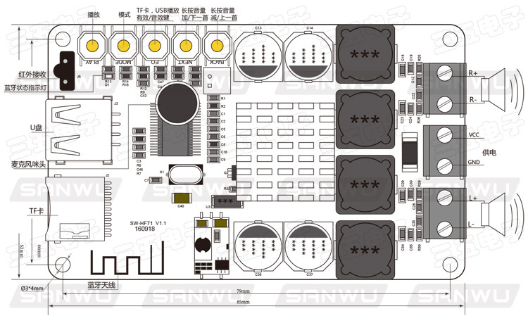

I just wanted to make sure if anybody has solved the problem of loud click&pop sound when muting this particular amplifier (like when the music is stopped on the smartphone). I have previously changed R21 and R22 to high ohmic values (discussion on page 2-3 of this thread), which removed the annoying click&pop at turn-on and yielded soft unmuting of amplifier when starting to stream music, but muting become much worse.
I mentioned the idea of putting parallel diodes to R21 and R22 to make fast discharging of the muting capacitors when muting the amplifier and still guarantee slow unmuting by charging capacitors through big R21 and R22. Has anybody have chance to try this out and can share the experience? Or any alternative solution which can be easily mounted on the existing PCB on the existing pads without too much rework (without extra reset circuitry/opamp "flying" on a separate PCB over the amplifier board)?

I have few of those TDA7492P boards that I'm trying to improve. Replacing R21 and R22 seems to fix power-on pop but still don't know how to deal with noise. Removing buffer stage and going straight with BAL signal as desribed in this thread seems to be easiest and effective way. The problem is that I want to keep analog input. Is something like DRV134 on external PCB the only solution? Or maybe there is simpler and cheaper way to deal with noise and keep line-in?
