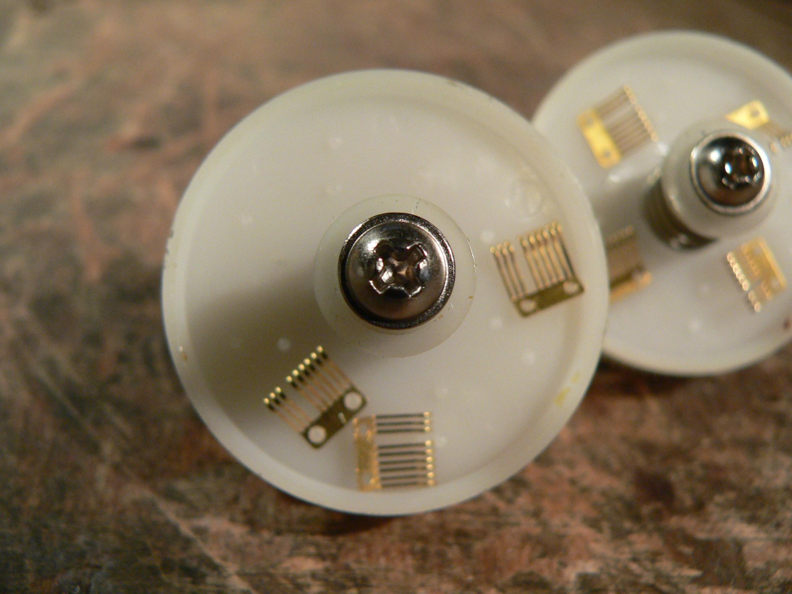

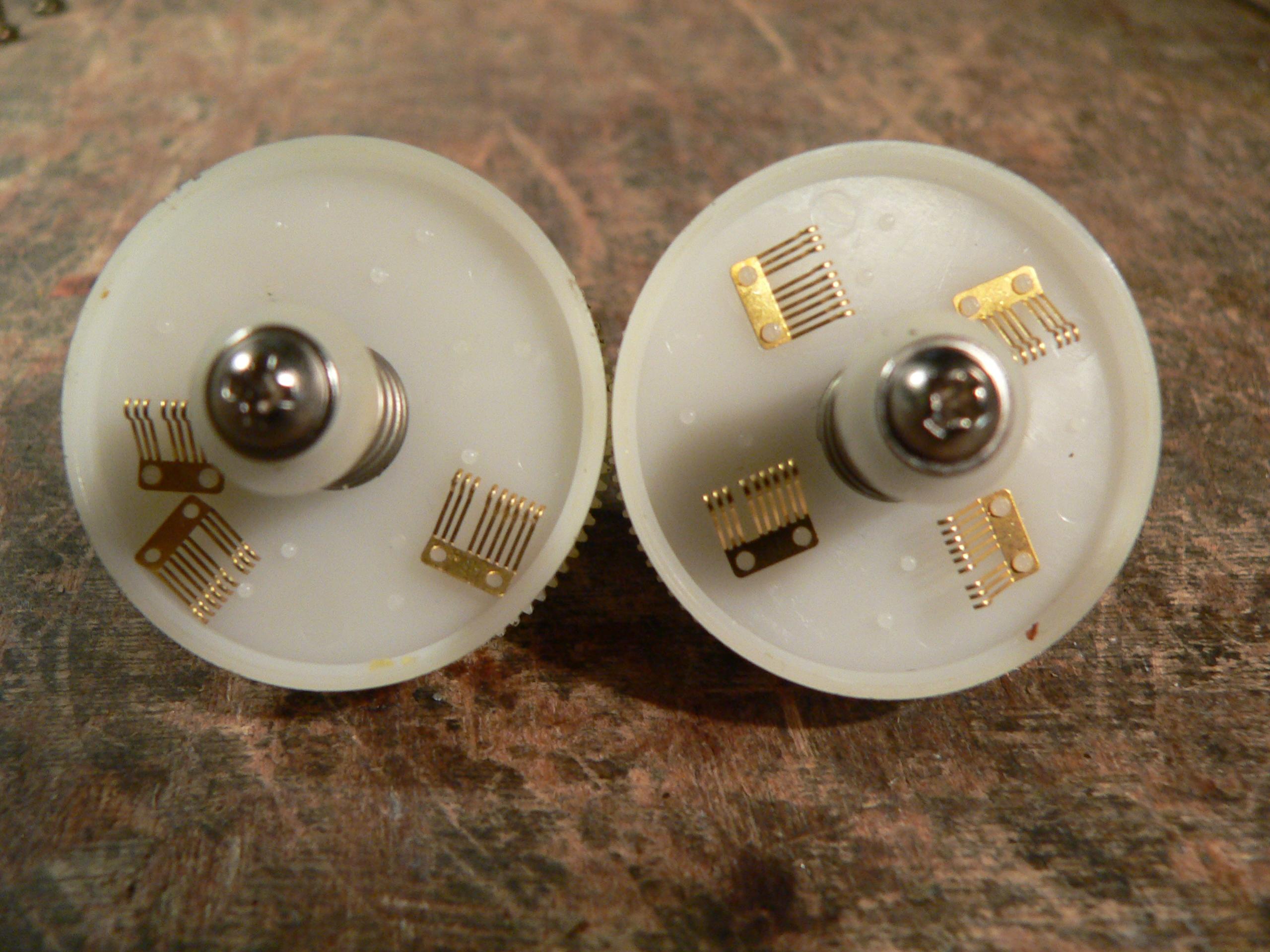

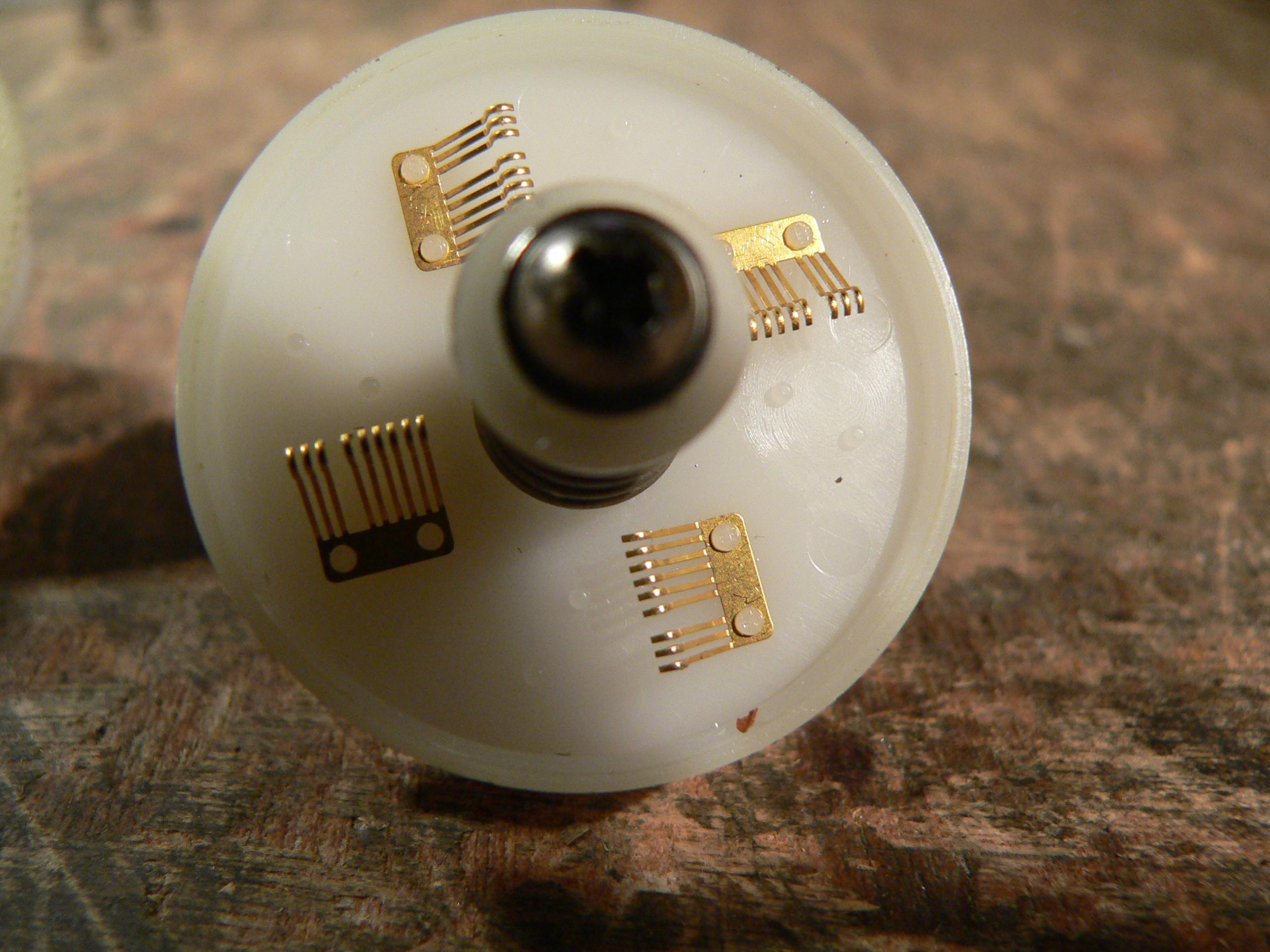

the selector gears contacts get off
teflon break you can swap position, i loose one contact, it fall on the floor and i c'ant find, i will trow this nonsense amplifier in the dust bin:

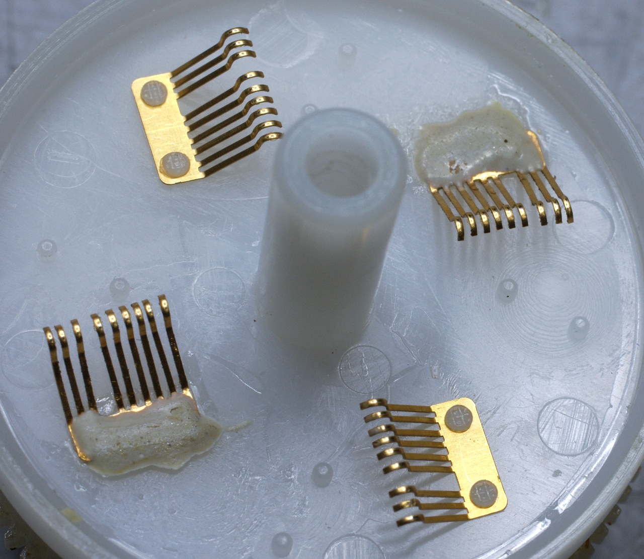

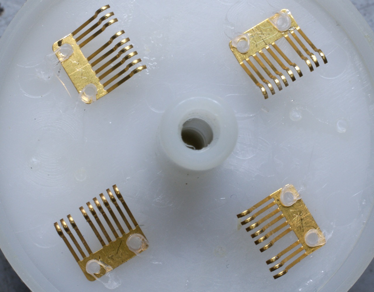

What a waste... I have the same issue with these fingers. In my case someone had a go at them and glued them to the plastic. But if you look carefully you see unused posts that can be used to re-attach the fingers to the wheel. I will attempt this and report back here.

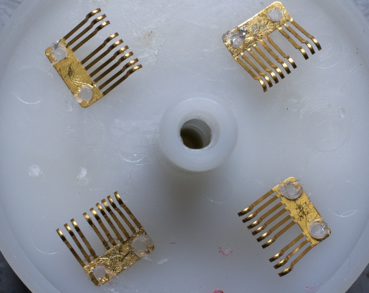

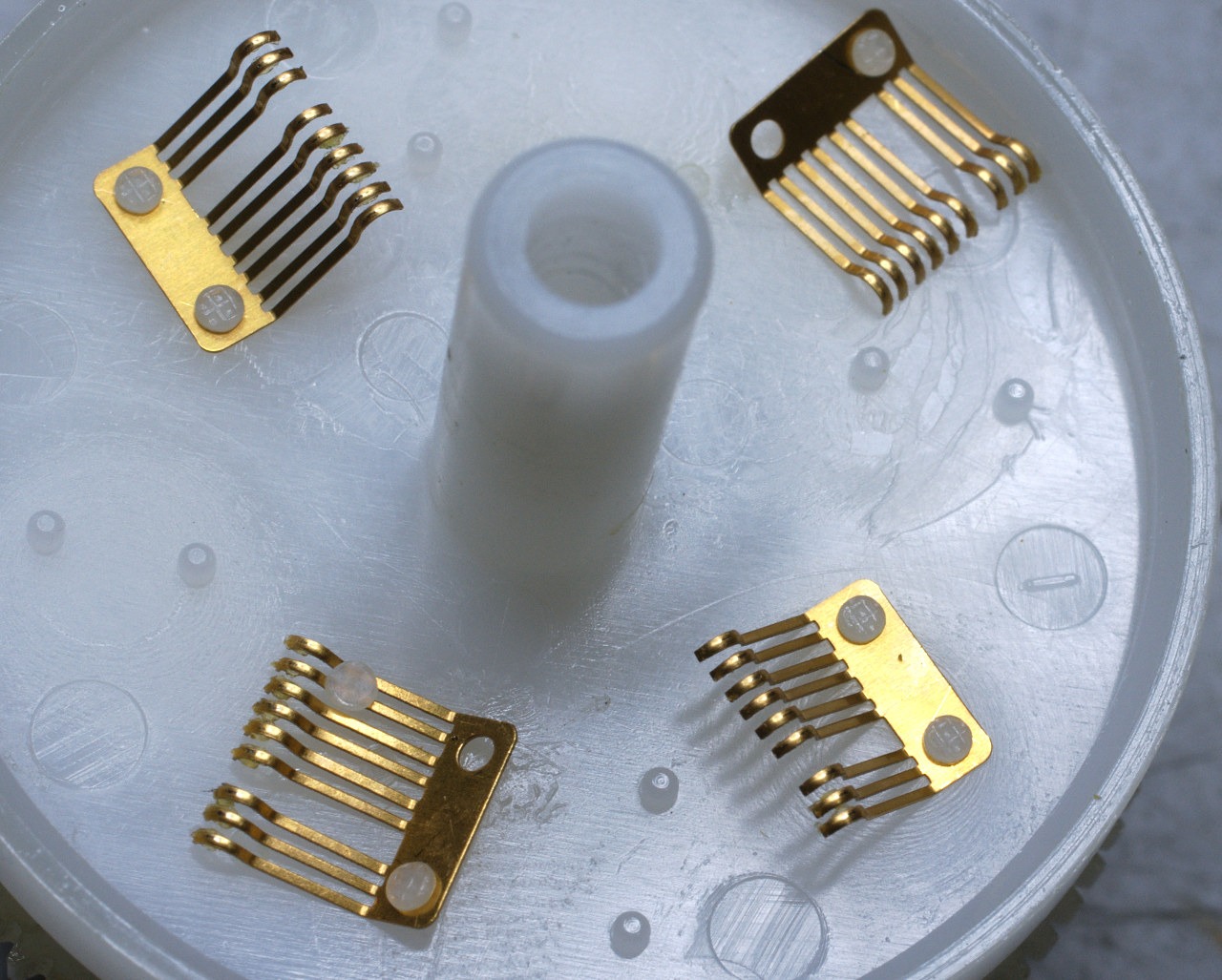

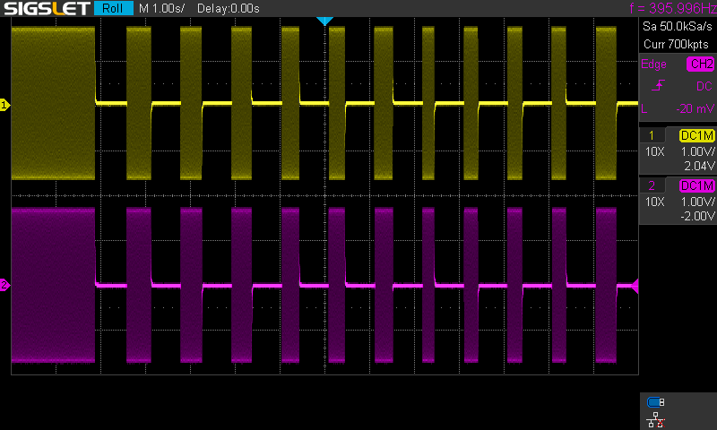

The glue in the left pic above had gone brittle and the fingers were all bent. I tried hot melt glue but the vanes also fell off. So I decided to use the spare posts. With my soldering iron at 180°C I carefully melted the post to fix the vanes. This resulted in a complete fix. The contacts were cleaned and not greased in any way. The gold flash will wear faster but the sound will not be affected. The scope shows subsequent input switching.
Still, what a horrible engineering...
