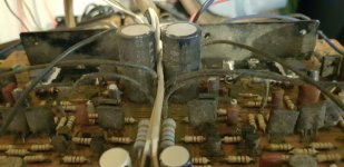

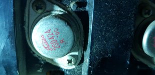

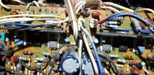

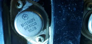

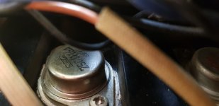

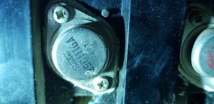

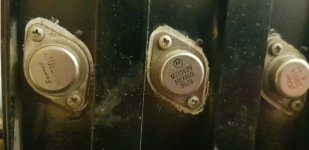

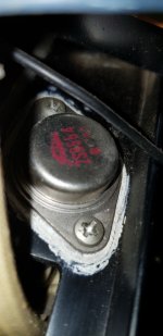

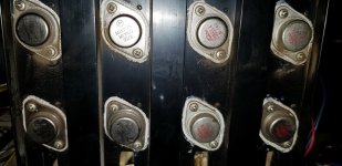

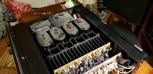

Hello guys!
Three days ago I entered in possession of an Au 919 and unfortunately for me, it looks painful inside. I'll put some pictures for the example.
The major problem with it is that out of the eight final transistors there is only one original one. The rest is a soup, a blend of 4 Thoshiba with 1 Sanken and 3 Motorola + 1 Sansui.
I read this forum about the restorations of this wonderful device, which I wanted very much, so I will appeal to yours goodness to help me with some ideas on what to do next. I tell you from the beginning that I do not know nothing about of electronics and I will appeal to one electronist who is a few hundred miles away from me. I would trust with one of those who posted here the Au 919 restoration but the distance is very big because I live in Romania.
I have been looking for some replacement days for the original transistors and from what I read here on the forum I understood that they successfully used the 2SA2121 / 2SC5949 pair to which I would have access but do not know if they are counterfeit by the Chinese. I searched the site: SANSUI-PARTS-SHOP where I found only 2SC2607, 2SA1116 have no stock, the latter being those recommended by the manufacturer.
Another problem I have found is that when applying tuna corrections, they feel hardly at all. So there's should be work there.
He is in working order and this looks very good. I really want to restore it and enjoy the sound of Sansui. Now with the transistor mix does not differ much from the old HK680 amplifier.
The speakers I'm going to pair with are HPM 110, which will also need to be restored. the parts in the filters are original, but I noticed that colloid was passed from the capacitors.
I have successfully tested 2SA2223A and 2SC6145A as outputs in both AU919 and BA-F1 (the latter is the separate power amp version which is a virtually identical circuit).
You can find these at Profusion Audio Semiconductors - Buy Online, guaranteed Sanken parts.
You can use 2SA1837 and 2SC4793 as drivers (on the small heatsinks on the power amp PCB) but you will need to modify them by grinding off the integrated heatsink insulation (these are completely plastic insulated) to expose the heatsink tab metal and use standard mica insulator, and using the middle lead (collector) instead of the heatsink tab as a contact. This MUST be done or the bias thermal tracking is not going to work properly. This is a bit of a complication but unfortunately anything else I could recommend as replacements is not guaranteed not to be fake.
The TO126 pre-divers etc you can replace with 2SB649 and 2SD669. This is not an ideal replacement but close enough not to require other changes.
All of the above are available at Profusion. The output stage will be a LOT more robust with the replacements.
