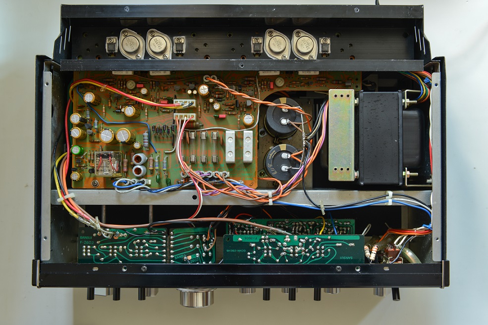

Without the if I disconnect the earth from the power cord the hum is actually really bad. I would love to keep the original Class II protection but than I will have to find another way to get rid of this nasty hum. Whenever I approach my finger to the signal wires coming in to the preamp it gets 10 times worse.

When did this hum come in again? Was it with the extra power ground? (Have you tried attaching that to F-2598 yet?) Or was it with the regulator mods?Without the if I disconnect the earth from the power cord the hum is actually really bad. I would love to keep the original Class II protection but than I will have to find another way to get rid of this nasty hum. Whenever I approach my finger to the signal wires coming in to the preamp it gets 10 times worse.
You've got to consider that circuitry on F-2602 and F-2603 is fairly high impedance, and at the preamp input it's highish impedance with partly very low signal levels. That spot is very sensitive, and there should really be some coax or other shielded cable connecting F-2603 and F-2604, but since you write "wires" I suspect that isn't the case.
What you could try is taking a fourth piece of wire (not too thin), loosely winding it (in helix shape) around the three ones connecting F-2603 to the preamp input, and connecting it to post 46 (ground) at both ends. That's arguably not the greatest shield in the known universe but should get the job done.
The ground connections from F-2603 to F-2602 and back to F-2598 could probably also do with some reinforcement. Board traces look reasonably beefy as-is except for the middle area on F-2604 itself. I would also change grounding on F-2602/03 a bit - cut the 41-41 connection, instead run a wire from 46 to 38 (or close) along the existing ground traces. Ideally, that's 46 over on F-2604. I bet doing so would already have cut down on induced noise significantly, you might not even have needed the extra power ground then. (It would have diverted the noise current around all of F-2602 and F-2603.) The 46-46 connection should be fairly stout to avoid degrading channel separation at low volumes, but that should already be sorted with the extra shielding effort. Ideally I'd want to implement a full star ground but that gets tricky with those shielded connections, I'd have to think about that some more.
BTW, it would be interesting what the ohmmeter has to say on the connection from F-2604 to the ground screw stock.
I would also consider making a shield for F-2603 (and maybe F-2602 as well) that can be mounted maybe 0.5..1 cm away from the PCB's back side. It doesn't have to be a solid metal plate, a grid of bare wire pieces (a popular soldering exercise) would also do while being more easily supported mechanically.

Okay so I did what you said and cut the 41 to 41 ground connection and got a wire straight from 46 to 38, than I added a ground wire around the left and right channel signal input from F-2603 to F-2604 and connected the ground for the preamp filtering directly to the chassis on F-2598.
The hiss is now way way down and doesn't really change with volume except when tone defeat is OFF (because I didn't add any filtering there yet). No hum when volume is down but it gets fairly loud when I turn it up and is still very sensitive to me touching the chassis or even approaching the preamp boards F-2602 ~ F-2604. I will see later on if I can get that shielding done.

Phew. Theory and practice are aligning for once. Can't beat a decent star ground and some extra PSRR.Okay so I did what you said and cut the 41 to 41 ground connection and got a wire straight from 46 to 38, than I added a ground wire around the left and right channel signal input from F-2603 to F-2604 and connected the ground for the preamp filtering directly to the chassis on F-2598.

You get hum when touching the chassis? That's weird. The chassis should be firmly connected to circuit ground via F-2598 (which then goes to F-2602 post 38), acting as a Faraday cage with the case closed (assuming the lid is making good contact). In no way should it be able to couple stray signals into the circuit.No hum when volume is down but it gets fairly loud when I turn it up and is still very sensitive to me touching the chassis or even approaching the preamp boards F-2602 ~ F-2604. I will see later on if I can get that shielding done.
Stupid question - you don't happen to be testing with the input open? Could you make something to temporarily short out both channels of a high-level input? (A low-impedance source would also work.) We are, after all, talking about 250 kOhms of input impedance, with non-ideal shielding that's one rather nice antenna potentially extending from the volume pot back over the tone controls, input selector and input board. Let's try that again with the lid back on and input shorted in order to avoid chasing ghosts.
Now you should determine where phase is in the outlet that you used and mark the plug so you get the lower value (52 V) in use.I have got 129v ac from chassis to earth one way and 52v ac the other way...
Do you know the input impedance of your multimeter? That would allow estimating how much mains coupling there is. We are talking pF range when shielding works well. With 10 Megohms of multimeter Zin, we'd have something like 180 pF to phase in one direction and 75 pF in the other. Decent enough for a transformer of a certain size, I suppose, though not exactly earth-shattering (if still more than an order of magnitude better than a lot of SMPS-equipped gear, which tends to be ~1 nF range). A certain asymmetry in values is expected because the primary winding does not couple to the secondaries equally everywhere, so mains coupling varies according to which end is phase and which is neutral.
Just in case, I would check for continuity between the transformer's shield winding (that's the black wire) and the center taps (white / grey) and F-2598 ground. If that's fine, coupling is as low as it's going to get with this transformer.
Hmm, according to the picture here, the power supply star ground (where the aforementioned wires are joining) is on a somewhat wimpy-looking wire "bar" right between the big smoothing capacitors. It is generally preferred to T the capacitor junction off a bit, but if you don't have a buzzing problem right now, better leave this as-is. You can do the math on how much this piece of steel(?) wire is going to add to capacitor ESR. It's not something one would do like that today.

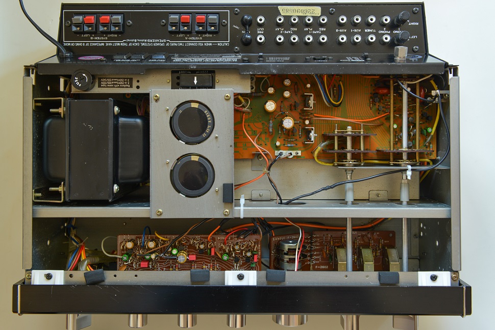

Here are some pics as promised :
