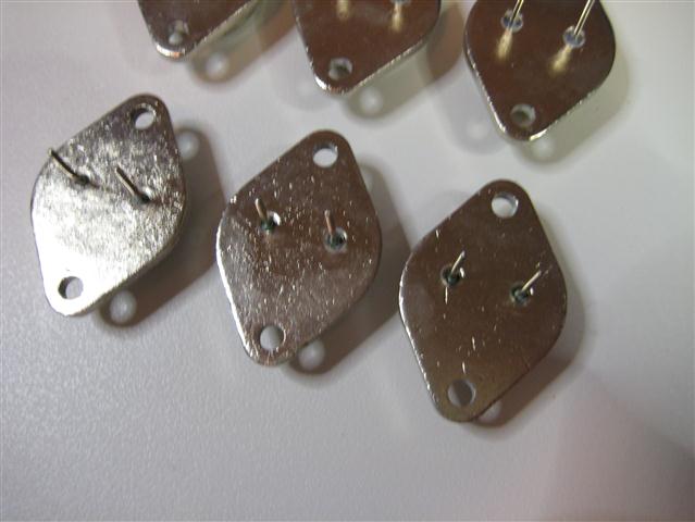

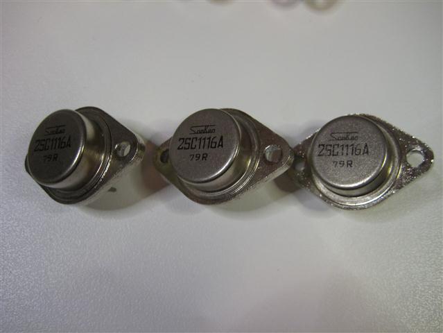

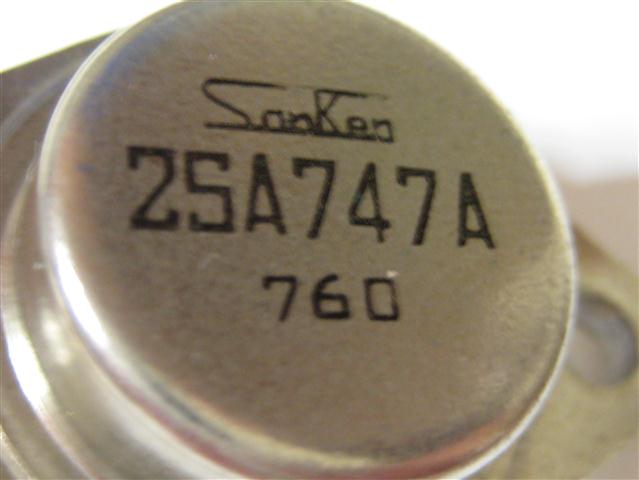

Redrooster - This Amp was Overheating when he brought it too me. That's what he [Initially] wanted me to Fix. After attempting to adjust the DC-Offset & Current Bias, 2 of the 4 Power-Transistors blew on the F-2581 Power-Amp Boards. (1 of the PNP's & 1 of the NPN's). I went ahead and changed the All, installing the Correct MJ2119x's in they're respective Location, replacing the 2SC1116's with MJ21194G's & the 2SA747's with MJ21193G's. I also replaced all the Electrolytic Caps on the F-2583 Bias Board. I found 2 to be abit over 20%-off in Values, and 1 to be Totally shorted.
Each of the original Sanken Power-Transistors gingled like Bells after removal.
So they were all about to go anyway. But now it still Overheats... Only MUCH Faster this time!! It used to take over 25 minutes when it was brought to me. Now, it just takes 5 minutes. :/
