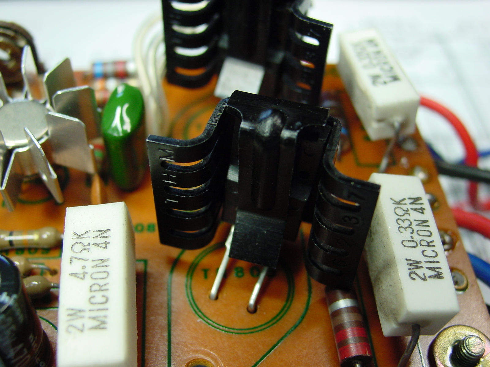

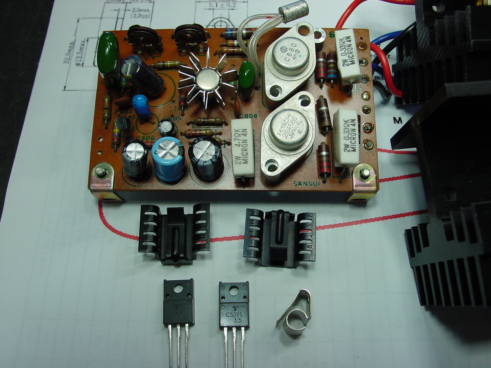

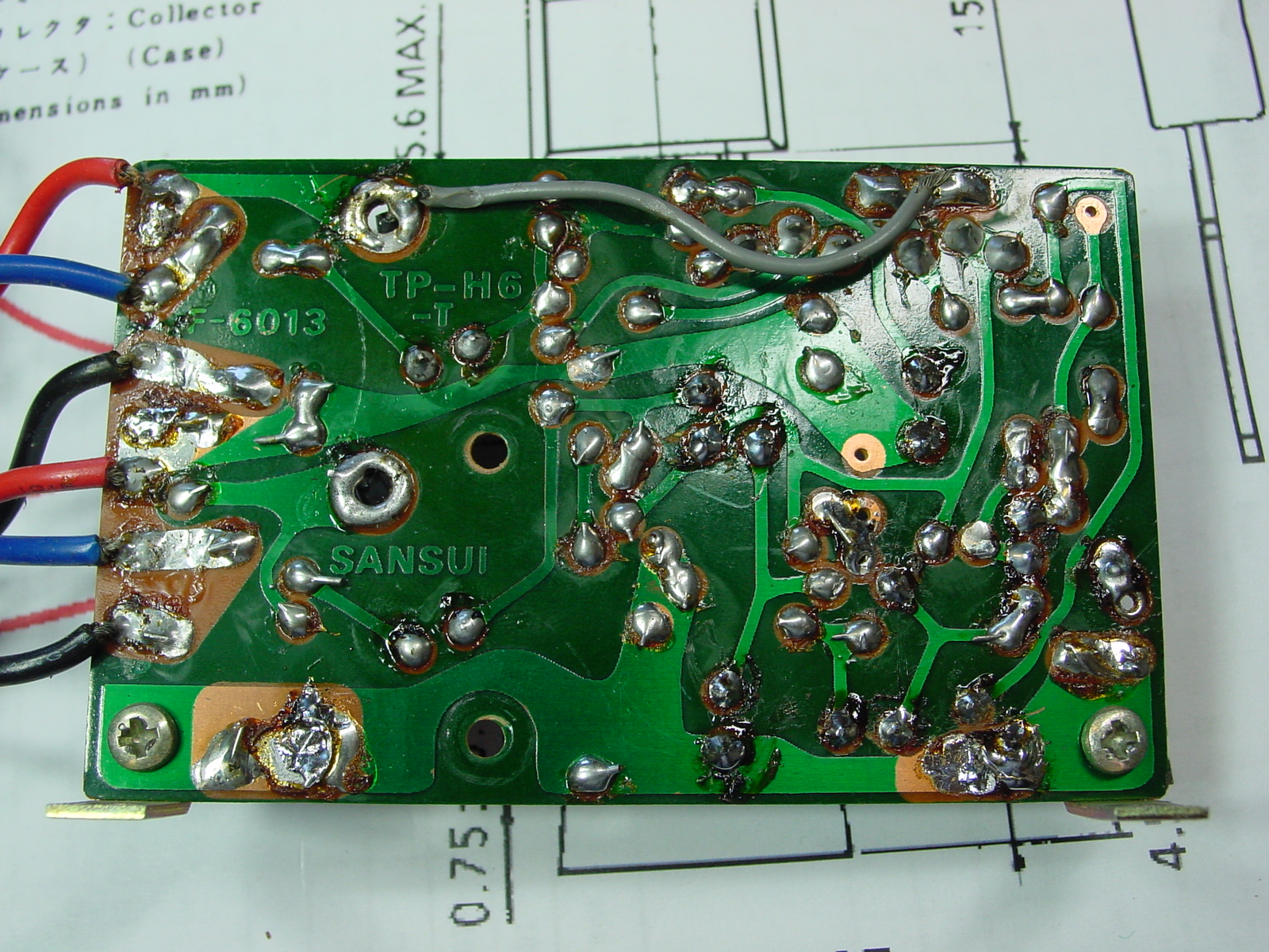

Sakis, some comments on your advise (and appreciated your input and observations BTW):
the noise was probably produced by the new relocation of the rectifier ..Machines with that rate of complication but most important with the specific grounding scheme that is ""all ground all around "" have by far more sensitivity to wiring /distance / loop issues that the Japanese worked out before put the machine in the market .
The rectifiers were replaced in the same location as the old ones using the same ground wires.
---What i am trying to say is that a slight disturbance of the ground topology / balance will produce some problem sooner or later ...
I doubt there was any topology since the Sansui had signal, AC, and DC wires tightly bound together and was probably the source of the "stray hum pickup". Once I separated these wires and ran them apart from each other, the hum is inaudible.
---that type/style of bypassing will not help the amp ...many people misunderstand bypass and decoupling which is totally two different things .
It is my understanding that this has been standard practice in high-end audio. These caps are direct signal carriers and their quality affects the output quality. The bypasses are somewhat symmetrical .1/2.2/10/100 uF. I have a Meitner amp with a bunch of 2.2 uF film bypass caps in similar fashion. Call me a copy cat, but if I hear it I believe in the practice

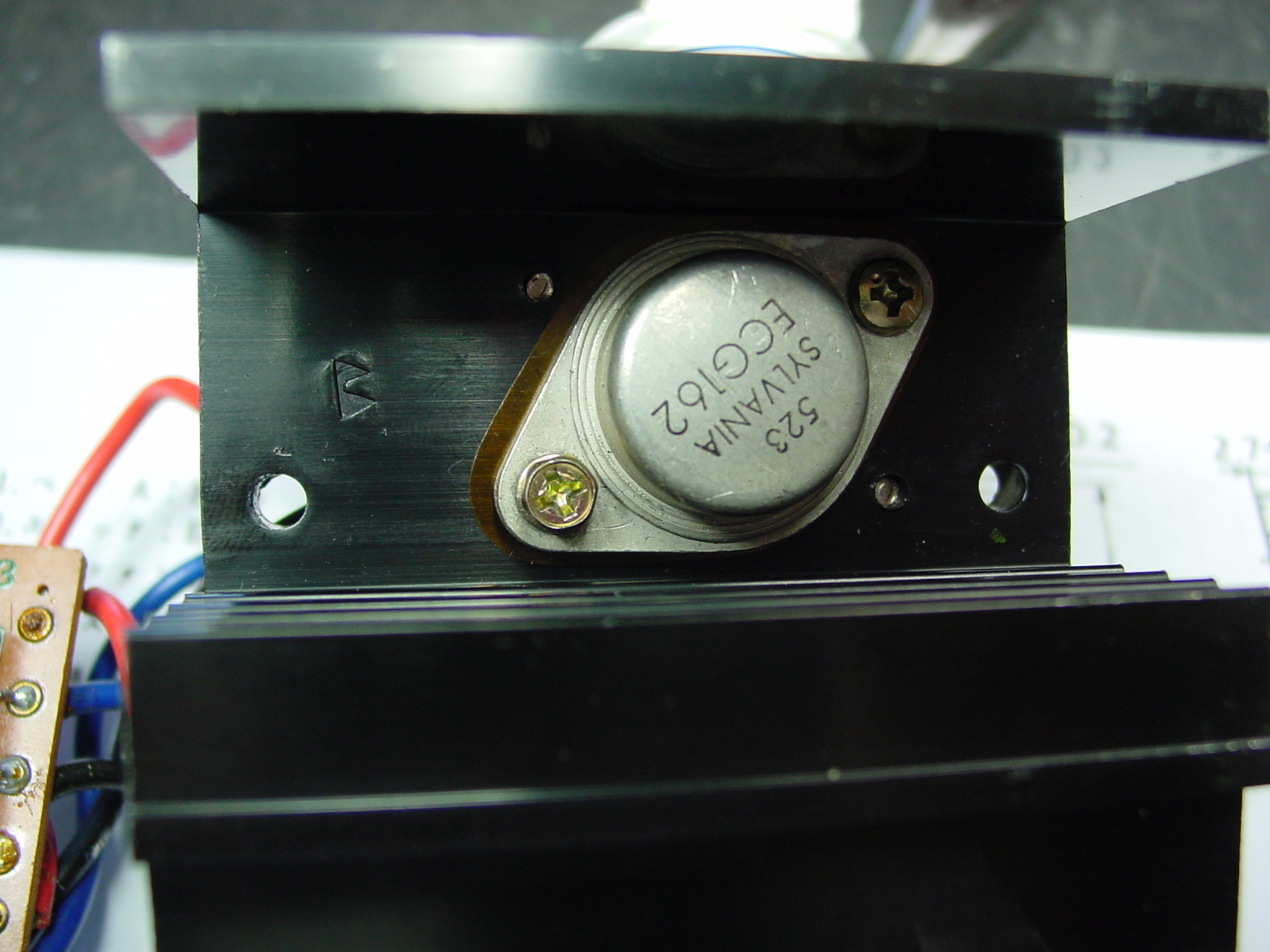

---Mixing up semis especially in the output section is a very bad practice and will eventually end up to some kind of fail or bad performance
---Using Sylvania outputs is even worst practice
This is all I had in hand, probably from another Sansui or Marantz of similar vintage. So far so good, not sure why the Sylvanias could be so bad
---To be sure of what you 've done you need to scope the amp and make extensive tests . often circuits behind the drivers for this style of amplifiers and geriatric semis DO NOT have the ability to drive properly modern TO220 semis ...
I failed to mention that I did replace the input transistors to Fairchild Semiconductors...if I have spare time in the future, I may scope to see what I am hearing.

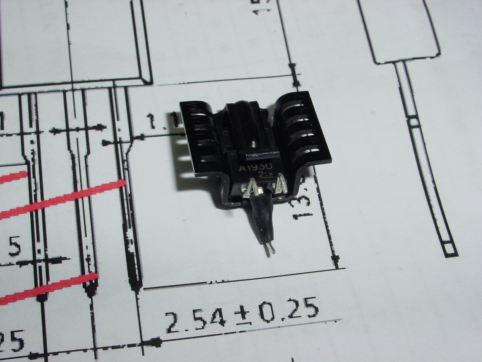

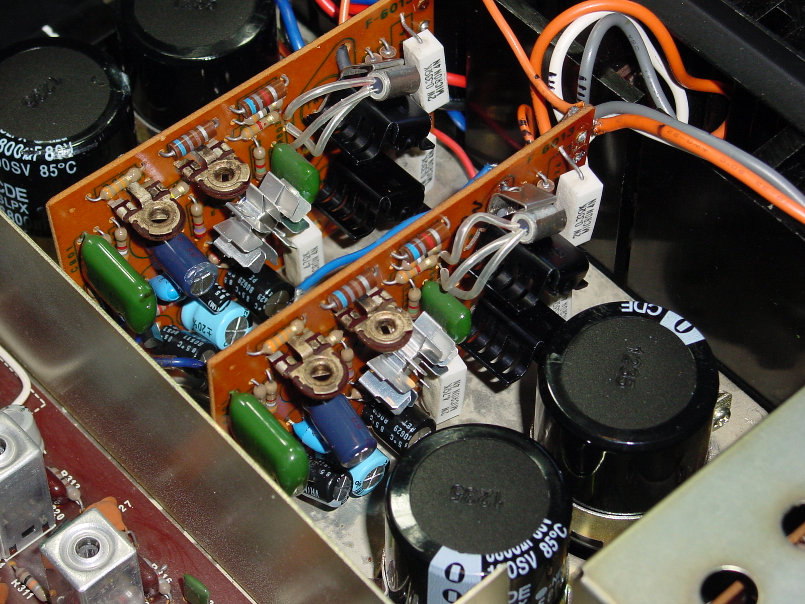

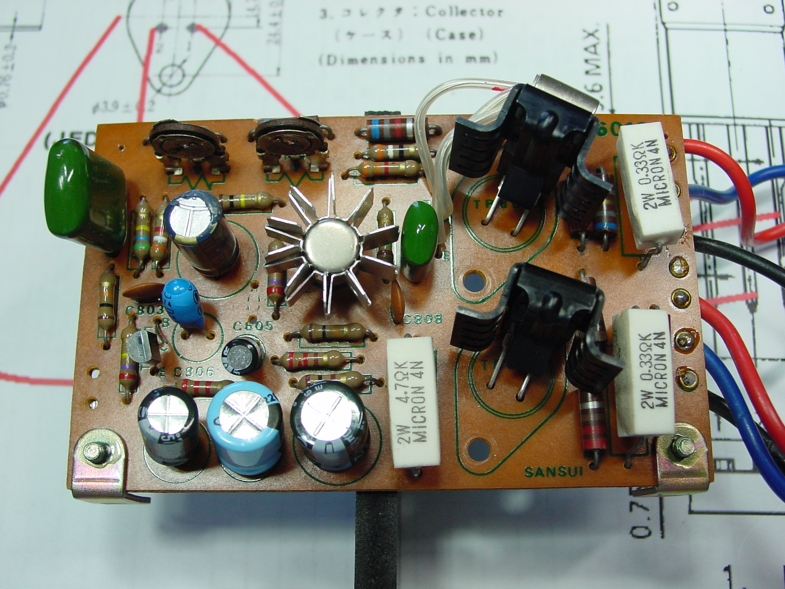

What is confusing me very much is that looking schematics of 5000A and 5000x seems to be that both of the drivers are NPN am I missing something here ?
These are PNP/NPN complimentary pairs before and after (see pics).
what saves your a** at this point is that amplifier is capacitor coupled and if something goes wrong there is no chance that will come out on the speaker ...
The capacitors have been doing nothing to protect my speakers, the fuses did and I saw it in action. These capacitors actually store energy and released it upon my unsuspecting speakers as a big pop or even a spark as I was hooking them up, even with the unit off. If you keep the speakers connected, then the load drains the capacitors as you turn the unit off. But if you turn the unit on without the speakers connected, you have a surprise waiting for you when you go to connect your speakers :D
Looking at your rather dirty trimmers located in the exact same position with the opposite channel reminds me of ""kids practice "" when the dont know how to set up the amplifier properly set trimmers in about middle position and if the amplifier sounds work alike in the other channel ...
These trimpots are probably silver plated, so that is why they look dirty. I hear silver oxide is conductive?... and starting things off in the middle might be more for safety sake than anything else. They are not in the middle and were never there that I am aware of.
There is absolutely no chance that trimmers have equal settings in both of the amplifiers ....]
The multimeter was used to bring both sides to the same/equal voltages.
the transistors originally exist on the amplifier have a ft of 20 MHZ what makes you think that a 200MHZ transistor is a drop in replacement ????....200MHZ transistor might work and even sound better but NOT as a drop in replacement it will probably require some extra compensation
100 MHz vs. 200 MHz is close enough, no?
Hope this sheds some light on the subject, not trying to start an argument.
Thanks.

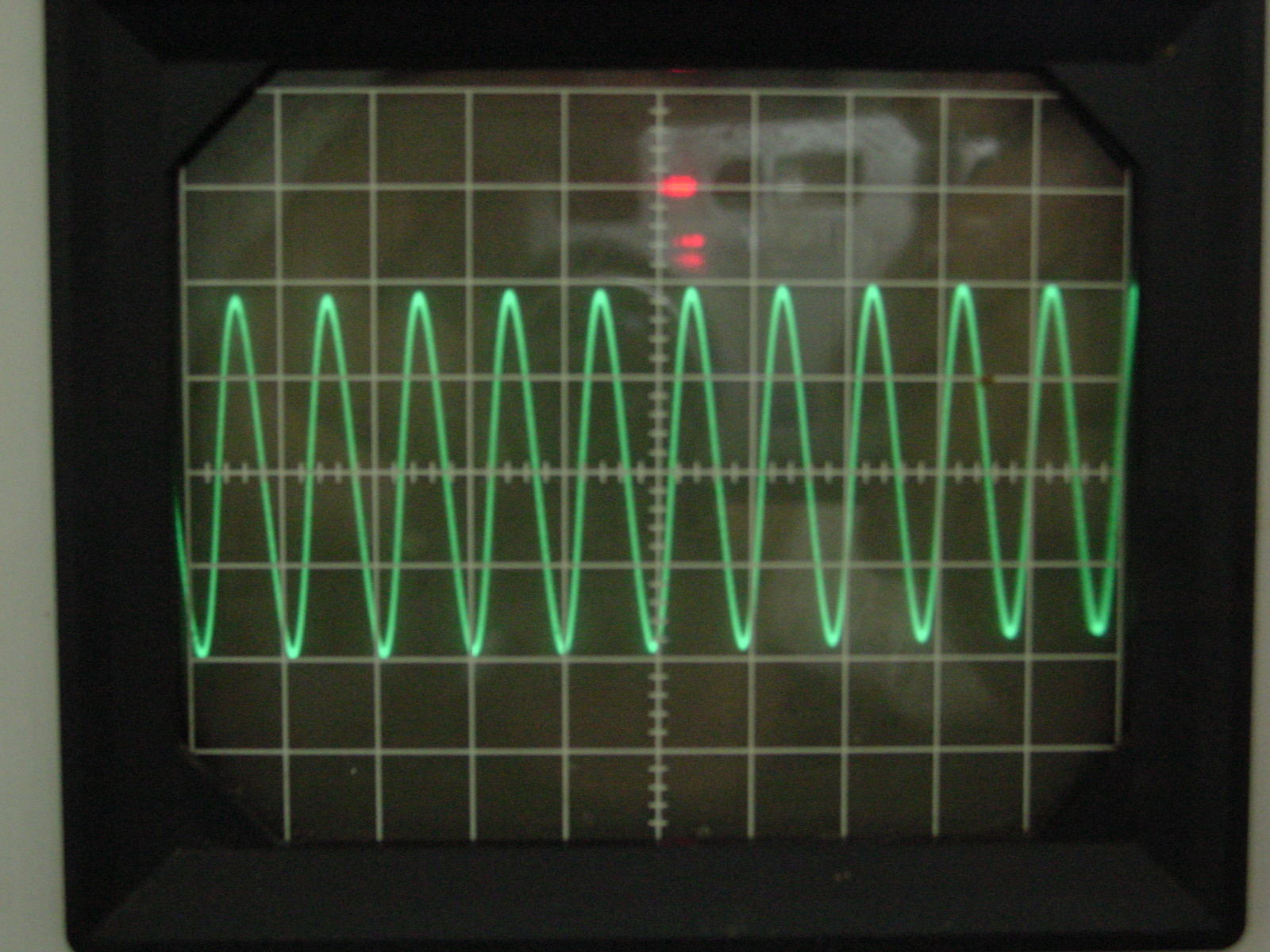

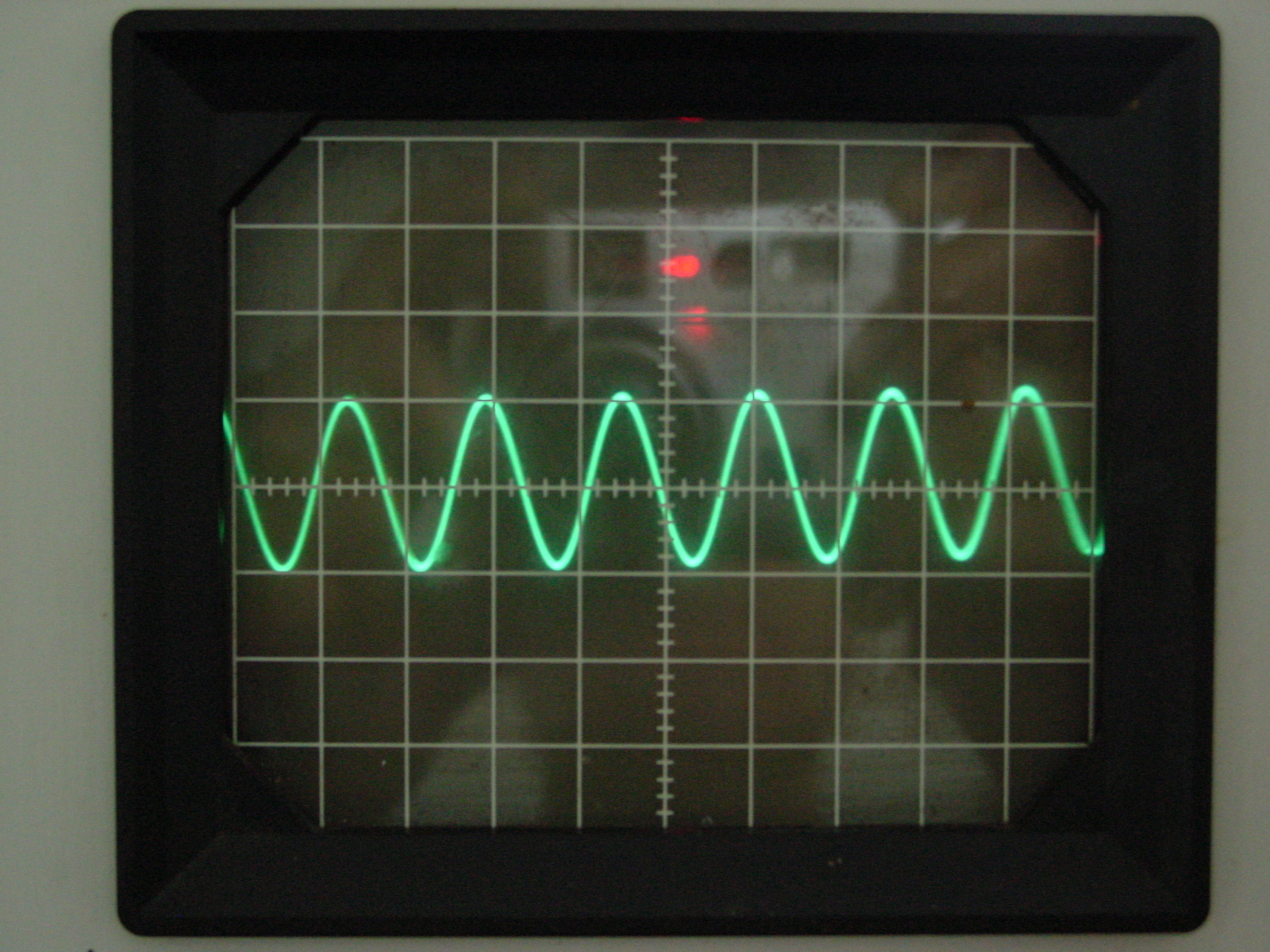

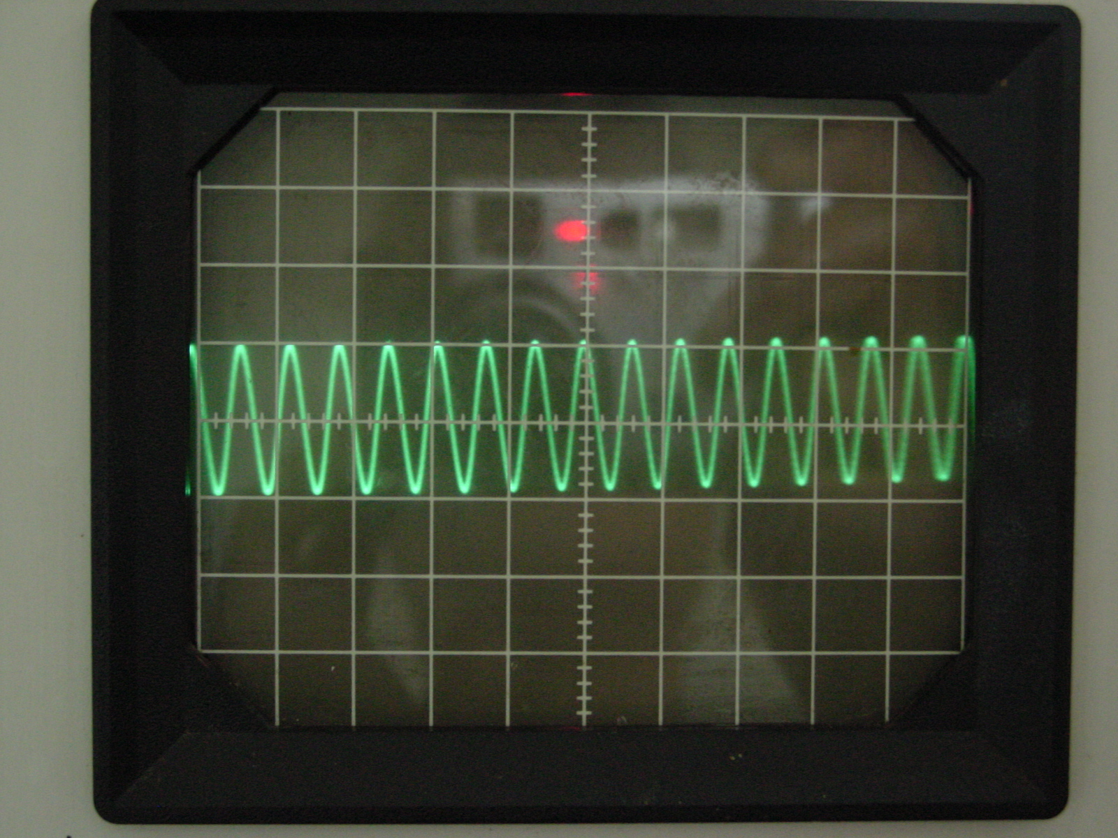

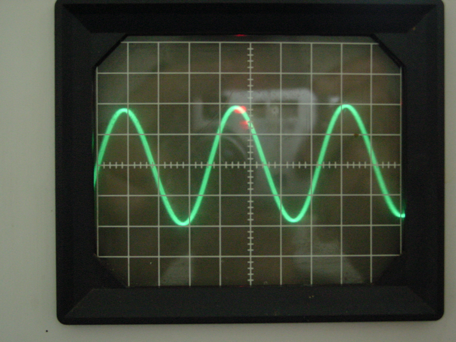

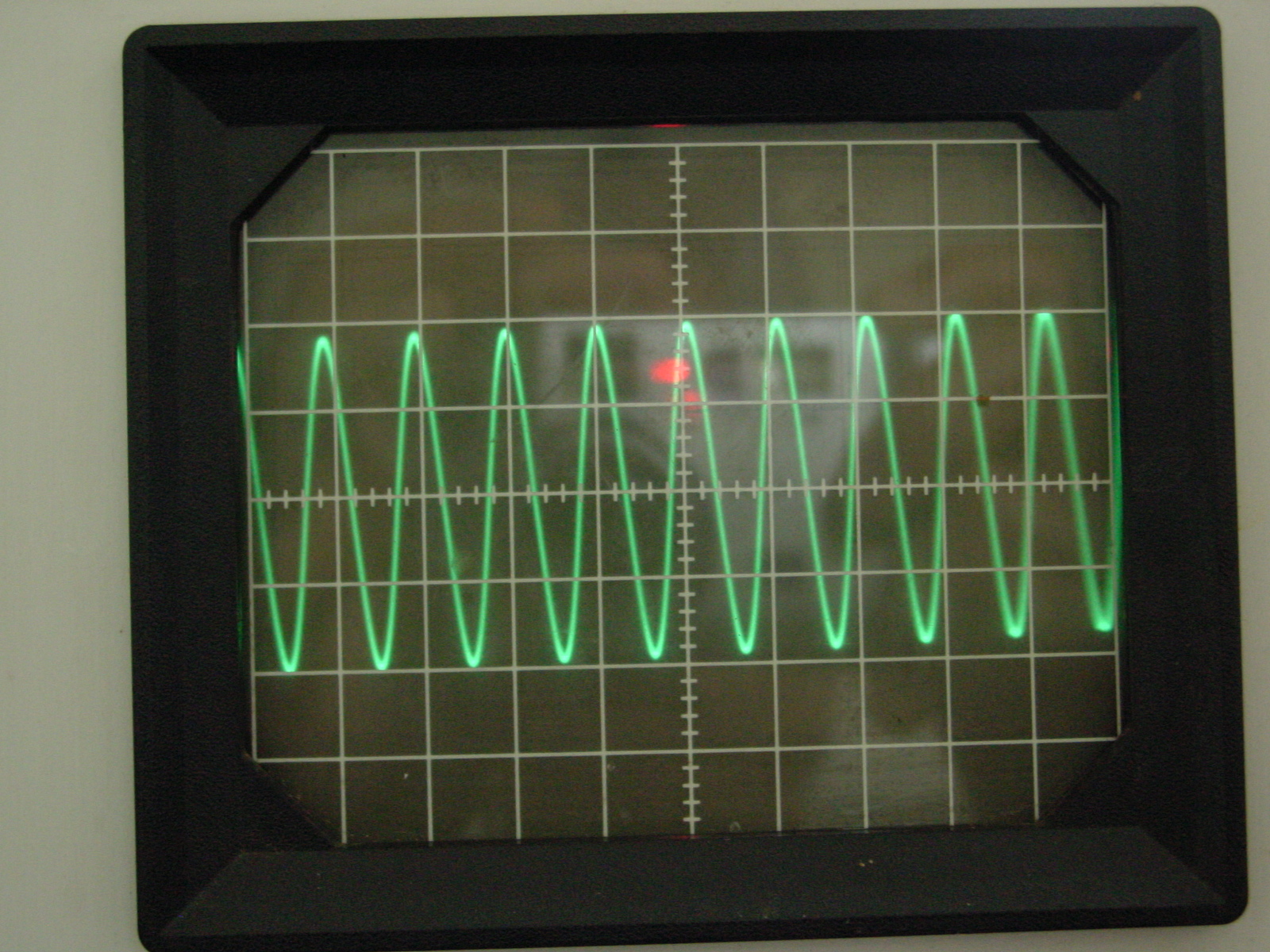

This afternoon, I ran some test tones through the Sansui and read them on the oscilloscope. The pictures below represent the right channel pics 1,2,3: 500, 1250, and 8000 Hz tones. Pictures 4, 5, and 6 are the left channel, same frequencies.
The difference in the waves is due to changes in the settings of the scope. The grid on the scope is crooked as well, or the tube inside.
