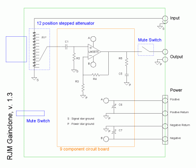

Using the same schematic as alvinlim (RJM v1.3) (i.e. all same values/components) I have 87.7mV offset when the amp is warm. To measure this, I am placing a 10.3 ohm resistor across the output with nothing across the input. R2 is 22.03K ohm and R4 is 22.05K ohm, so they seem fairly well matched, and I was under the impression that this was the source of DC offset. There seems to be a lot of troubleshooting info for the inverting GC, but the non-inverting version has less info. Also, when wiring up the chip, I made a bad connection and it would not work and got hot pretty quick the first time I fired it up, so there is the possibility of internal damage, although I hear no audible problems when listening to it.
Where else should I look to correct this problem? I am thinking it might be time to hook up the scope to see if it is oscillation, but I'm not sure what would cause this. I plan on using the same 10.3 ohm resistor across the output and no input to view this on an old Tek 20MHz scope. Is this the correct procedure for detecting the oscillation?

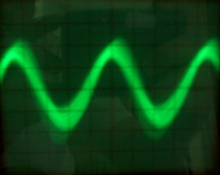

Attached is the pic of my Tek 465 reading the RJM Gainclone I built with no input connected and a 10.3 ohm resistor across the output. The signal seemed fairly noisy as well and what is seen is a well focused CRT with a lot of variation.
The scope was set at 10mV/div, so it appears that the magnitude is roughly 50mV. The time/div was set to .2us, and at roughly 4.5 divisions, the resulting peak to peak time is 9us, approximately, which would be around 100kHz. I guess this is the high frequency oscillation that victimizes some clones.
Does this analysis seem correct? Are there any other tests which would be appropriate to run?

If time base is 0.2uS then 4,5 divs resulting with ca 1MHz oscillation.
Did you insert Zobel network?
Did you try with decoupling cap (ca 1uF or so) between power pins ("1" and "4")?

About the offset: R2 should be close to R3 (or the value of R3 and R4 in parallel, which is 1/(1/R3+1/R4) = R3R4/(R3+R4).
Oscillation seems to happen always if gain is less than 10 (not the case here).Things like HF fluorescent light and computer monitors can cause small oscillations. Putting capacitors close to the chip is always a good idea.

The schematic used was the non-inverting RJM v1.3 schematic as attached with no additional components used.

Assuming that I might have screwed up the LM3875 by miswiring it, I replaced it with a second chip. DC offset is now 116mV!!!
I checked the oscillation on my scope and it appeared to be the same, possibly with a higher peak to peak. Thinking it could be the cheap pot, I soldered a 44kOhm resistor in series with the input, bypassing the pot altogether. No change.
Then, assuming it could be a problem with my scope probes, I tried a second probe, but it did not respond well during calibration, so I was not feeling good about it. But, I tried it and the oscillation was gone, but noise was very random. I switched back to my first probe and the oscillation was gone again. I am starting to question the accuracy of my measurement system.
My next logical step will be to check the amp, as is, on a scope at work with certified probes. Regardless of the outcome, there still seems to be a large offset. Assuming the oscillation is not actual and is a phenomenon of my scope or probe, I will likely start from scratch with new components, measured carefully and go back to the original schematic, in case I made a yet to be discovered wiring error, paying close attention to the grounding scheme. If this does not solve the problem, I will see if there is a power supply variation I can try without spending too much money.

Some suggestions (inspired by your "clear" picture):
- place zobel R5/C5 on output terminals
- get input cap wire as far away as possible from + output terminal (bend up) (you use noninverting setup which is sensitive to closing input and output wires)
- insert (just to check offset voltage) a cap (ca 100uF) in series with R3 to gnd.
Scope probe has some capacitance; occasionally (RF circuits) this can attenuate signal too much or cause circuit to oscillate. In your case this is not likely, IMHO.
What are you using noninverting setup for in the first place?

OK I think I know where your offset is comming from. The input bias current of the LM3875 is 0.2uA. Using the info given above the impedance on the inverting input is 520R and on the non inverting one 22K. Using V=IR this gives an input voltage of 520x0.2uA on one input (104uV) and 22Kx0.2uA on the other (4.4mV). Subtract one from the other to find the input ofset due to the input bias current (4.296mV) multiply by the gain of the amplifier (I am guessing about 22) gives 94mV.
The input bias can easly vairy by a factor of 5 so both of your chips were operating well within tolerance. Normally you will get no problems from offset on an amplifier below about 500mV much more than that and it might cause a significant bit of heating in the voice coil of the base driver. Still not much though.
Hope this helps. I think my calculations are correct but I am happy to be corrected if I have missed something.
Andy

I mean that you can multiply the values of both R3 and R4 so that R3 is something like 10k, and R4 about 220k. Then you should get smaller offset. Also R2 could be 10k.
I copied the formula from this page:
http://www.platenspeler.com/gainclone.html
The idea is to control bias current flowing into input transistor base. If the current is same for both inputs, there is very little offset. The offset could be adjusted by trimmer resistor R2. I'm planning to use offset trimmer in my next LM3875 design.

A sure-fire way to drop the offset by a factor of 20 is to put a cap in the ground-side of the bottom feedback resistor. That makes the DC gain x1 instead of x20.
Make sure the cap is large enough for good bass, meaning the RC product of the lower feedback resistor and the cap should be at least some 100msec.

ukram said:The idea is to control bias current flowing into input transistor base. If the current is same for both inputs, there is very little offset. The offset could be adjusted by trimmer resistor R2. I'm planning to use offset trimmer in my next LM3875 design.
you are absolutely correct with regards to why R2 is needed, and the guideline above can be used to select R2 (usually it is selected as the same value as R3.
However, a few other considerations here:
1) R2 cannot be too large. Otherwise, it picks up noise. This is especially important for non-inverting implementations as the (theoretical) input impendence on the non-inverting end is infinite.
2) simply grounding the non-inverting end gives the best THD+N performance.
National suggested a 3.3K for R3 but admitted that it may not be optimal. My sense is that as long as you don't venture into >50K range, it should be OK.
