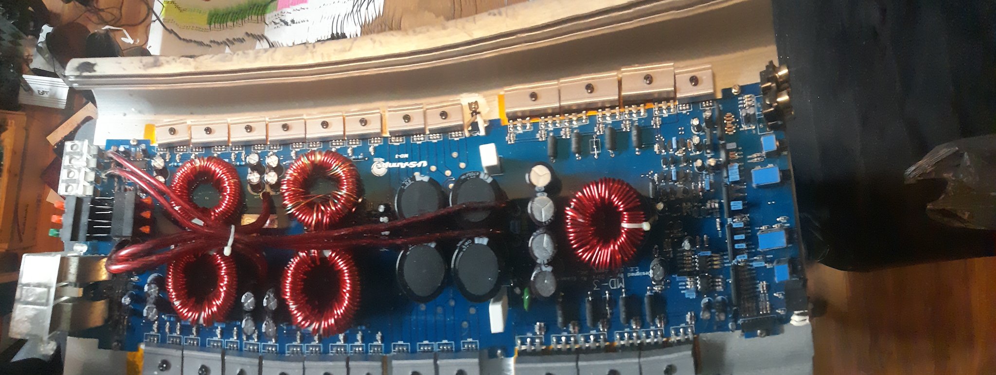

I am trying to fix the US amp Merlin md3d amplifier that I believe it to be a Class A B. If I put one Probe on either the B+ and then the other probe anywhere else in the board it measures 12 volts. if I take that probe off and put it on the remote terminal the same thing occurs...... 12 volts everywhere. if I switch the probes in the opposite direction it shows negative 12 volts. I do not remember getting any other voltage reading other than 12 volts. anywhere I measure whether it be the power transistors, either side of the Transformers, all three legs of the transistors, i mean everywhere 12 volts. ...everywhere.

On most car amps the fuses are on the main 12V feed so they are usually live all the time. They are normally parallel to each other in circuit. The remote trigger usually switches on the SMPS, no relay involved. I suggested he post some pictures so we can verify this.They are not even getting supply voltage since each measures 0V on both ends.

If I need To take better pictures or get a closer up Shot just let me know
