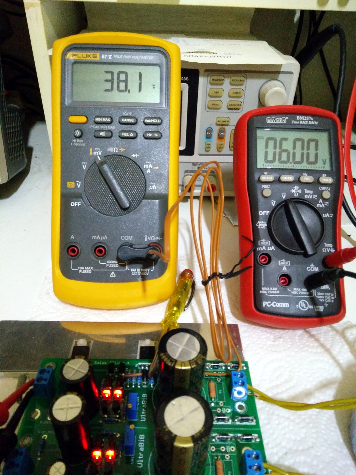

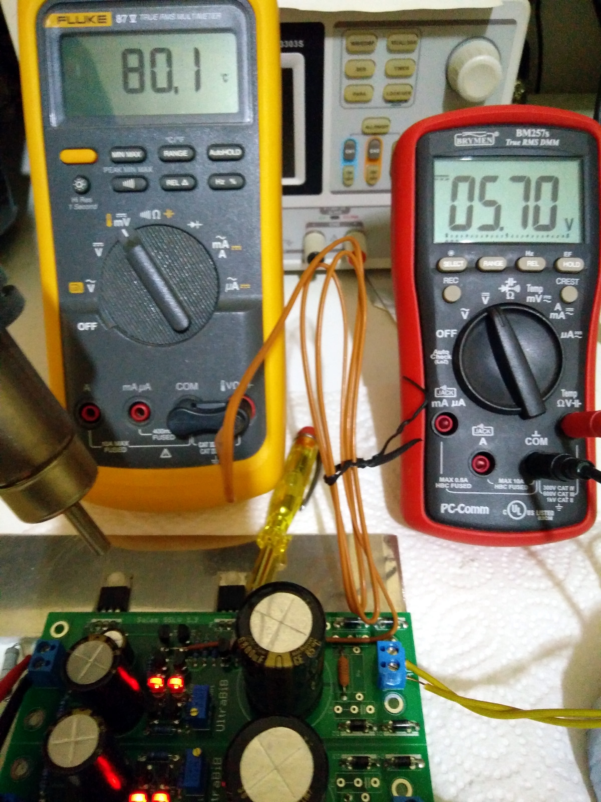

See it here doing just 0.3V drift difference over a 80.1-38.1=42C temperature delta. Which is not bad for a so simple Vref design.

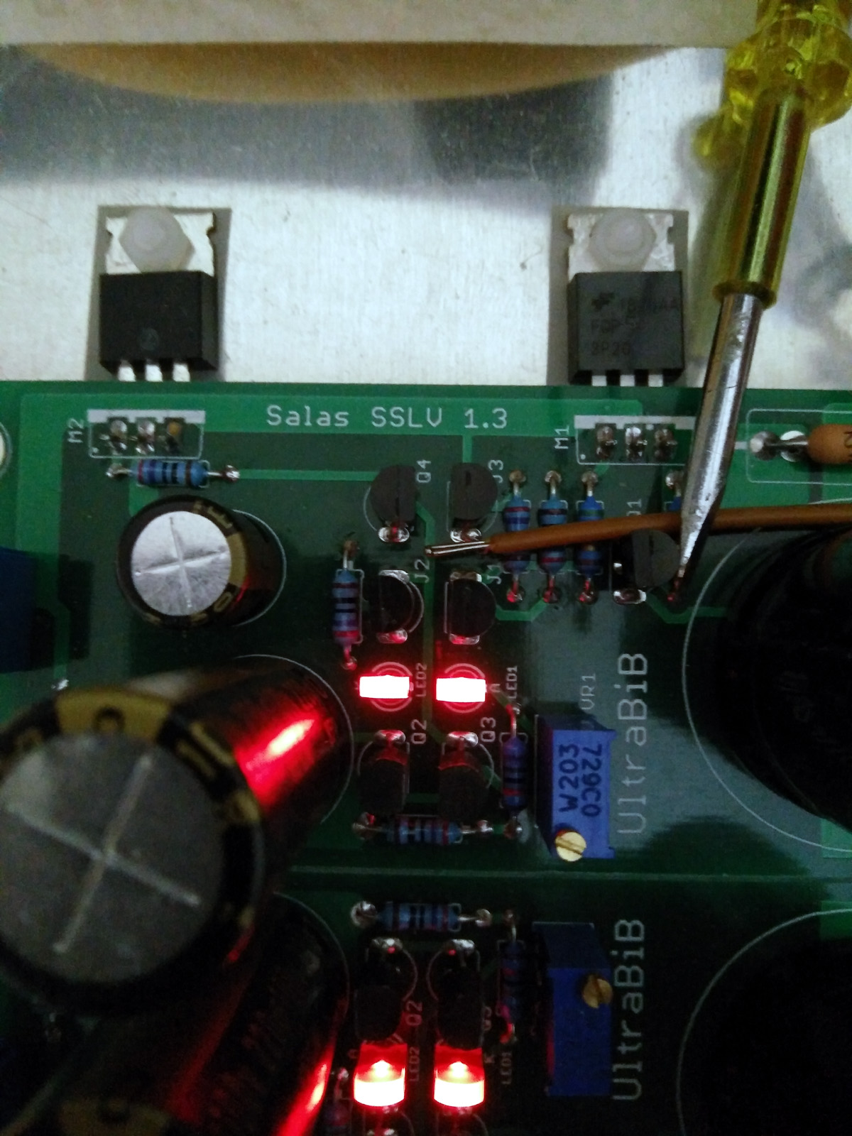

The Fluke's temperature probe is sat right at the drift affecting transistors area. Using a hot air rework station's help to heat up.
42C ambient delta in an audio source or line level electronics box is not common at all. It will see 10-20C ambient temp in-box deltas at most home installed builds. There it will do smaller Vout drift from the just powered on moment to fully warmed up. Say 10.1V to 10.15V at power on will end up 10V steady when warmed up. Even such difference can be taken into account when setting up. Set it when in just started up state than in warmed up state if its for a borderline safety situation. If there is a much special reason the trimmer can be skipped and the Vrr resistor be replaced with a Zener (noisier, harsher) for a fixed voltage situation after all.
