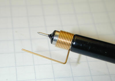

Hi there,
I just finished building your SSLV 1.3 (for a BA-3 pre) but it somehow doesn't work properly. I ordered the kit from Tea-Bag and assembled one pos. and one neg. rail.
Resistors are Vishay 1% 0.6W 50ppm and C1 are Nichicon 6800uF 50V
R1 are 3Ohm (200mA)
I'm using a 2x30V 50VA toroidal and 24V as Vout.
My problem is that I get a Vpp of ~100mV (measured with my scope) on both rails no matter whether there's a load connected.
Any ideas?

But DC wise it behaves setting normally? What is the Vpp frequency? 50Hz? If so it could be hum picked up by the probe's ground clip. Measure with a short ground probe tip right at the DC output terminal. Is it 100Hz? Then there must be something wrong inside that lets the rectification ripple pass. Is it a weird shape like distorted triangular in several kHz or in some MHz? Then its oscillation. Does C2 have the right value and ESR? Is there a picture of the whole system assembly?
So it was ringing or some component was pushed. There is 33VAC max mentioned in the instructions. Nice that J1 did not break. How did you lower it? With a power resistor and it damped out? Or you changed transformer?
For 24VDC a 24VAC input would be adequate and saves on M1 dissipation. There is the anti-ringing snubber components option on the board also, but it takes a Quasimodo device to tune it properly. When working within spec and set up right its capable of very good results on the scope indeed.

Sounds reasonable. I guess J1 was at its absolute limit.
Yeah, I grabbed a transformer I had lying around which had only 25VAC and the noise was gone. But it only had one rail so I lowered the other's input with a variac and voila, both rails quiet.
