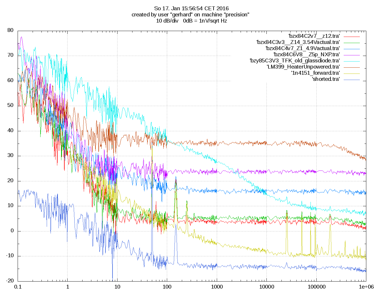

There was one noise test done by a forum member about the noise comparision with a 12V zener with LEDs and when measured the 12V zener had the lowest noise than the string of LEDs. I agree the fact that other voltage level zeners have much higher noise than the LEDs but I believe 12V zener is the best in noise compared to LED string ( atleast in Bib 1.1 )? Whats your opinion salas?
Maybe it was a special TC compensated Zener. Read this old but good article: http://mirror.thelifeofkenneth.com/lib/electronics_archive/Noise_Behaviour_of_Zener_Diodes.pdf
I found this on the forum about a member has posted about the Noise measurements he has made with both zeners and LEDs. Especially if you look at 12V Zener that has lower noise than an LED
Noise measurements for LEDs and zener diodes
My experiences with high gain zero PSRR phono stages and PSUs is that their signal output FFT grass was bumping up a lot when I tried a Zener as unity gain Vref instead of LEDs or resistor (@ >20V rails). Anyways, you could try alternatives in the PSU for yourself. By the way, member Gerhard's very careful wide bandwidth FFT noise tests should be also considered.
Hi salas,
I agree the fact about other zeners. Consider if you are using 12V zener as per the measurements above and also the string of Red LEDs which are about 5 in numbers in series so which one will give more noise?

No, I used >20V voltage Zeners in those phono PSUs tests as I wrote. If that BZX85-C12 is so great an exception of an avalanche mode Zener I should get a few and try in some sensitive application on first chance. There can be more than one in series for higher Vz after all.
