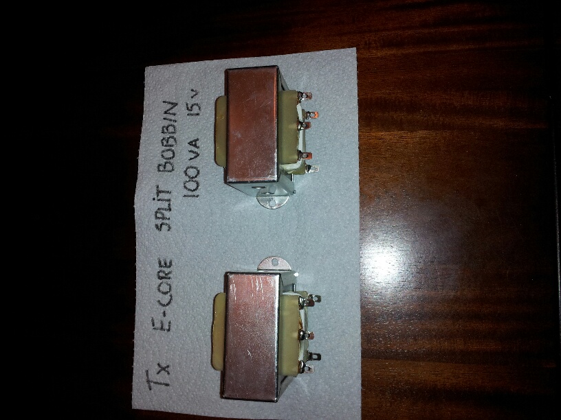

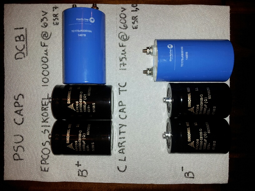

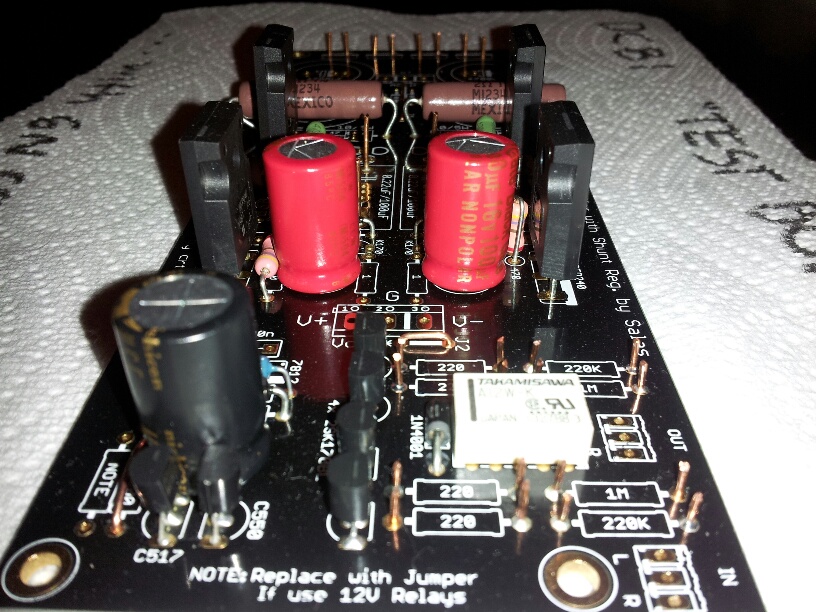

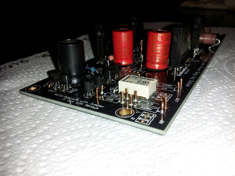

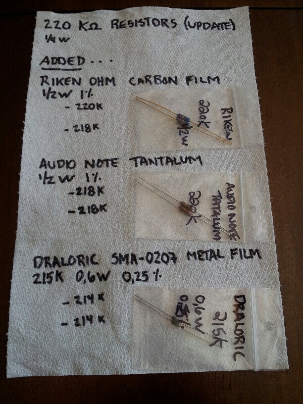

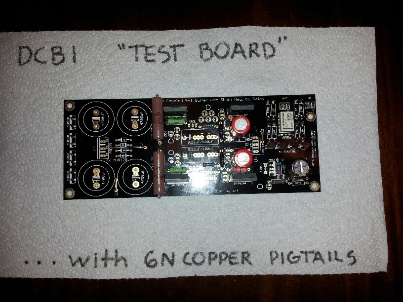

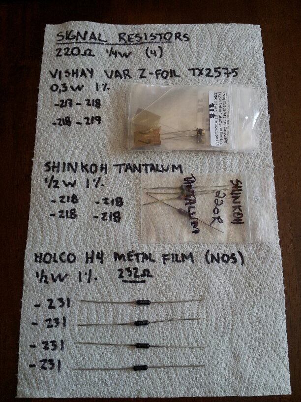

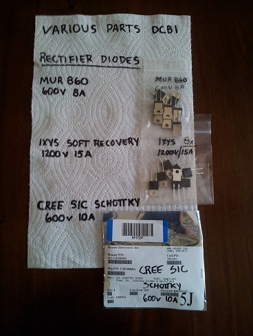

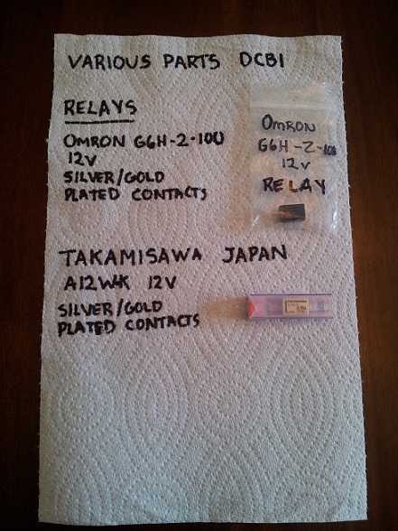

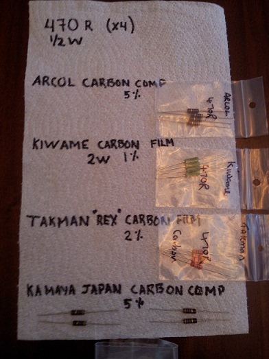

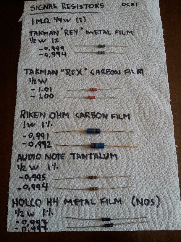

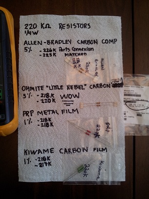

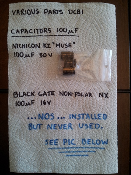

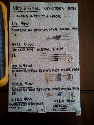

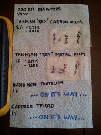

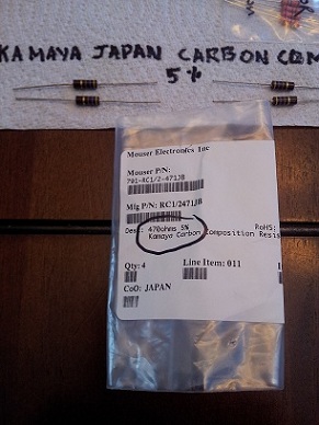

Ok, here are the first pics...I KNOW THE 470R ARE NOT IN THE SIGNAL...MY MISTAKE...but since they were bought...

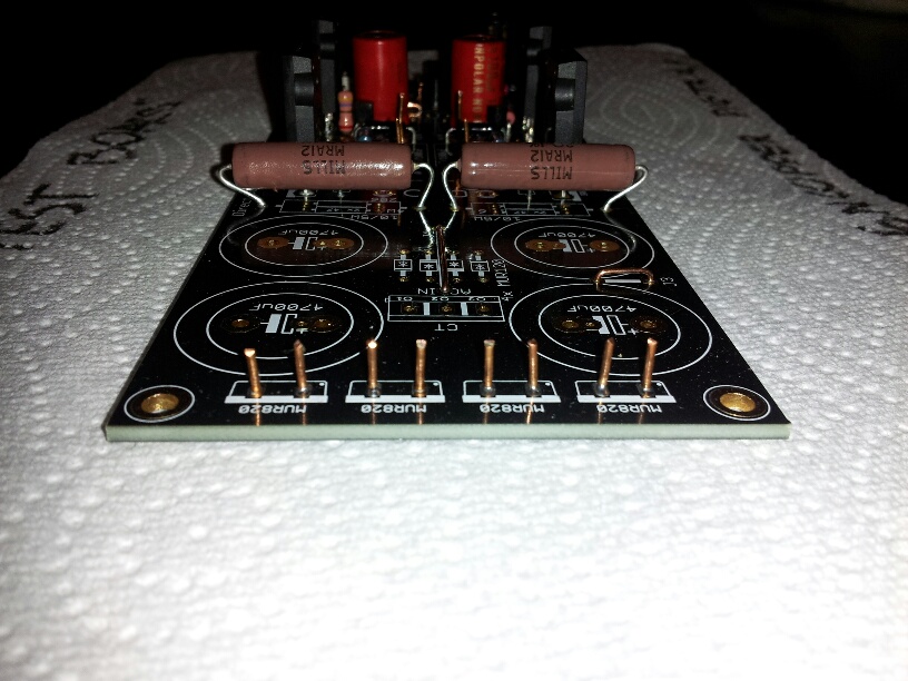

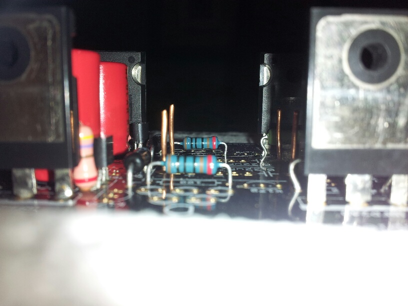

And some pics of the ''Test Board'' with the copper pigtails...some components still not installed (not received).
Sorry if the pics are not very good. I really s*** at taking pictures.
Regards
Scorpion

What?! No Vishay nudes?
Hi BigE
Yep...see pics above. I have Vishays Naked Z-Foil Tx-2575 at the 220R position.
Going to compare them to Shinkoh Tantalums (among others).
Regards
Marc-André
Stocking up I see. You will write the "Scorpion BOM with notes" in the end of your experiments I presume. So any aspiring "Deluxe DCB1" builder could use it as a subjective compass.

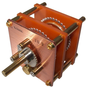

Btw, I am having a very hard time choosing between different stepped attenuators (also vs pots). I was told I needed between 10k-20k. I guess, you already figured by now that I don't want to skip on quality but I still can't decide wich one would be best between these (soundwise AND price/quality ratio)...
I would like to go dual-mono.
Here are a few stepped atts I had my eyes on:
- Shallco 45 positions, shorting, dual-mono L-pad (@ Michael Percy)
- TKD 40 positions, mono stepped attenuator (@ Michael Percy)
- Seiden 34 or 46 positions, shorting, 2-pole, rotary switch (@ Parts Connexion)
Please feel free to send advice. Any other suggestions are welcome.

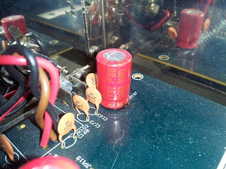

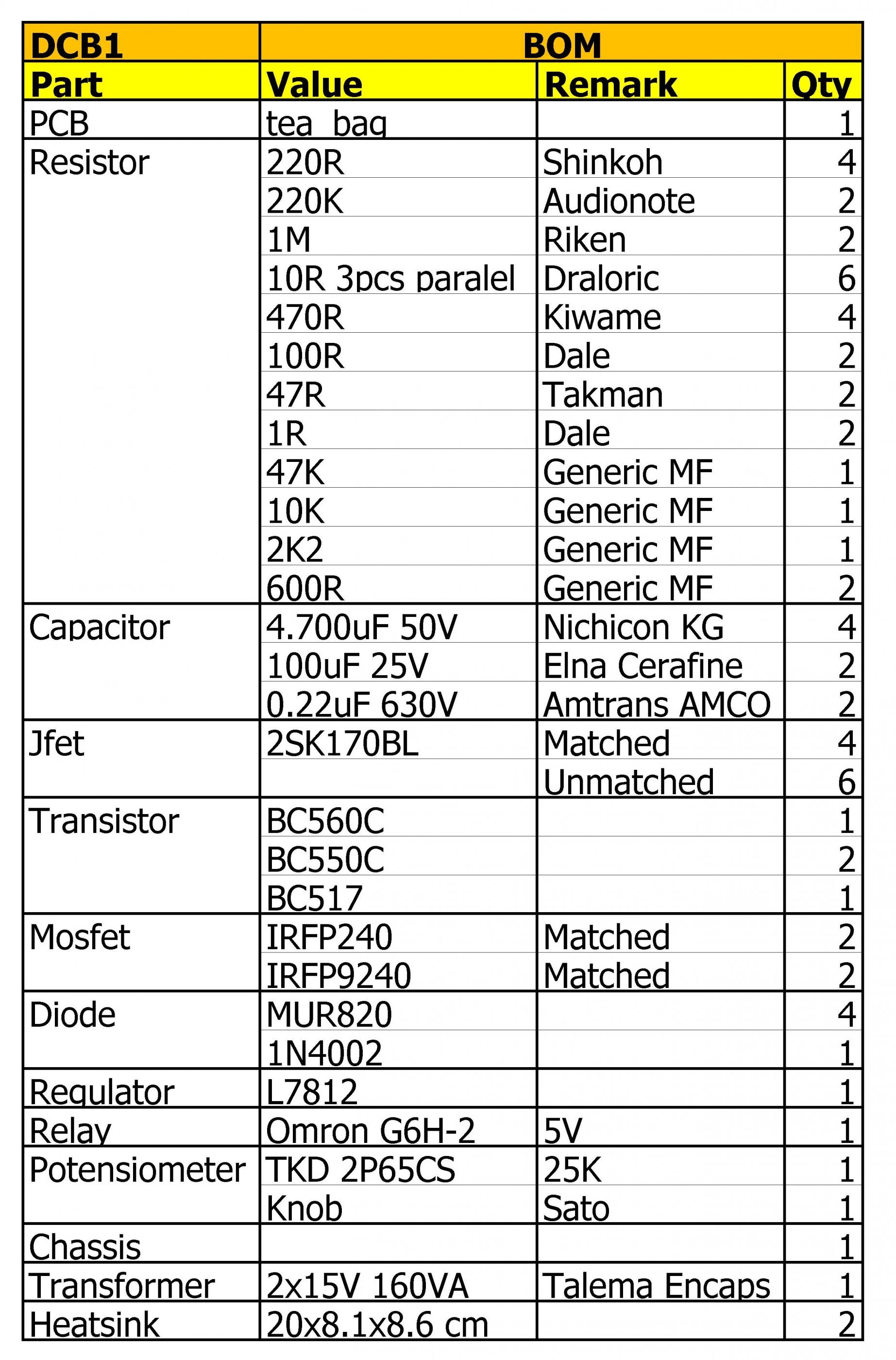

Wow, amazing effort that you've done which remind me of my past journey. after completing my_refC, I also had the same spirit to build 'my style DCB1 parts', but after reading whole audio chain project, I decided to directly choose audiograde parts instead of trying 1by1 as you do. I can't imagine the permutation of each parts on my diy audio chain if it's done with your approach:
audio source (not sure yet) -> DAC AD1865+tube pre -> DCB1 -> AlephJ
maybe most difficult effort for me, build chassis and good layout which also consume trial and error, where my dcb1 chassis is still not final yet until now.
my parts selection attached, not as massive as yours. and if someday you are bored with those Z-foil+BG N, just let me know
can't wait to read your listening results

Hi Gadut,
Thanks for the comments. You chose excellent components all around. How do you like the sound of your DCB1 ? How would you describe it?
We are going to have some differences though at the very end. I too went with a TKD stepped attenuator but I decided on 2 mono stepped atts @10k from Michael Percy. It is a bit of a gamble but I have read a lot on steps in the last days and the TKD comes frequently as one of the most musical and natural sounding on the market (even compared to Shallco 45 steps att.). According to reads, this musicality comes at the price of a slight loss of ultimate details....Personnaly, I am more than willing to trade extra details (wich I already have plenty enough) for musicality. Music first. Don't want to end up being distracted by too much details.
Of course, reading is one thing and listening is another. So my ears will be the final judges as to wheter the TKD is as good as reported. Seiden seemed excellent too, but, going 2 monos + resistors would set me back close to 1 Grand...too much $$ for me.
Other differences is that I will have 2 TX (100 Va X 2) and seperate PSU. And I will go with 2 ohms@12 watts Mills for CCS resistors so this thing will run very hot !!! This is for the " test board" as I have Mills MRA-12 1,25 ohms for my final board !!
I ordered huge custom heatsinks from HeatsinkUSA in order to be able to deal with the heat. Heat will be further dissipated through the aluminum enclosure (5/16" thick all around).
Btw, guies do you think I would need extra heatsinks for the MUR860 (or IXYS Hexfred or CREE Schottky) if I am to use 2ohms (or 1,25ohms).
Better be safe than sorry.

Yes, I would sink the diodes at that level.

That's what I thought (about sinking the diodes) but was not sure it was needed.
