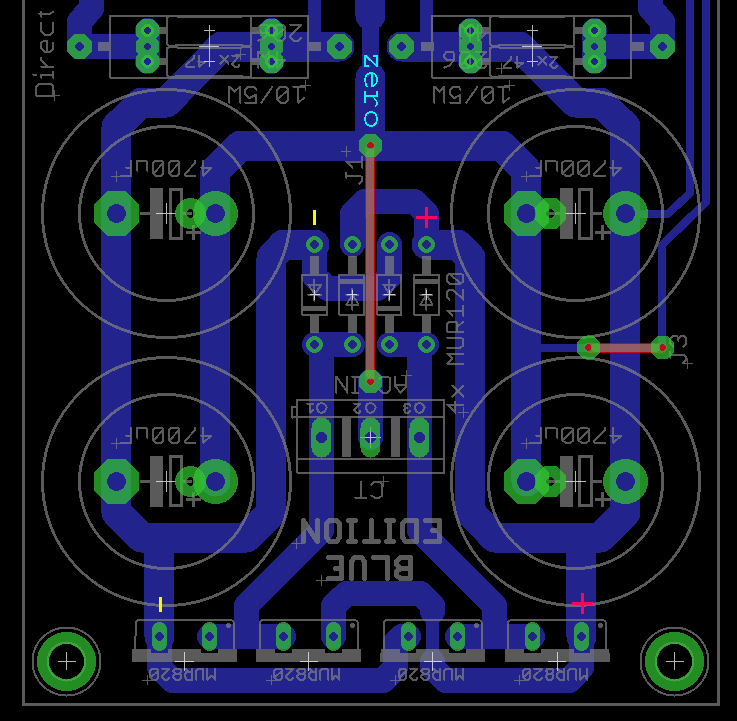

All lights are on. Alright, good start. Are those AC figures measured when the transformers are loaded (connected to dcb1)? Or its about the DC rectified you get? BTW you can measure raw DC on points at the top of the board also, not only at the pins of the big filter capacitors underneath.

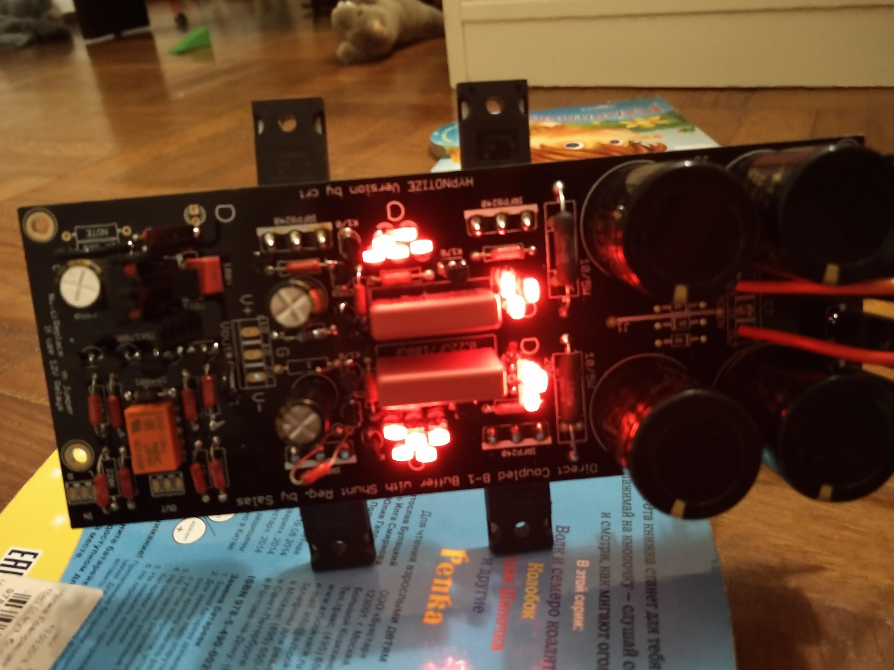

Powered up my Hot Rod Mezmerize DCB1 today and I'm afraid the CCS is running quite a bit lower than what I would expect.
Measurements as follows:
LED's all matched at 1.9Vf
Bank of 3= 5.7v
Bank of 5=9.5v
R1=single 7w 3r3 ohm resistor per side
+Rail tests at 10.59vdc
-Rail tests at -10.13
Vdrop across R1
+ Rail=1.54v
- Rail=1.52v
With my resistor, that puts me at ~465mA vs expected 600mA
I think it should be closer to 2v on the vdrop. Is it because my Vf is a little high?
Also, my power transformer is an EI, 14-0-14 rated to 4amps but it runs warm. After 30 minutes on, it's running about 20 degrees C above ambient. Maybe that's fine, but I don't know enough to know if this is okay or maybe related to the reason my Vdrop is low.
Anything else needed to diagnose and fix the problem? Thanks everyone.

Your build responds normally. You would need green LEDS in the triplets with your particular MOSFET batch VGS in order to go nearer 2V Rdrop=VFtot-VGS but with your transformer being already warm I would suggest you stick with your now current level which is plenty anyway. And your resistors save some self heat. Your EI has less power efficiency than a donut but its a better mains filter and tolerates little DC component in distorted mains. 20C above ambient should be safe for an EI in long term use.

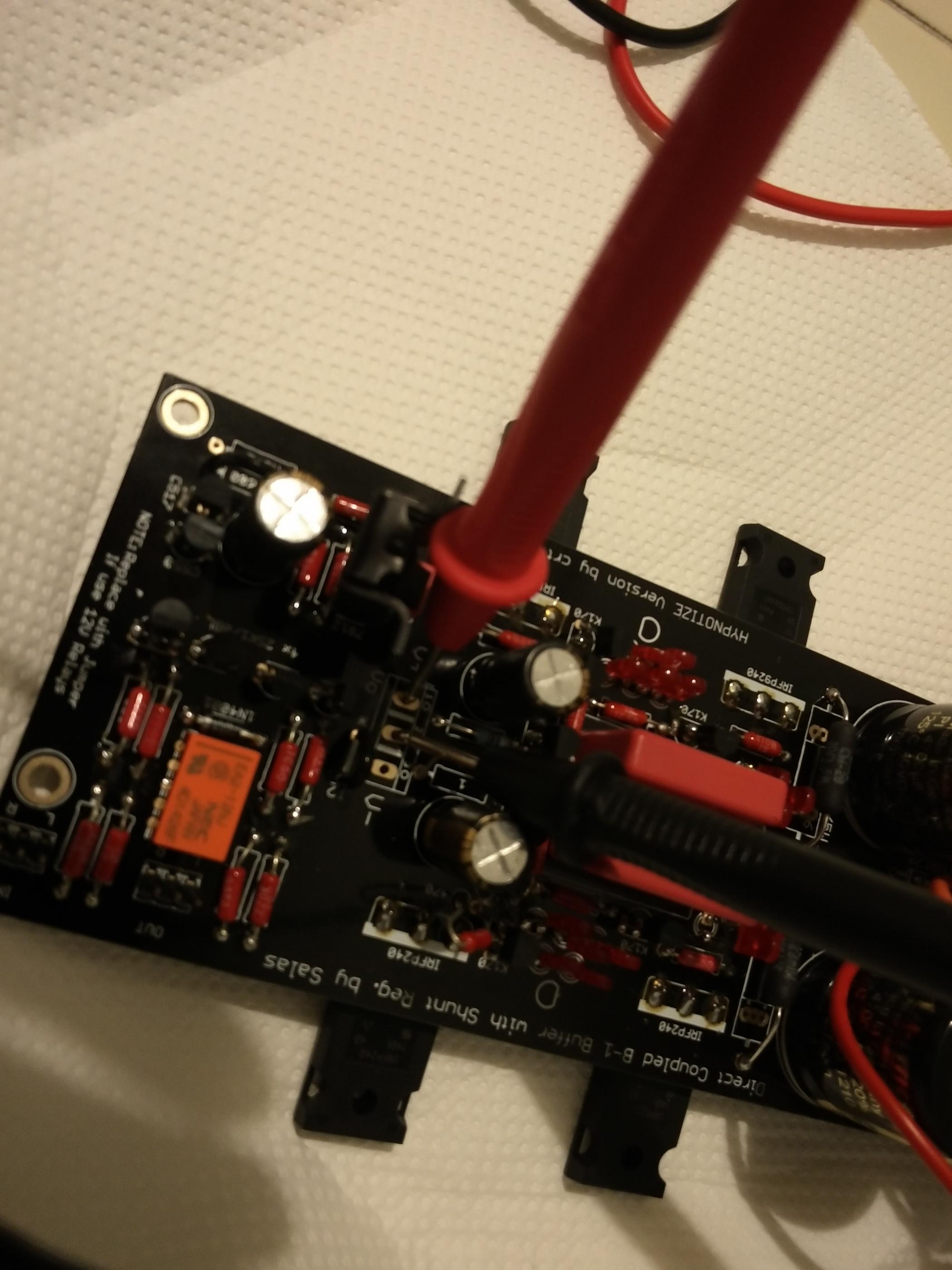

Hi Andrew thank you and I think it is all right.
I have double checked the series connections of secondaries on both Trafos and they are behaving like center tapped.

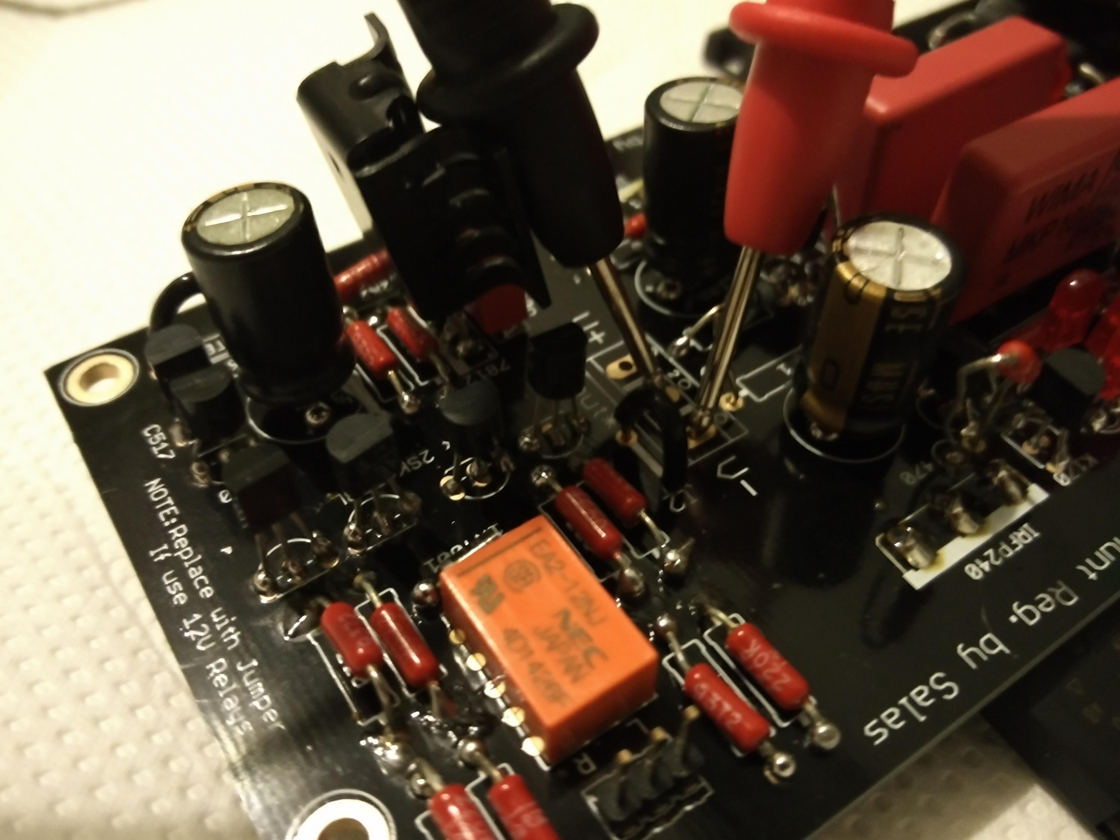

Measured the DC on the power output of the dcb1 today with no signal and no load. Photos attached I am getting +9.65 and -9.75
Should I check the output signal without load?
The raw supply is actually loaded by the four JFETS draw and the much higher CCS current that its shunted to ground. The signal swing will only make a very small difference to that state. That's the idea and a big contribution to the dcb1's performance. What is the rectified DC with what transformer at the points I showed you on the rectification side of the board? You can measure you DC offset at the signal outputs without anything else connected, as well as the voltage drop on the current setting resistors to derive the CCS current. If both are acceptable and the raw DC rectified level is 15V or more you are ready.
