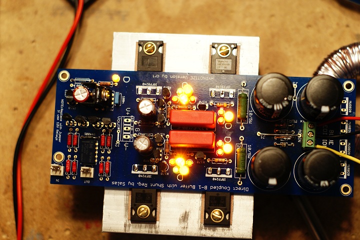

Finally got this thing powered up. I just got done with my Blame ES and started to finish mounting this on its heatsink. I went with Salas suggestion and just placed the 240/9240 pairs on one sink, After playing with heatsink configurations the 2 heatsinks really was overkill.
All thing lit up without any smoke.
I am getting 1.73/-1.49 across the 10r resistors. Output is 9.96v/-9.94v, I thinking this is due to the original 10r resistors being used and not the 8r2 as suggested by Salas. Is it ok at this voltage or should I use the 8r2.
I think all is ok, I just need to listen for relay click as suggested in build guide. I just received the 20k pot yesterday (SMD version that been recommended here) and need to assemble LDR volume control.

Looks like your Vgs in the CCS Mosets allows the 8R2 with ease, since your resistor voltage drop is on the conservative side. Maybe its due you got enough high input voltage with that overspec Tx. (Mosfets change Vgs a little with current and voltage and have own spec tolerance). But we have seen resistor voltage numbers between 1.5-2.1V many times in general for DCB1. Did you use the CRC dropping you were planning? How much is the DC on second capacitors, and most importantly how much is your DC offset mV on audio out? Looks nice carried on the sink that way.
P.S. Don't know the needs of the Teddy for its CCS, I would prefer it taps from TX to its own rectification and filter.

Salas, i did as you suggested the 39r are underneath the board and used the 10r in lieu of the 8r2 since the ones I had were 8k2 by mistake. The voltage of 2nd cap is 23v & -24.8v.
I'm not sure if this is the correct reading you want for the audio out offset, but I measured from ground to out and it is 0.002v.
Only using the teddy reg since I have boards on hand already built with few minor changes to resistor values, I would prefer the salas mini shunt and I do have the board from quangho but not the parts.

0.002V = 2mVI'm not sure if this is the correct reading you want for the audio out offset, but I measured from ground to out and it is 0.002v.
That is unusually high for a DCB1 build.
How accurate is the voltage scale of your DMM?
It is good to have a meter that can read 199.9mVdc and can also read 199.9mVac. these can be bought cheaply with <=+-0.5%+-1digit accuracy.
+-1%+-2digits should be very cheap and the worst you should buy.
One English guy using an optivol recommended taking out the local 317 and just using a v1 dedicated reg for that as his best, after he used it as pre reg even.
Your Vin is not bad for 35V filter caps. With 8R2 it will give more mA and drop also. But it works fine as for now. 2mV is good enough offset for no problems but it can go lower.
0.2mV is good. That offset is typical of well selected Idss pairs.
1.8mV is poor for a selected pair. This low output offset will not damage any following equipment.
