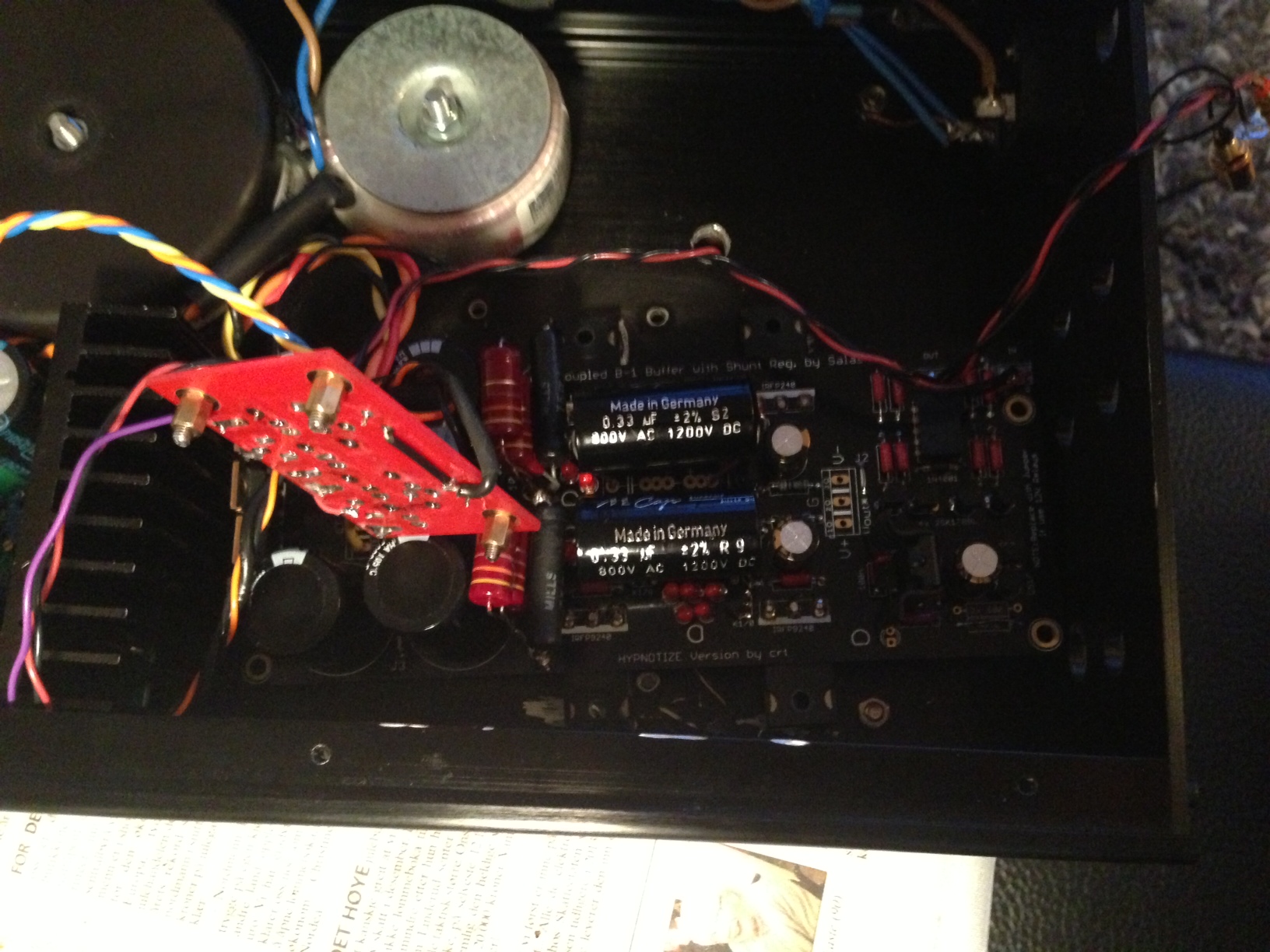

Thanks for the info. Fitted a couple of mundorf supreme silver/oil 0.33uf today.. Will see if that makes some change :) And also "hotrodded" a bit :)
Yes I know.. I have 3 of them in parallell right now and some mills.... to get close to the desired value...

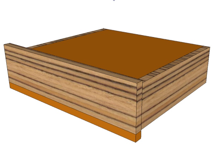

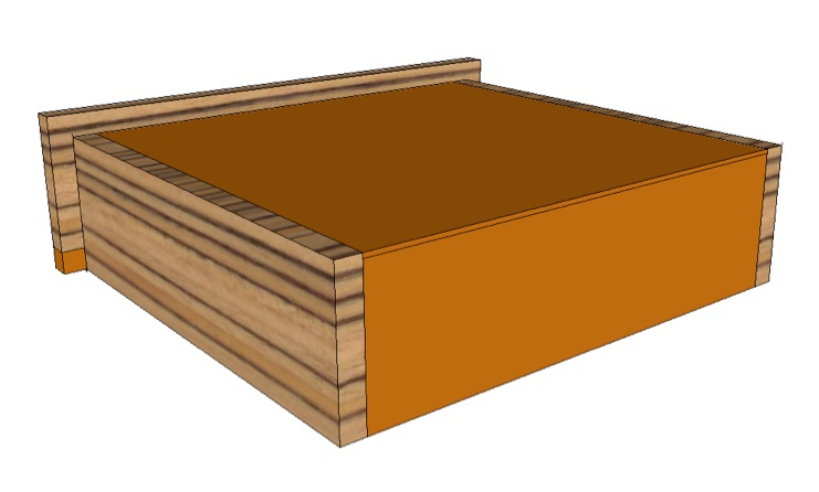

So I downloaded the free version of Sketchup yesterday and this is what materialized from the ideas in my head. I have already ordered the Zebrawood from woodcraft.com and i am in the process of working with cut2sizemetals.com for the copper. The copper will be .125 (1/8) inch thick and the zebrawood is 1/2 X 3 inch. The "bar" on the bottom of the front panel is 1/2in pure copper. The front panel will also have a large volume knob (haven't decided on material yet) and a small LED. The back panel will have a fused IEC inlet and RCA jacks.
If you haven't tried any 3-D graphics program, "Sketchup" seems to be a good place to start. I learned the software in a half hour and had this model made shorty after.

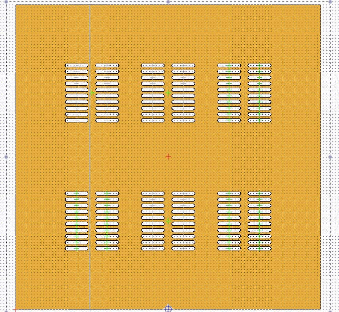

Oh yeah, the top plate will have to be machined to have vents. I am working in AutoCAD right now to give to a local company or 'Front Panel Express'.
Any comments or ideas would be appreciated.
-Madison

Here is the layout for the top cover. I think this will look amazing in lightly polished pure copper... And being 1/8in thick isn't too shabby either..
