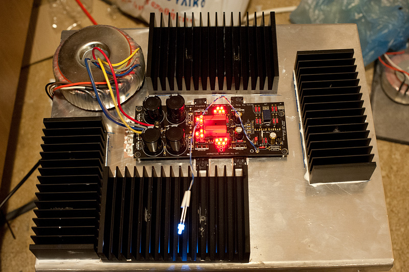

Well I have done some testing and the present heatsink layout is adequate with hopefully enough headroom to compensate for enclosing everything in box.
I know vertical fins are better, but it will significantly reduce the contact surface with the bottom plate (to which the fets are attached).
There are also 2 heatsinks attached at the bottom of the plate, and the plate/side walls are elevated 3cms to allow it to breath from the sides
About air circulation, I intent to open some slots on the side walls to allow air flow in. And the top will be open in the middle, forcing the air move from the bottom sides to the top center.

I m running it at 1,2A and the temperature after 2 hours was about 50C on the case of the fets.
And that was with just the plate and the heatsinks just left on top of it. Not screwed on it, no thermal paste and no bottom heatsinks.
It s the aluminum plate that makes a significant difference.

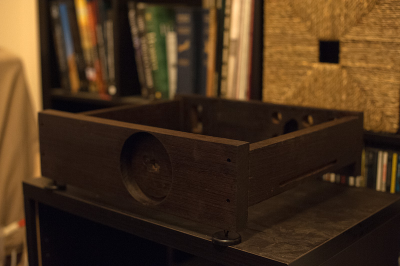

More work today... Took me more than I expected... that damn thermal paste is all over the place :D
The chassis is glued together and finished with 120 grit sandpaper (It feels way smoother than it sounds...). I also put a layer of oil/wax and the wood got a nice dark color. The damn photo again is not doing it justice. I plan to do an additional layer tomorrow and after it dries I will put everything together.
attachment.php
You can also see the side vents and the spikes. I intent to make some smaller plates for them.
attachment.php
The heatsinks were properly screwed in place along with the Caddocks that are now below the pcb screwed to the plate themselves.
I also removed all wiring to replace it with pure silver and I added a white led which will show on the front panel.

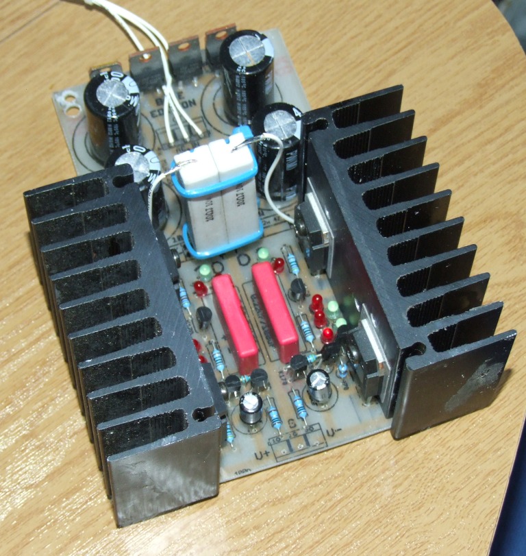

I have few pics of mine as well. I've run it for half of an hour with 3R css resistors. What could I say, it was about 60c on this tiny toroid (just confirmed what Andrew said dozen of pages ago), 80c on CSS Rs, 75c on mosfets, 60c on MUR860s, 55c on the sinks. I'll get some M2 bolts to attach mosfets properly on this week and continue with preliminary burnings tests :D
Last pic shows the layout, please let me know if it's decent enough?! toroid will be replaced with something <80mm width & <55mm height (probably should be some custom narrow 80VA or 65VA r-core transformer).
Yet another thing to clarify :) As my goal is >=1A (I need >65VA transformer), would it be good to add additional solid 10mm aluminum plates to the heatsinks (as on pic 2) or perhaps to add a solid 10x160x250mm plate to the bottom? What I want is to win some several hundreds mA more to burn it even harder :D

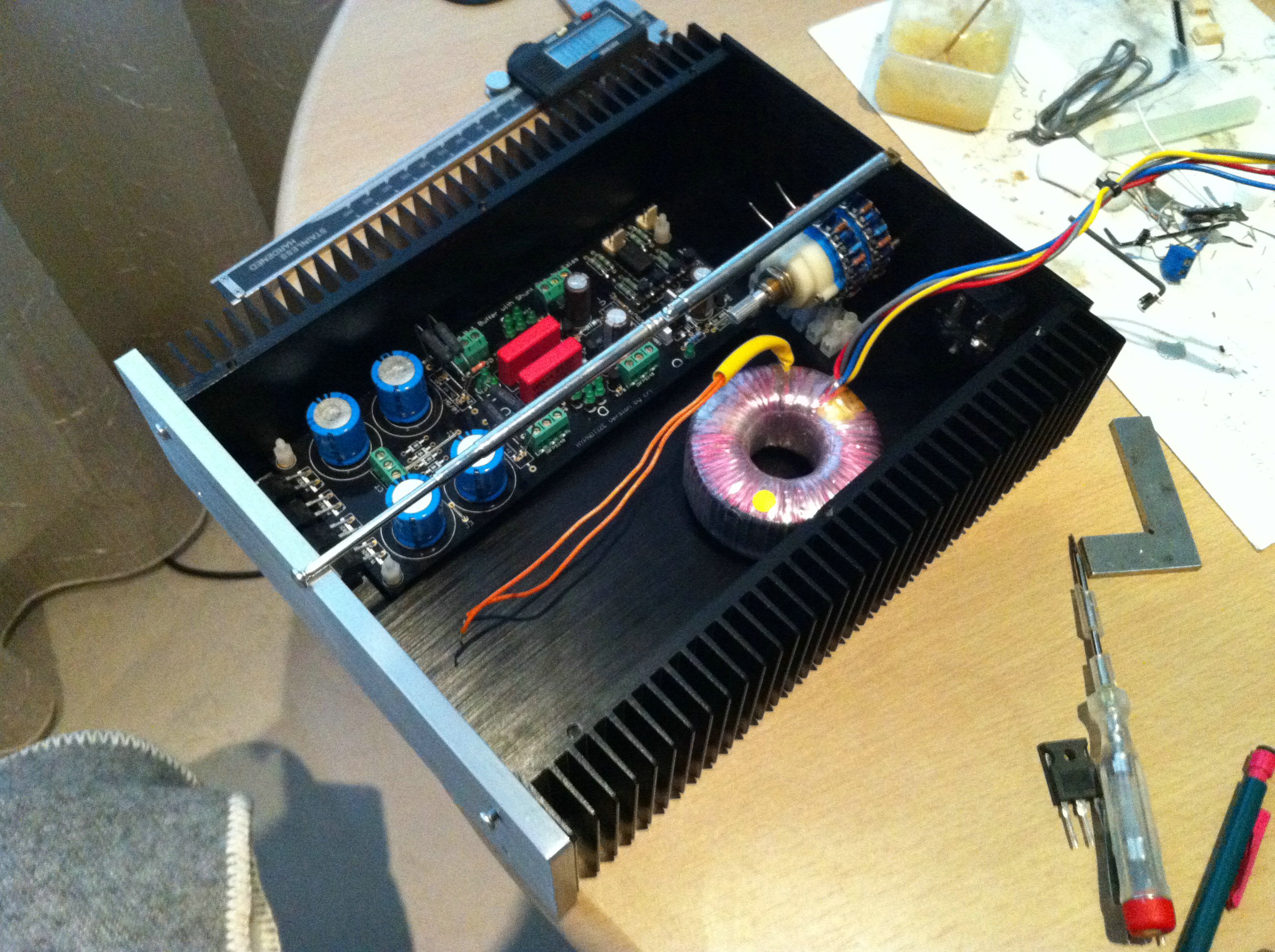

After you will have the Mosfets properly bolted on sinks and final CCS current of choice, we will know the temperatures on sinks and Mosfet cases you will measure. From there we will be able to judge if they will be safe conditions in the long run or you will need to upgrade thermals either for pads or for extra metal.

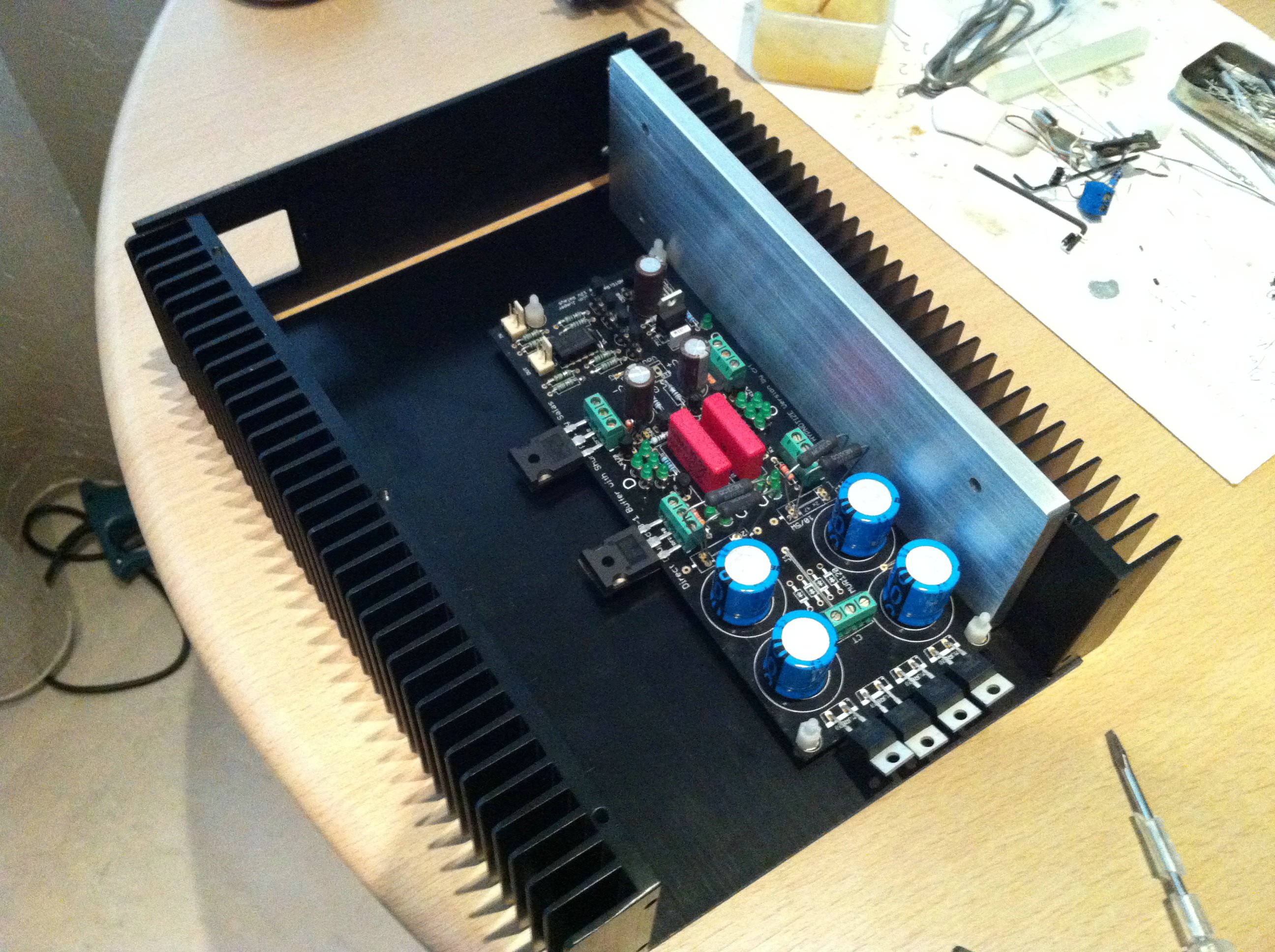

*See to give the MUR diodes some contact to the metal floor if not bothering to bolt and insulate individually which can be PITA. An insulating strip running their tabs and a bracket pressing them all together on their plastic cases maybe. Matters at the current level you aim at.

thanks! is it safe to keep them above 60c? Anyway I was planning to attach them to the chassis.
How much voltage you got now across the current setting resistors on average?
it's 2.02 &1.85vdc with 2 x 6R per rail. So it's >600mA now. Not sure how much more could I get from the trafo as it's already on the edge to my understanding :)
I'll assemble the bottom lid and heatsinks and make the proper measurements. Will see then how far could I go.
