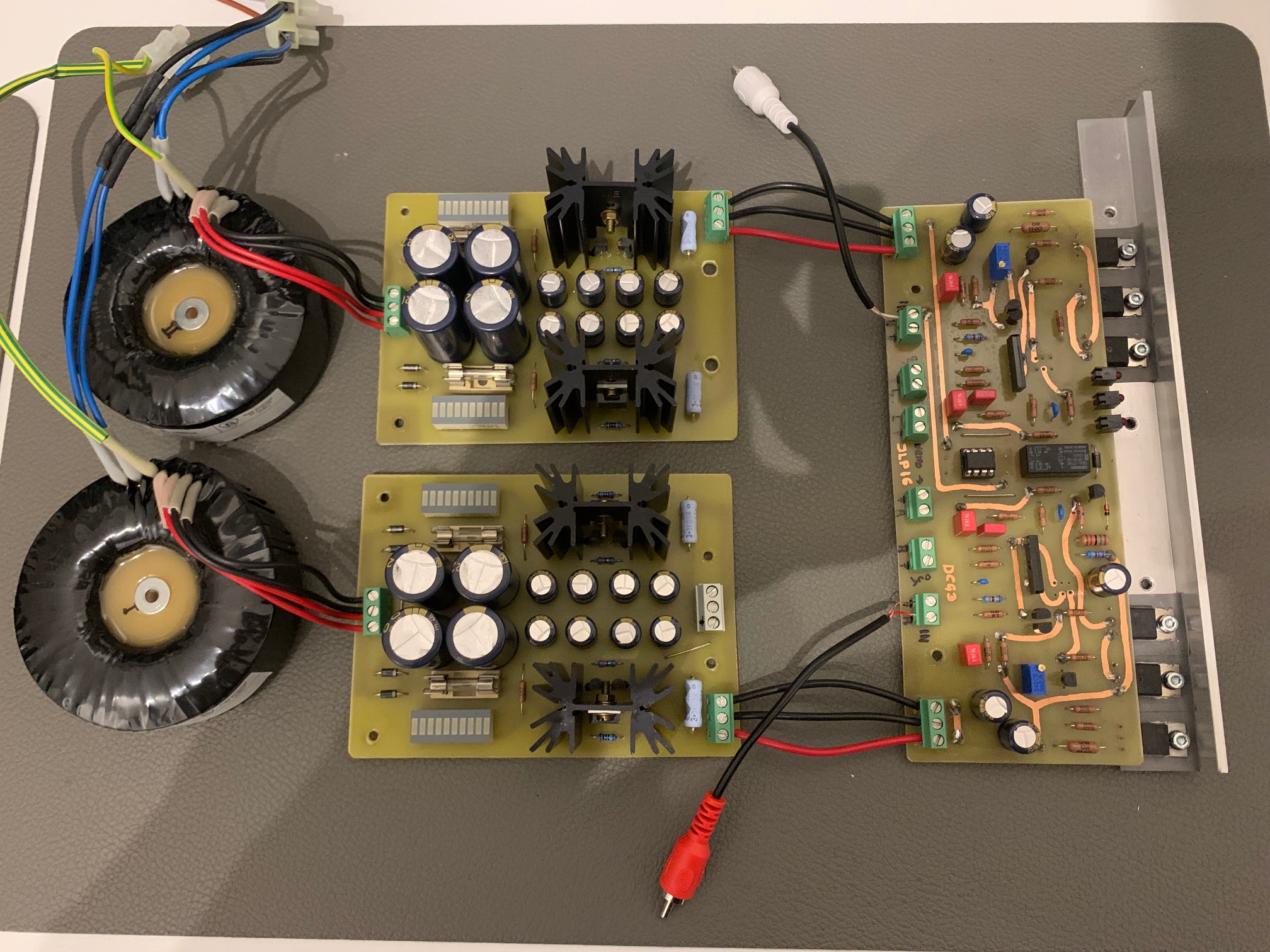

I took it out, for rebuilding into another chassis giving it 1K for the R6's (gain) now.
Checking bias, dc-offset (without opamp) and then with opamp, telling me that it did not change at all during the years :)
Gain going nicely from 2x to 3x now...

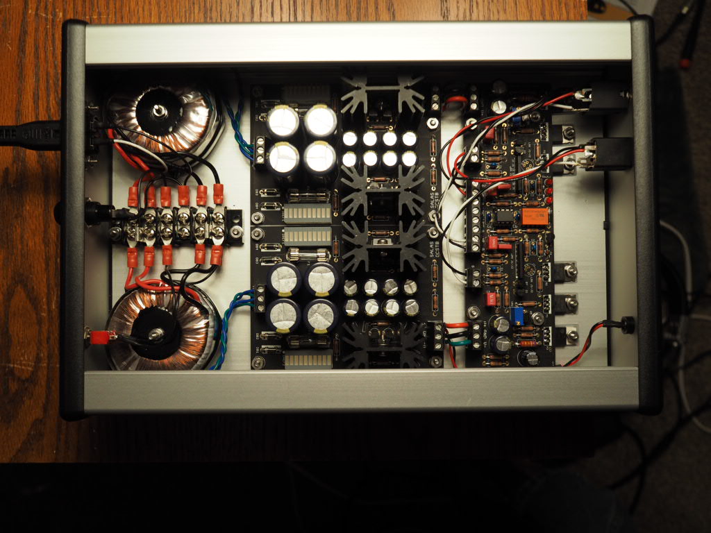

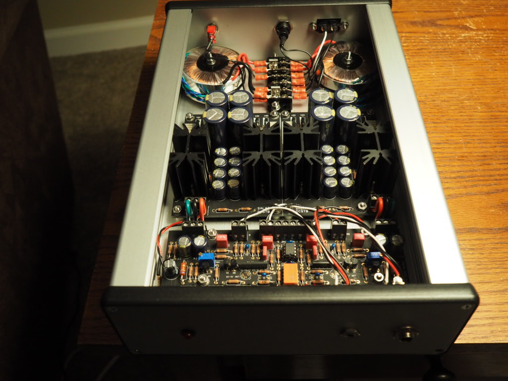

Hello Salas,
It's finally done!

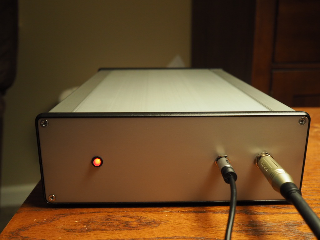

Now you see why I wanted to use smaller 10VA xfmrs, they are a nice fit in this particular chassis, larger and there would be little to no space for A/C. No volume control, I control that with the Fiio player. Power switch on the back to keep AC separated from audio.
I can't say enough how much I like this amp. The combination of player, amp and headphones are very musical, very lifelike, to my ears.
