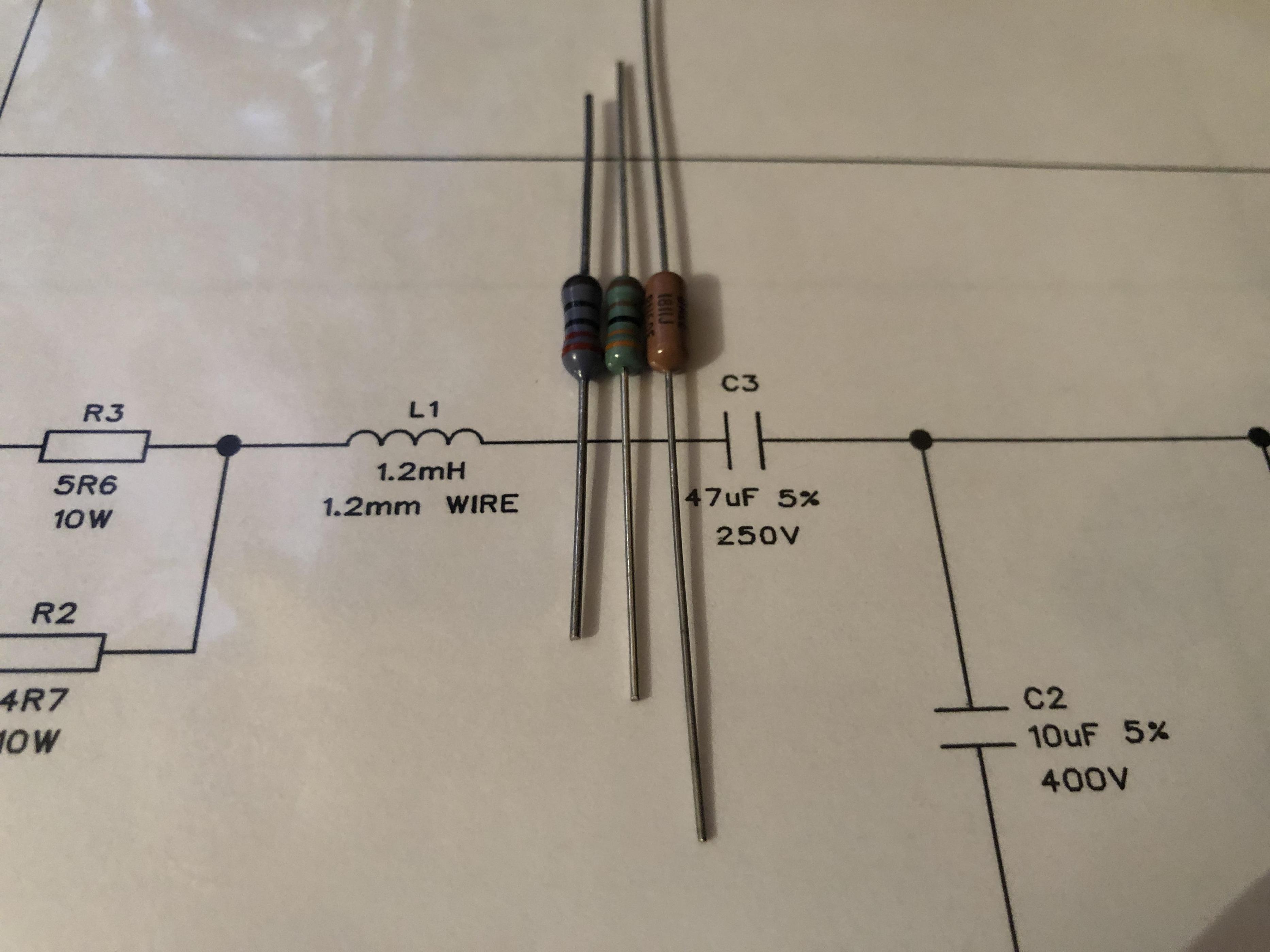

When exact diam rub them off with grit paper a little. For the oxides to come off especially in NOS parts, plus losing tiny bit of diameter.
I am afraid to expose copper on tin copper leads.
I guess it must be of high grit number and only a few careful moves.
Will experiment on the end of the leads later.
And they won't fit again because leads is 0.8 mm width and width of the hole on PCB is also 0.8 mm.
P.S.: Photo of a few 0.5W resistors with various lead width:
Dale RN60 - 0.64mm
Takman REY 0.5W - 0.7mm
Shinkoh TAF 0.5W - 0.8mm
Yep Shinkoh have strong shelf oxide, Dale RN60 a bit less and Takman looks fresh.
Will try to clean them with chemicals.

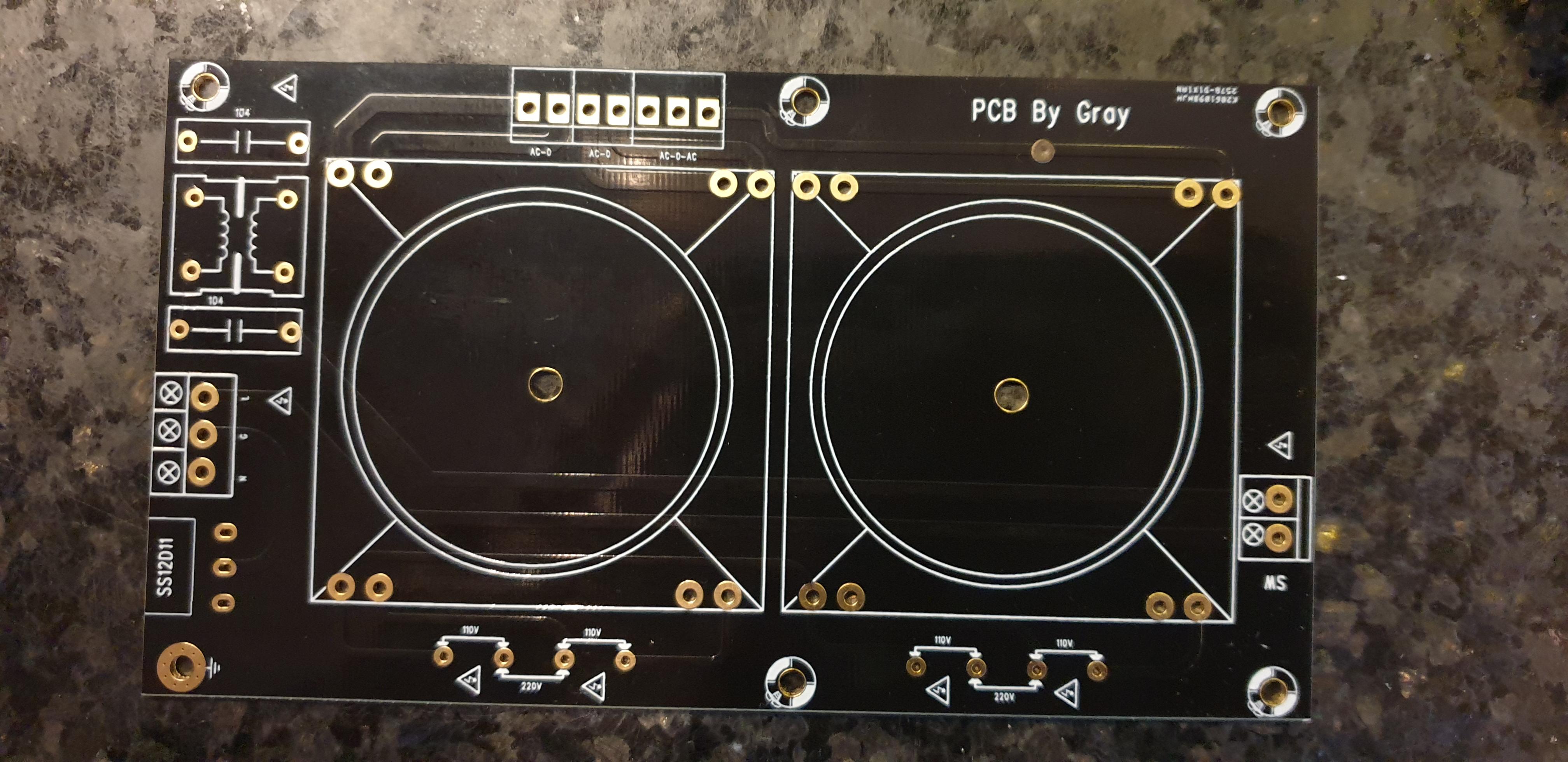

Still enjoying my DCG3 , naturally. It is an amazing preamp. I was going to re house my build and I came upon this neat little pcb on AliExpress. It will save me some space. And best of all it is in Salas/Tea bag black!
Double E cow non the less!?!
£4.82 8%OFF | Double E Cow Power Supply Board Gold Board Suitable For 15-25W Talema Transformer Or Bingzi Green Transformer
Double E Cow Power Supply Board Gold Board Suitable For 15 25W Talema Transformer Or Bingzi Green Transformer|Amplifier| - AliExpress
In post #1 there are detailed THD plots across frequency on different loads that show 150mA bias is somewhat useful in 32Ω headphones but not in line level situations. It also raises power limit in such a load. Subjectively I didn't find any plausible benefits between 100 & 150mA bias in line level use.
25VA spec is theoretically sufficient although if they have more than average thermal losses they may get warm due to the significant bias constant draw. I have seen that happening with plastic encapsulated 30VA split bobbin frame on DCG3 going about 45C but toroidal usually runs cooler.
