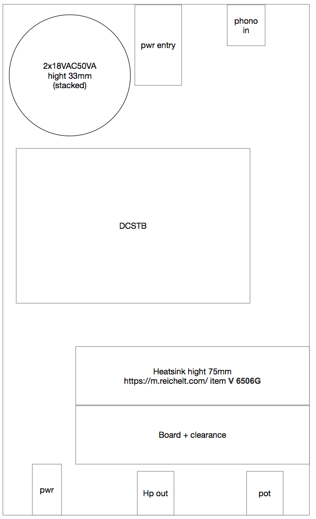

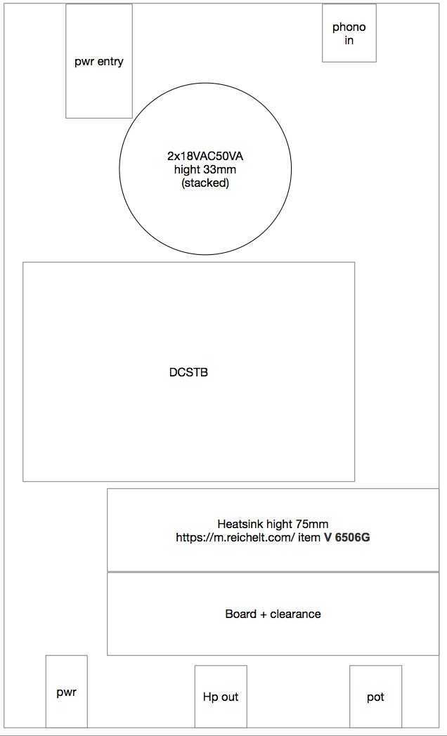

Case layout question and build proof

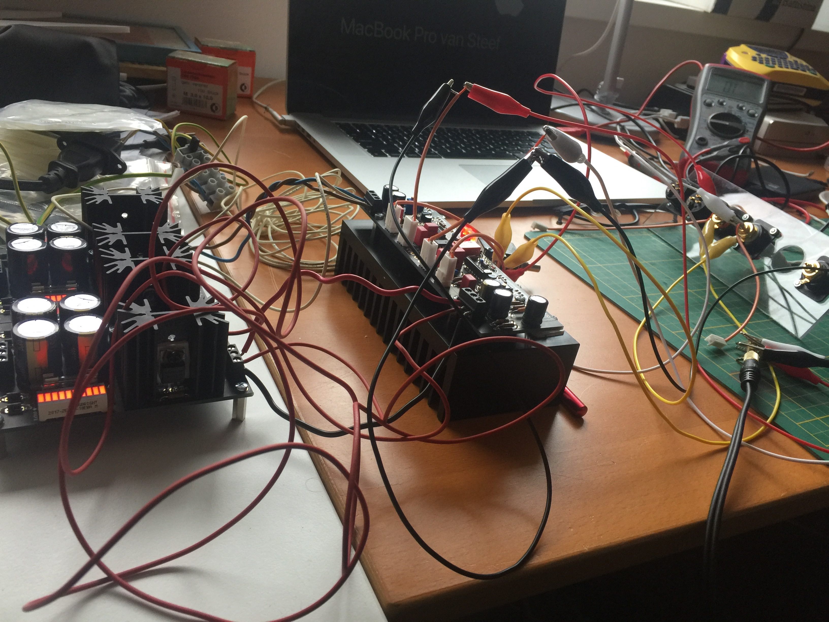

This weekend I finally had the DCSTB/DCG3 combo running! Was only a quick test but seems to work pretty good
Question on case layout in the back region of the case (power and signal entry).
- Is it preferable to place signal and power entry as far away from each other as possible, with the consequence of the toroids being pretty close to the signal inputs, or
- is it preferable to place signal entry and toroids as far away from each other as possible, with the consequence of the power entry being pretty close to the signal inputs
Tia
Steef
See attached pics for the differences. Other comments?
Tia
Steef
Steef hi,
Is it a magnetically shielded toroid or a simple one?
Hi Salas,
It is a toroidy.pl one AUDIO GRADE. They state
Steef
AUDIO grade transformers for use in amplifiers and other high-class audio devices.
Unlike commercial power line transformers, the AUDIO version is covered on the outside with a black Mylar tape which gives it an aesthetic appearance. The epoxy filled center with an opening for the M6 screw eliminates a need for an additional mounting bracket. The neoprene gum pad affixed to the bottom successfully eliminates transmission of vibrations.
The entire construction utilizes high-class, laboratory-tested parts. The core and the windings are impregnated, and the production process is being scrupulously controlled at every step.
Additional magnetic screening and the electric monitor of coated SYN-SHIELD copper tape between windings make the class AUDIO transformers one of the frontrunners in the area of safe use in the systems of electronic power supply.
Steef
States magnetic screening. In this case I would have preferred your first option. Dress the mains wires hard left and turn the transformer in best way possible to gain distance between the signal wiring and all trafo wiring but especially its secondary exits which are the most potent for current and field making. Use shielded coax for all signal wiring.
