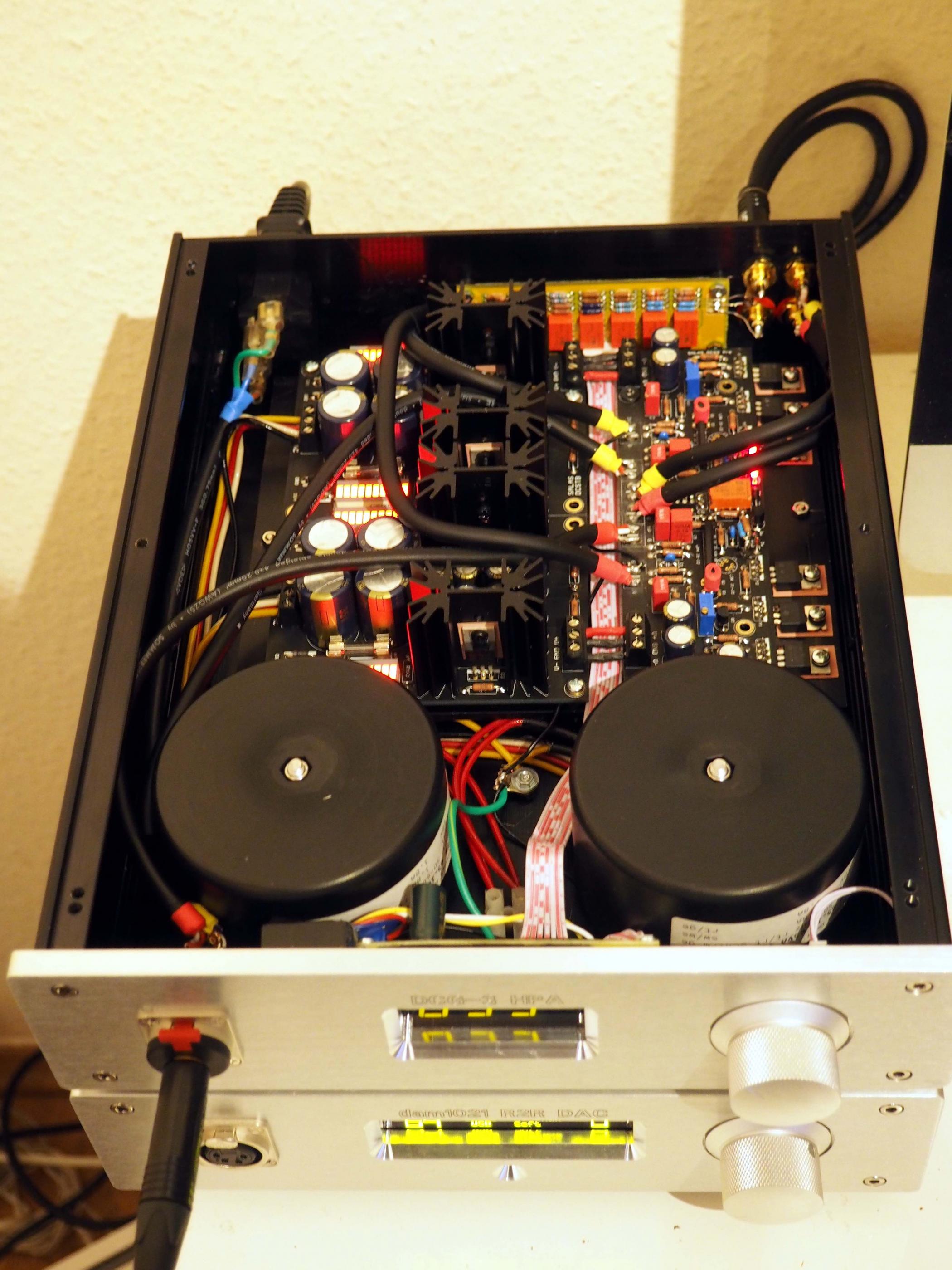

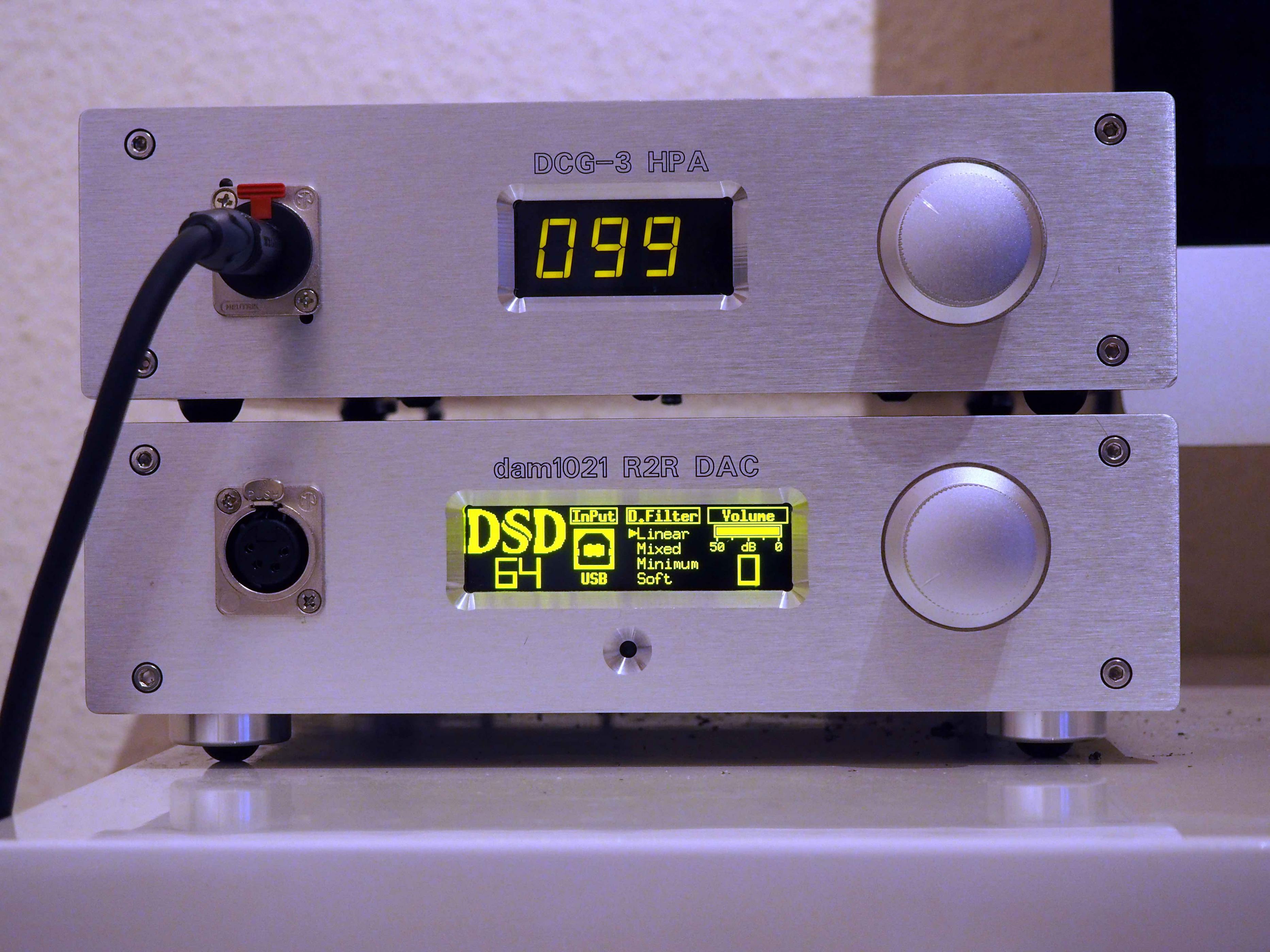

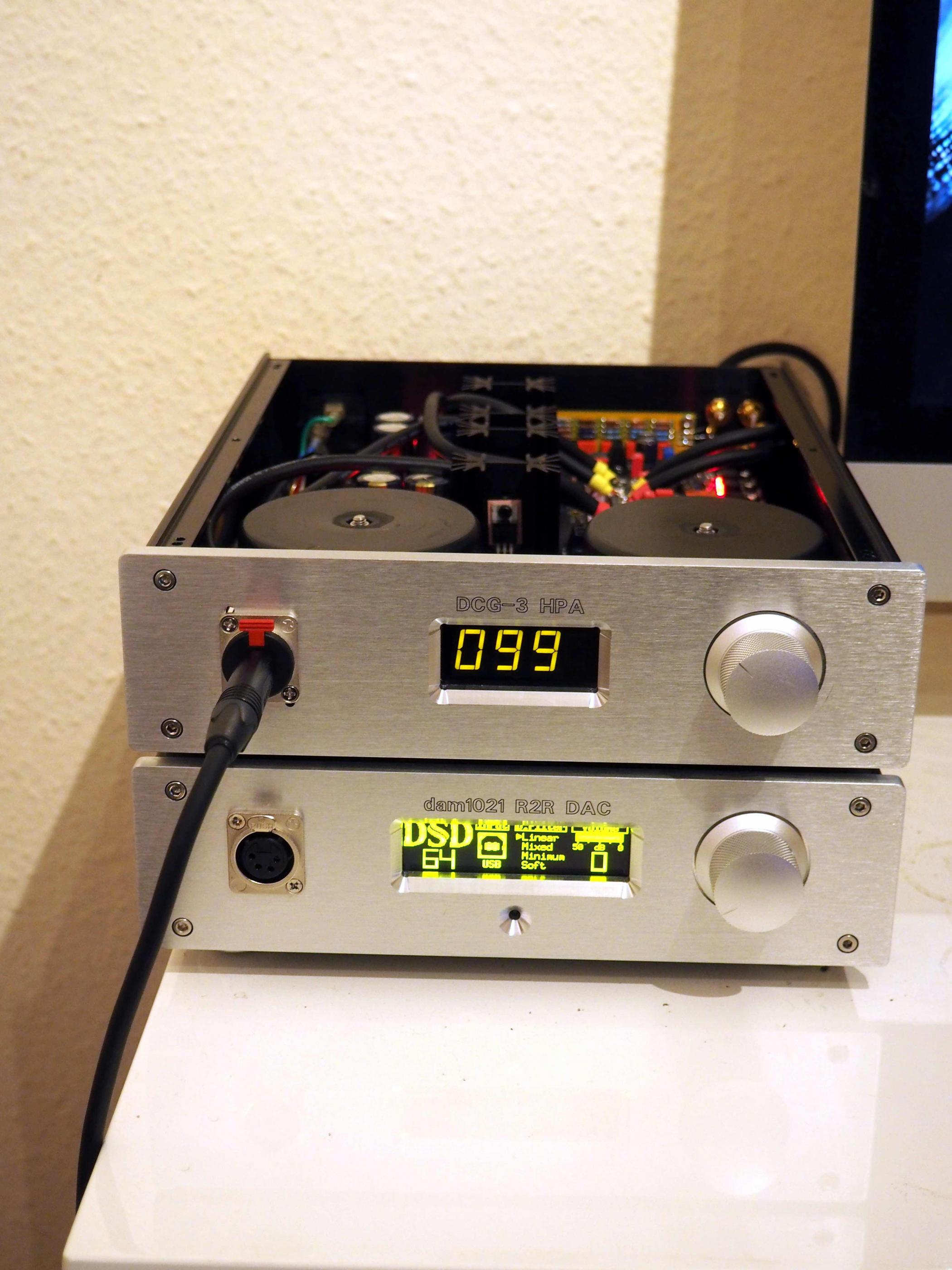

I have almost finished my build. So here you can see the result.
Unfortunately the front came with wrong drilled holes for the headphone jack. I've to check the file I sent them to find out if it's a production fault or my mistake. Maybe I'll take a plate of aluminium and will mount it between jack and frontplate to cover the holes
The amp got a ladder volume control with relays and a remote control. I changed the color of the display. Now I will have to dim the display of the DAC to get the same brightness for both devices. the work never ends...

The best thing is to make a new frontplate...
First have to check the where the mistake comes from. I have to ask the shop where I bought the cas if it's possible to get a single frontplate. Otherwise I have to order a complete new case. Last time it was hard to find and I finally bought the last one from a dealer in UK. If I need a new one I have to order in China and wait 1.5 month for the case to arrive.
That's a good hint...
I simply buy 2 of them and use it for HPA and DAC.
Thanks, that's what I will do
Yeah, white gasket (9) on both machines front sockets to cover the mistake and match looks. Why is there a four pin XLR on the DAM's front by the way? A chips based HPA in bridged configuration lives inside?
No, the dam has onboard balanced output drivers that can drive high impedance headphones directly. I just wired the output to the XLR, rewired my Beyer DT1990 to balanced with a 4pin mini xlr in the left cup.
But you get the best quality from dam by using the "raw"output from the R-2R network and that's single ended to use with an amplifier.
