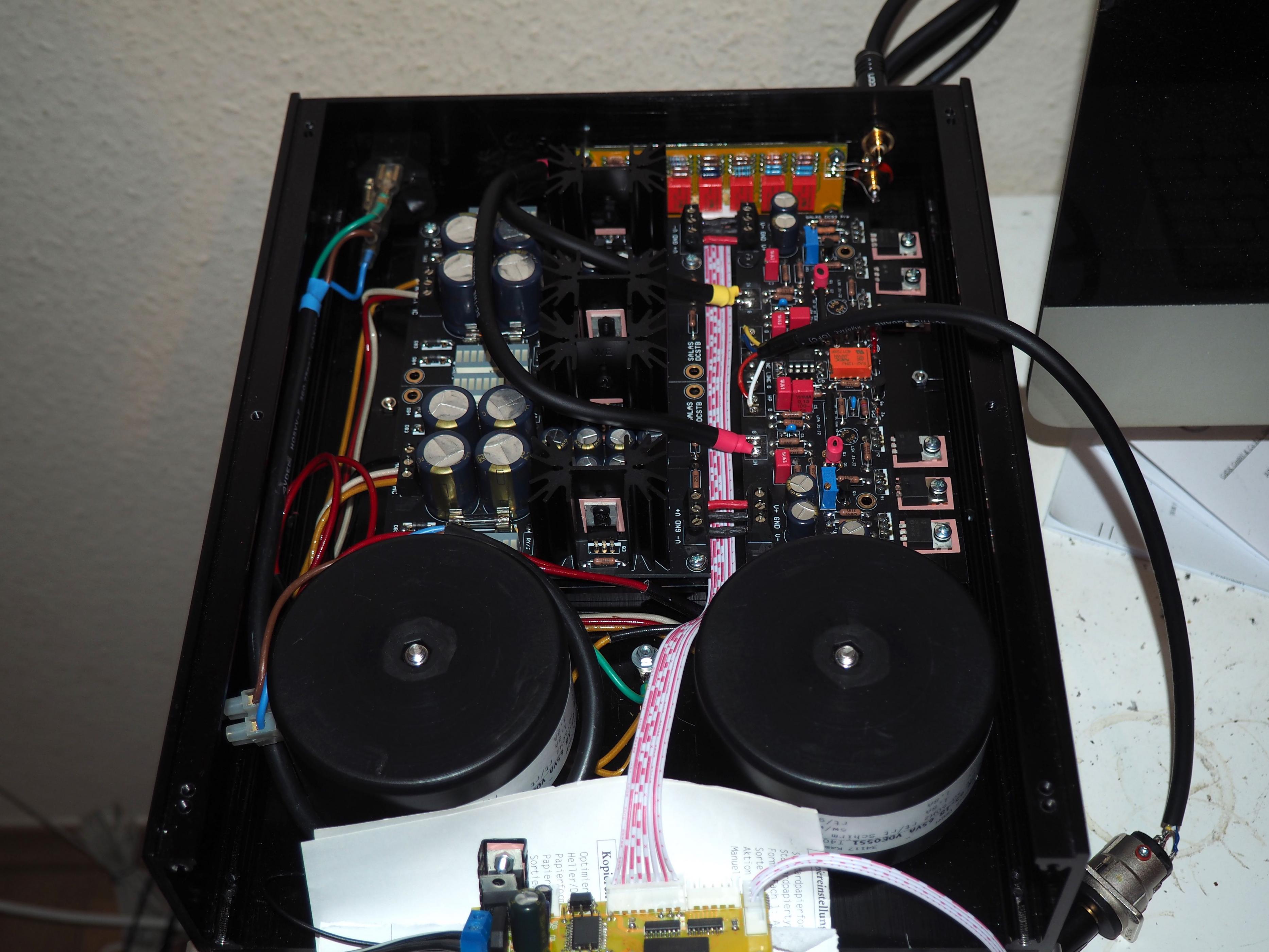

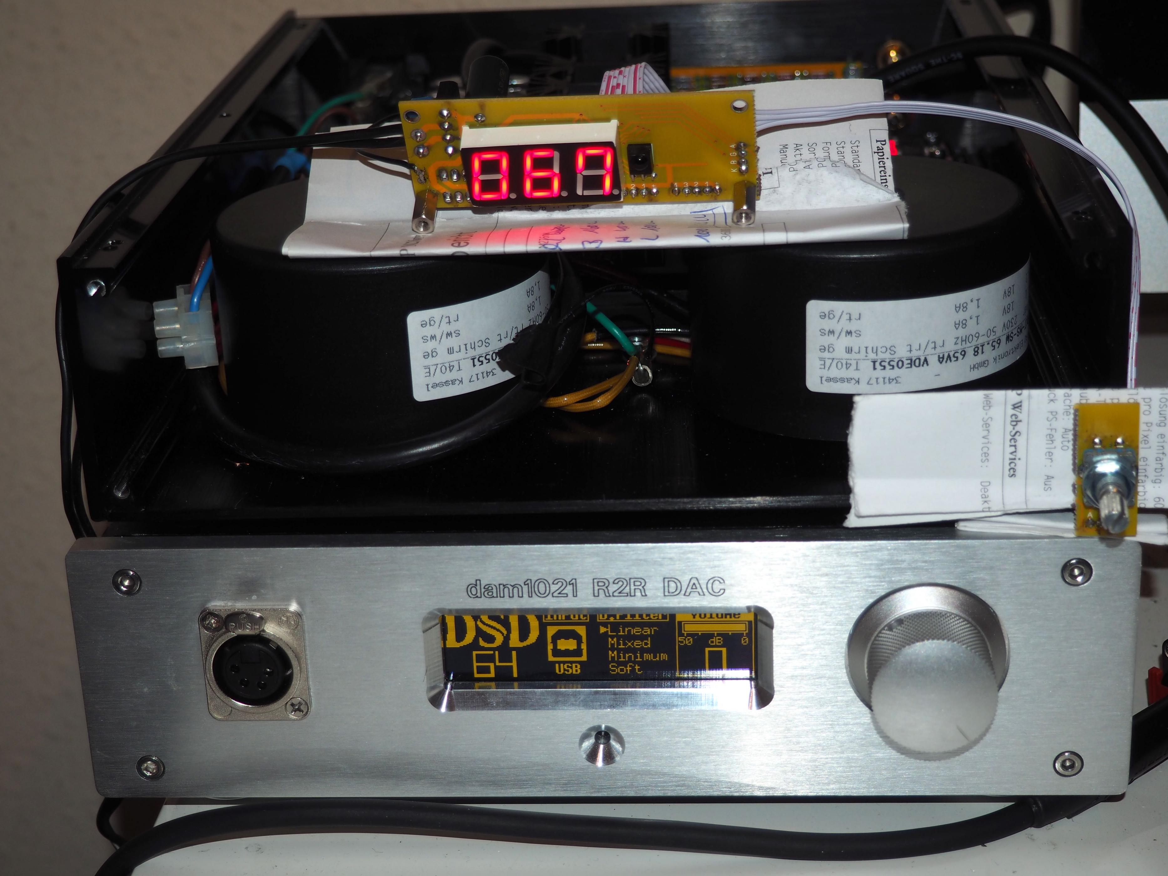

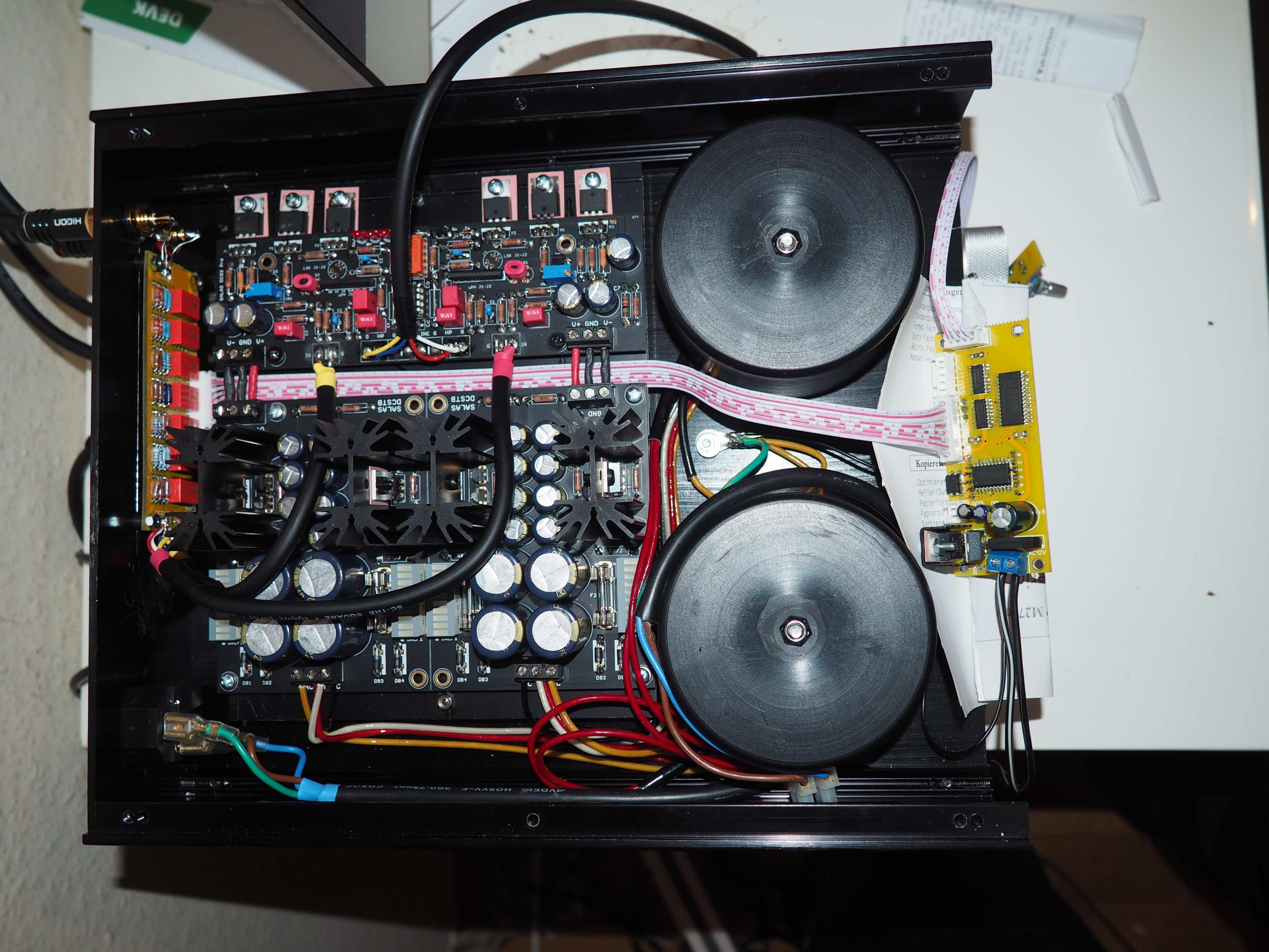

Hello,
I'm almost finished. I designed and ordered the front on monday. With luck it will be delivered at the end of next weeek. The front will look similar to my dac, like a family build :)
The DCG-3 is fully functional and I'm enjoy listening music to this amp. The only thing to do when the frontplate is delivered is finish the wiring in the front, mounting the display with volume control and installing a seperate "mini"-Powersupply for the volume/remote control with standby switch ability.
Soundwise the amp is getting better day by day. I own a chord mojo, questyle cma400i (with AK4490 DAC inside) and an audio-gd nfb28 (2016). The dcg-3 is beating the audio-gd and the questyle a lot. The mojo sounds almost on the same level but in comparison to the dcg-3 sometimes kind of agressive but not bad.
Greetings

Turning out nicely. But don't forget to also put a couple of line out RCAs on the back panel. You may add a power amp and speakers to the system someday.
The DAC/AMPS you own are famous and very highly regarded in the international headphones forums. You listen to them individually vs the DAM+DCG3 as a combo only or you also feed the DCG3 from their line outputs listening to various DAC/DCG3 combos?

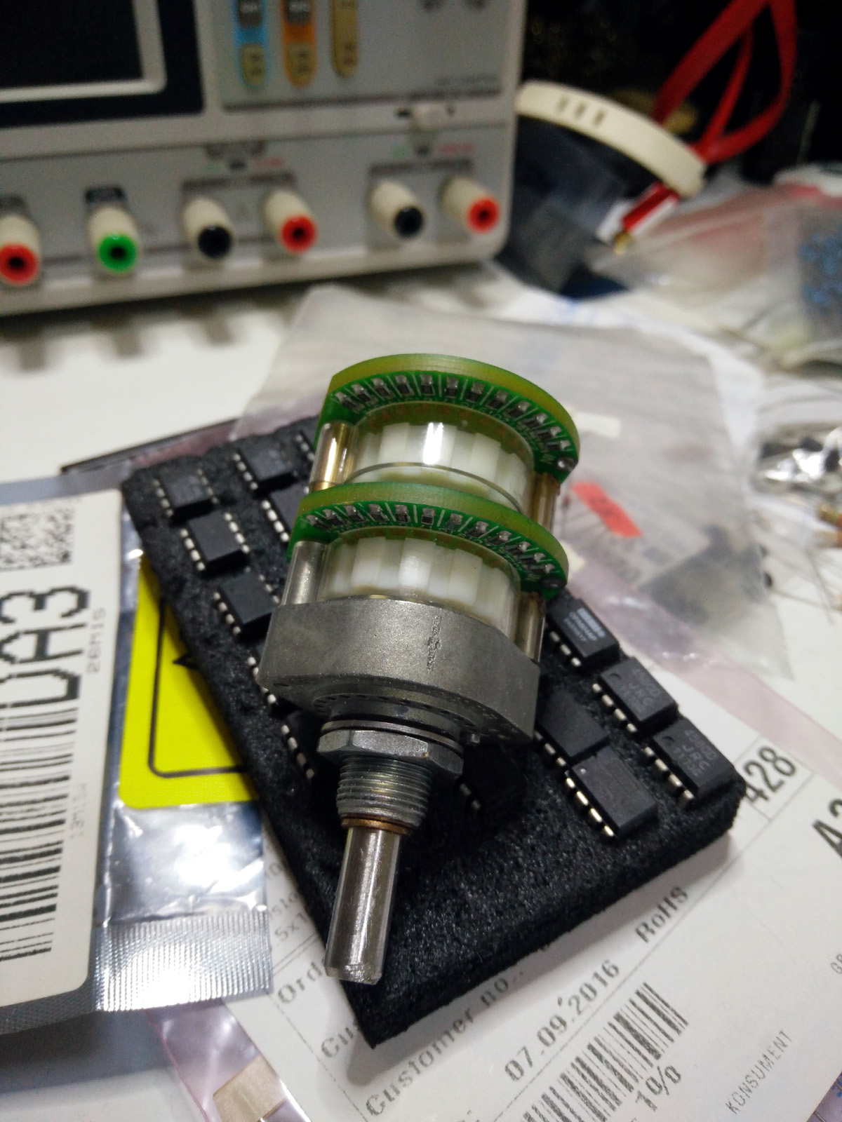

Got the Goldpoint attenuator installed, very transparent, I think the bass is a tad lower. Perhaps it needs a break-in period? The pot needs to be rotated more than the 50k to achieve the same loudness level.
Salas, you mentioned adjusting the input resistors, make them 2.2 K instead of 3.3? What would you suggest? Thanks
The Goldpoint has a slower audio taper curve than many other pots. Arguably more suitable for today's many loud sources. Different value pots of same log curve design do not open slower or faster they just load the source with another impedance and also show to the receiver another insertion impedance.
For 50k and 25k classic series configuration pots the insertion impedance reaches a max of 12.5k vs 6.25k when the wiper sits exactly at half value. So some of your system synergistic roundness loss after replacing the 50k is perhaps not only due to the new 25k switch pot's superb clarity but also due to faster rise time of the preamp's supersonic input filter when seeing less total incoming impedance. After some play time to have made sure you need tonal changes, do the following:
Try 1k to 5.6k Rx resistors in series with the new pot's outputs. Almost by 1k step at a time for fine tuning. When you will find your system's perfect tonal balance remove them. Replace each channel's R1 with a new value R1'=R1+Rx.
