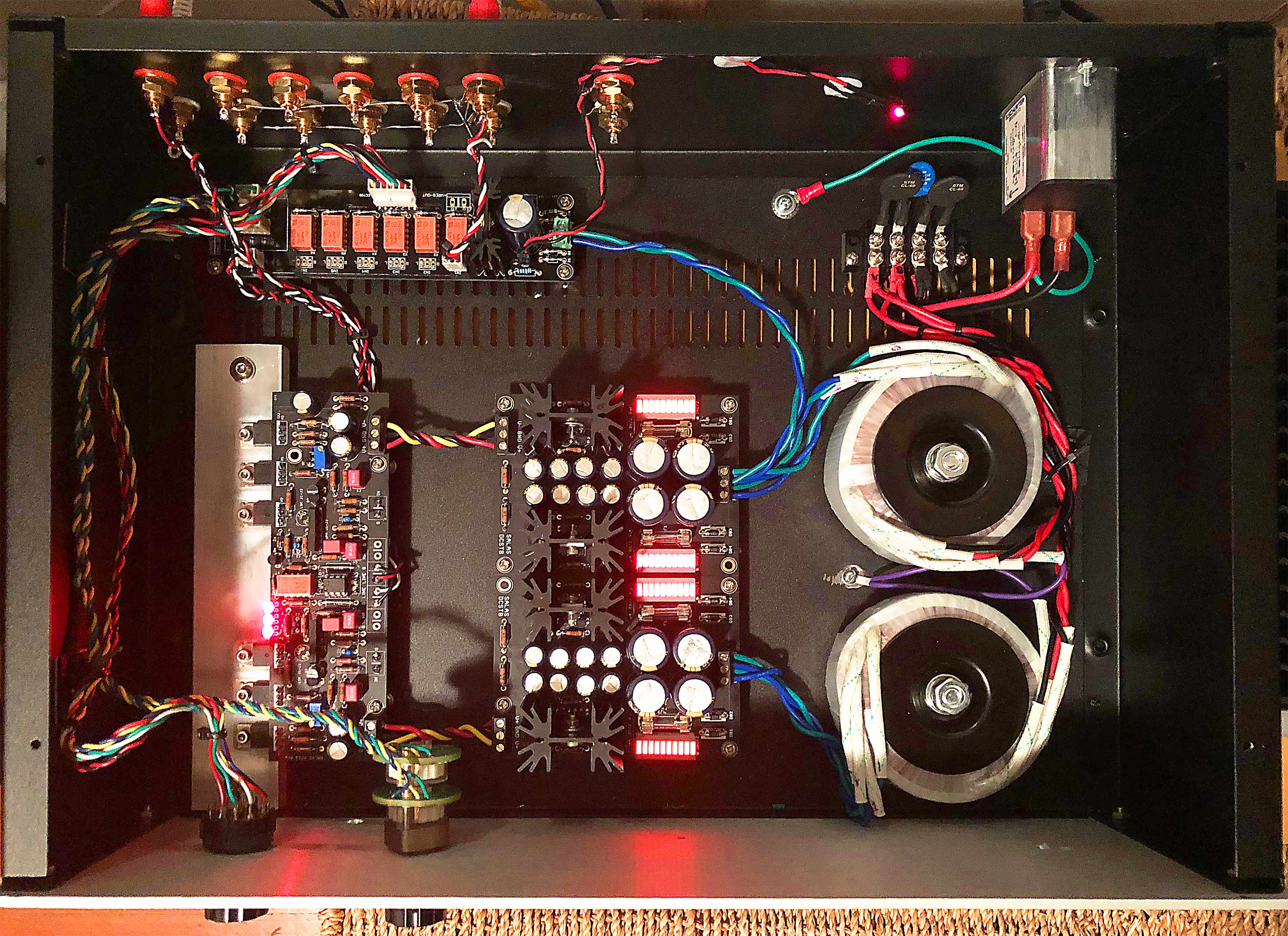

Hi Salas,
I was finally able to get back to my build yesterday. You had suggested I up the bias, since I had room in the chassis, by piggybacking the 12Rs. I just replaced the 12R's with the 7.5R's since I didn't have any 33 or 47Rs on hand. It was easy to switch them out.
After running for about 20mn I got 144.6mA and 144.1mA across R10.
Then I adjusted the DC offset as close to zero as possible with opamp chip removed. I couldn't get exactly zero; it does fluctuate a bit but I believe that's normal. After inserting the chip my final DC offset was between -1.9mV and 0mV on right channel and between +1.1mV and -0.6mV on the left. Are those numbers ok? I was careful to keep the black probe on ground so that should be the correct polarity.
After being on for about 30mn the aluminum bar heatsink was 38-40°C measured with my Extech dmm.
Thanks again,
Dan

Well, I spent the weekend putting everything together in the Pesante 3U chassis. I had to scavenge some parts from my DCB1 since I was too impatient to order new ones. So there are still a lot of odds and ends to sort out as you can see from the picture.
However, I was able to listen with my test setup, Amp Camp monoblocks and Focal 714V speakers, and it sounded INCREDIBLE! I’m not good at audiophile descriptions so I won’t try but it’s super detailed, yet natural, with strong, deep bass. I can't wait to try it in my living room system: Sony DIY vfet amp and Reference 3A Decapo speakers.
I had bought extension kits for the stepped attenuator and rotary selector but the bushings were too short for my 10mm thick front panel so I just grabbed the whole 3mm front panel from my DCB1 and used that, expecting to have some buzz or noise with the long cables from the i-select to the attenuator on the front but there is zero noise, no humms or buzzes! And that’s even more surprising since I haven’t put in the audio ground yet. Now I have to figure out how to deal with the 10mm black front panel.
Actually, do I even need to add the audio ground if I don’t have any noise?
Thanks again to you Salas for sharing your concepts and replying so quickly to all my weird questions, and to Tea-Bag for the kits and to everybody on diyaudio.com for all the helpful advice.
P.S. Salas, I haven’t tried piggybacking the 1meg resistors to try to get a better DC offset yet, but I will.

diyAudio Chief Moderator
Joined 2002
You are welcome. Congratulations :up:
Regardless of having some construction details to finish like rods or a couple of other minor things to check* your build is objectively already a success for proper function from what you report. Nice to know that you are subjectively happy too. As far as first impressions can go of course. Let us know what happens in your main system also. Interesting electronics and speakers there.
There's always more to discover in the long run even after we get a grip on the performance. I was listening to some Paul Weller 90s stuff today for example and as I thought I knew this preamp and that recording well, right there it sneaked on me again.
*About your little finishing tests:
Noiseless already is nice. You could also test what happens when referencing the chassis to the signal ground with a crock clip to a mounting screw and if there is no advance in detail or smoothness or for some total system ground reason even a tiny noise comes up or it simply sounds bit worse you may very well skip it.
Piggyback on the R12s only as first test. That will move the pole frequency of the servo's input filter the other away from the main integration pole and we will see if that can help tighten the particular op-amp sample a bit or not.
By the way your stepper pot is 20K Log as recommended, yes?
