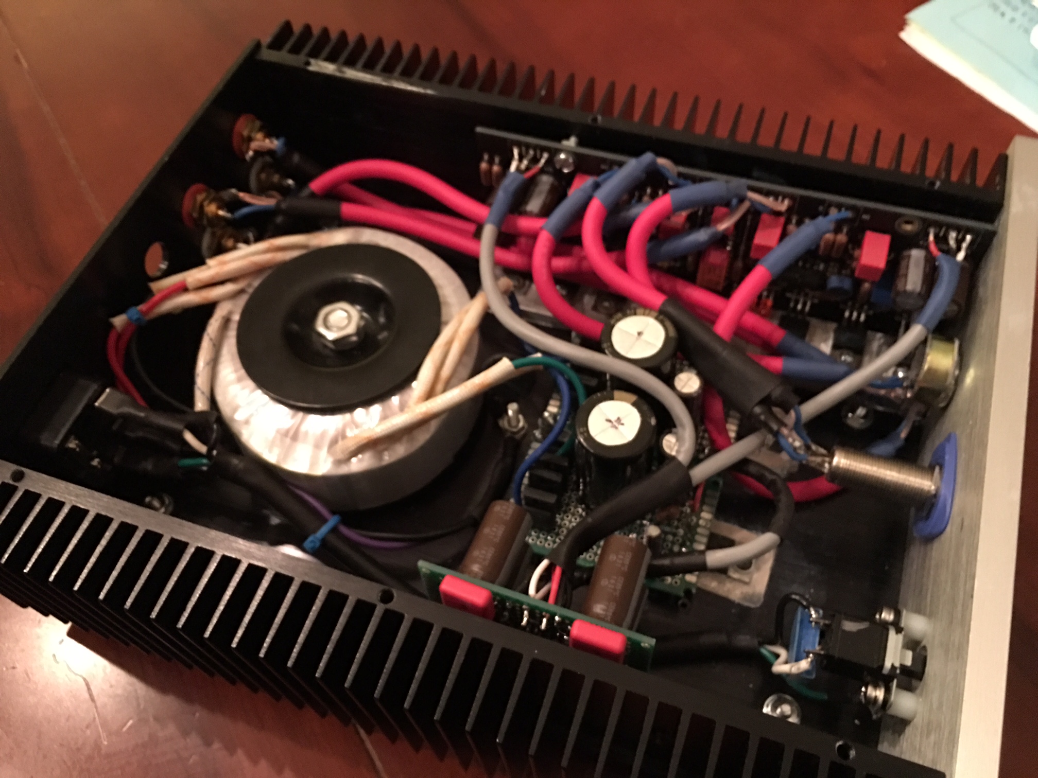

My DCG3 is in the 2107 chassis. The mosfets are mounted to the BOTTOM plate via a 1/2 bar, not the heatsinks (due to layout) and and I am running lm317/337 mounted to the bottom plate. AND a cap multiplier.
Chassis temp at 150ma bias is low...low enough I haven't cared to measure...probably 40C. Even right under the mosfets.

With an aluminum bar interface between the Mosfets and this ribbed side panel/sink it will do well for 100mA bias level at least. The bar will add mass and contact area. The side panel is then in direct contact with the room air and that helps. Use thermal paste between bar and panel.
This is what I did and the chassis side gets only mildly warm with 120ma of bias.
