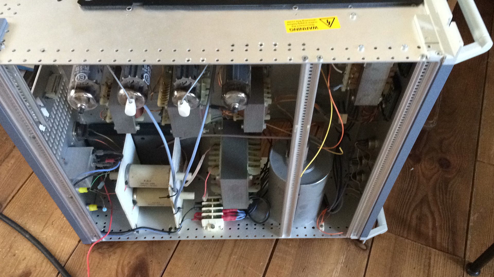

Hello,
I am building a little tube amplifier that work with 670 volts dc . Some cables have to pass through a red copper piece of metal ( there are two copper chassis bolted to each other. One is signal and one is power supply. I can isolate the cables in the two chassis with adding an extra teflon tube around the already teflon covered cable and by using some physical distance between two cables that would create a short circuit while touching.
I wonder how to improve isolation in the area where the cables are passing through the copper without making to big holes. Probably needs to be something like teflon, ceramic, glass. Could be something that is used for something completely different outside audio life.
Greetings, eduard
Greetings, eduard
I'd use HV wire and a small rubber grommet and call it a day.
Something like this: 10m High Voltage Wire 6KV 6KVDC VW-1 TV-6 3472 AWG22 105℃ UL CSA Sumitomo Japan | eBay

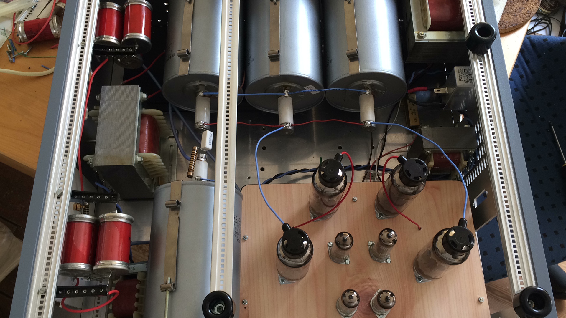

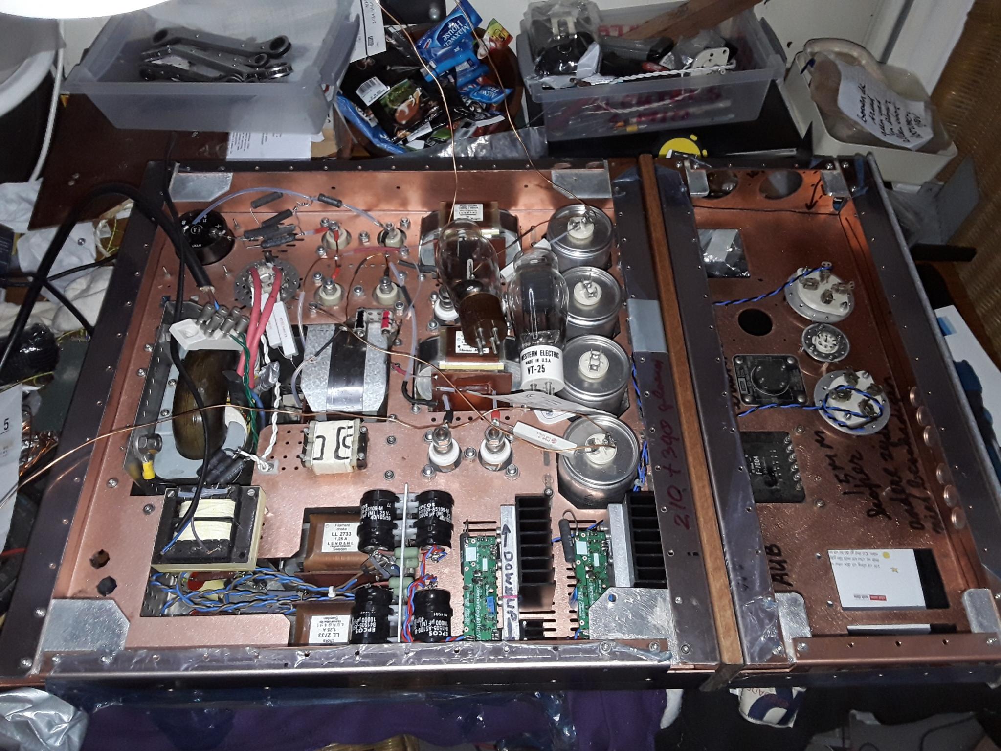

Hello,
I decided to get some PTFE round massive tubes which i can mill ( if needed) to the same diameter as the drilled holes in the wood panel that is between the two copper chassis. After drilling a hole in the center of the PTFE i just gentle push it into the wood. This way the isolation of the cable itself can never get damaged if the holes in the copper might have sharp edges.
I found the way how to wire the heater supply and how to let them run through the chassis. The heater wires are running between the anode choke and the output transformer close to the chassis ( top plate)What about the rest of the cables. The loudspeakers terminals are on the right side ( 2 times 3 holes in a row) What i could do is make the cable go up from the output transformer secundairy solder tags and when they arrive at the bottom plate let them make a 90 degrees turn towards the side of the chassis.
There is just one input tube ( e80cc/6085). Each half connected to the Vt25A tube. The xlr input terminal will be mounted on the location where there is the small rectangular hole ( At the right corner )
Thanksalot. Greetings, Eduard

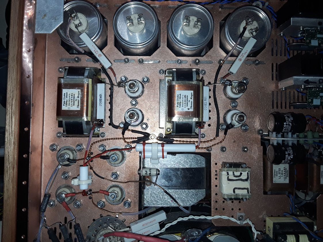

Hello,
Because i am using a choke input power supply most of the time i am used to use a bleeder resistor to assure that there is always a minimum current running whenever it is switched on. There isnt much capacity used ( total for the stero amp 20 microfarad for the first cap after the infut choke than for left and right each their own LCRC with 50 and 22 microfarad on each side) So total amp 164 microfarad with lowest voltage at the 22 cap is around 620 volts. The 50 microfarad 1000 volt cap has a maximum pulse current 1200 A . Of course with 660 volt on that capacitor the current will be lower but still lethal.
The caps are at 0 volt in a few seconds could even be one or two seconds.
Greetings, Eduard
P.s as you can use i used some teflon/ptfe to create extra safety for keeping high voltage wires in the same place
Greetings, Eduard

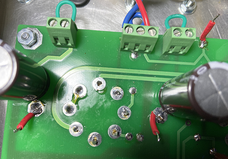

I recently finished building my first tube amp. The way I populated the PCB, my resistors are on top, and the board itself is beneath the chassis top. I needed to measure some voltages to be sure that my power tubes were operating below max dissipation, etc.
I was really nervous about probing in a live amp, so I temporarily soldered on some test leads to the underside of the board. This allowed me to attach my alligator clips while the amp was off. I was able to take the necessary measurements without ever having to be near the live amp. Plus, if anything was to blow up, or catch fire, I was some distance away, and could kill the power from a remote power strip switch. It really eased my anxiety, as this was the first time I had ever worked on a tube amp.
Of course, if you have access to the component leads, this is all unnecessary!
At any rate, I wanted to share this since there may be others who are apprehensive about that first encounter with lethal voltages.
