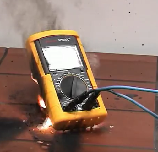

I thought this was interesting..
Cheap meters..when protection fails.
https://www.youtube.com/watch?v=lg44zuxGmMg
Regards
M. Gregg
Regards
M. Gregg
