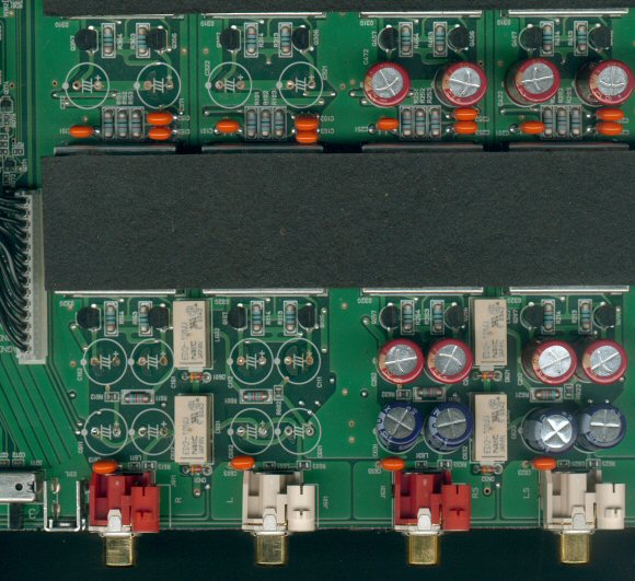

I am upgrading the caps in the SACD 1000 of a friend.
For the DAC-card I have bought a bunch of Blackgate N 6.3 Volt 220 uF caps.
I know that these are sufficient as analogue output caps (max 2.0 Volt on these) but I wonder whether they will have sufficient voltage range for some other places.
I wanted to use them on C371 and C 372, on C161 and C162, and on C611 and C612 (and on the equivalents of the other channels).
Since I do not have a scheme of the SACD 1000, can anyone (Randy?) comment on these caps? I saw that there were only 16 Volt caps used on these places...
So, can I use these 6.3 Volt caps on these places?
Any help much appreciated!
Lucas

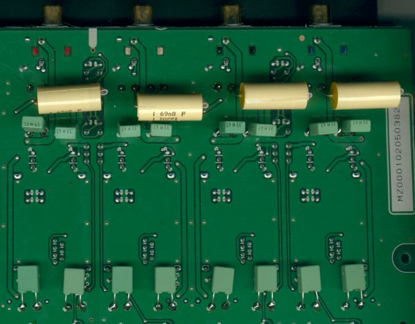

By the way, this is the mod done by van Medevoort to the SACD 1000 output section.
With the 963 they use 0.33 uF MKT and tiny silver-mica caps.
With the 1000 they use 0.33 uF MKT and 69n8 polypropyleen caps. At the last caps before the output, they exchange the standardly fitted Elna Cerafine caps for cheap standard Nichicon caps:smash:
(Also see the picture in the previous post)
Strange it seems!
