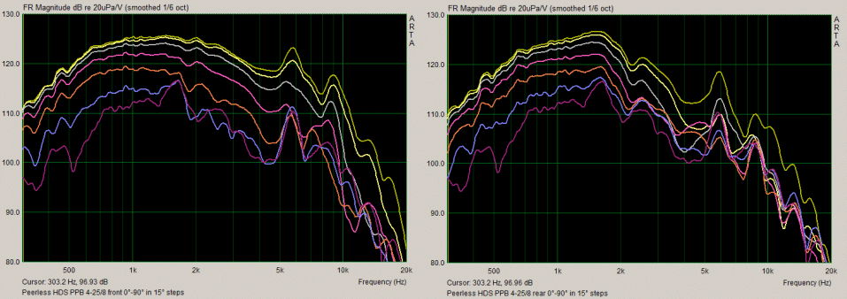

I am not trying to take over this thread, but I would like to give an exemplary insight into the polar radiation of a driver and some specifics of it.
It is the 4" Peerless HDS PPB 830870
This is the (already heavily EQed) response of the driver without any baffle in free air (left front, right back):
attachment.php
Intended use is from 0.5-2 kHz. While the front radiation pattern would allow another octave, the rear pattern obviously limits the usable range to 2 kHz.

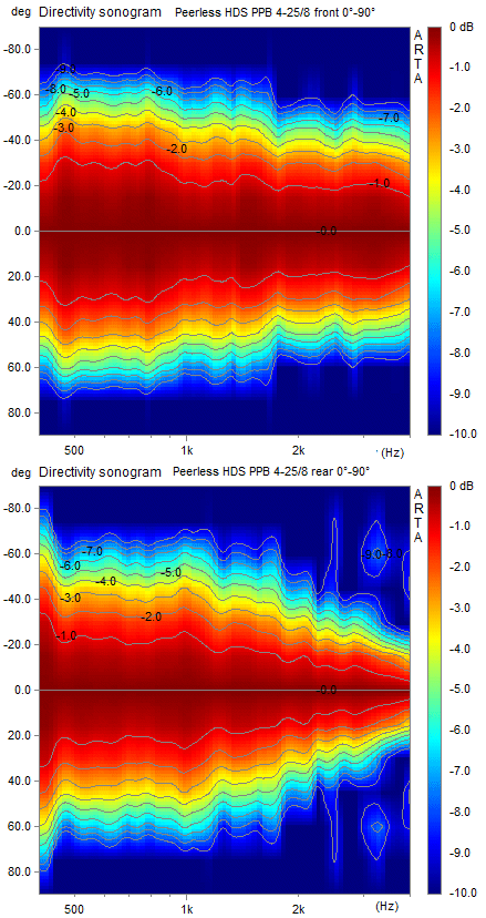

Next the sonograms for front (upper) and back (lower). I have put them one above the other with intend. Look how at some frequencies a dip in one sonogram corresponds with a peak in the other. I don't say that there is a 1:1 relationship, but obviously sometimes the patterns are reaching from front to back and vice versa:
attachment.php

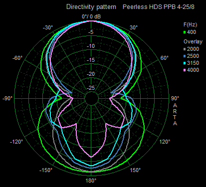

At last the polar diagram of 2 kHz and above:
attachment.php
It illustrates nicely how the rear pattern breaks up into lobes, while the front pattern keeps its good look all the time. The green line (400 Hz) is representative of most frequencies below 2 kHz.
I found it quite instructive to see the same data in three different representations - all of them leading to different insights.
