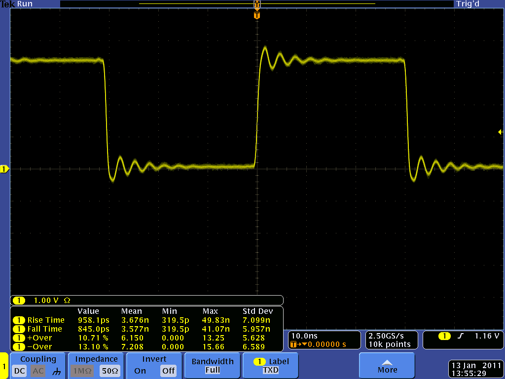

The art of signal integrity is preserving the switching points of the downstream logic on the rising and falling edges of the square wave, and keeping the time interval the same between each change of state, especially for clocks. The rest in not as critical but still important. The ringing stresses the silicon with the extra energy, causing more heat generation, amongst other things. But as long as you keep the switching points clean the wave will be recovered.
The link to the Tektronix app note shows some DDR memory waveforms, and the attached picture shows a snapshot of a real one taken on a 13GHz scope, you can clearly see the high frequency noise from simultaneous switching and SMPS etc causing ground bounce, superimposed on the wave, this is from a 14layer-5 ground plane layout. The right hand image shows some more nice and clean square waves. DDR interfaces tend to be one of the fastest these days and are becoming the memory standard, hence using it as an example. It is laying out these sort of high speed interfaces and seeing them work, that makes me a firm believer in "bits is bits", for the slower frequency interfaces it is even harder to ruin them provides good design practice is followed. Some interfaces have 100-200+MHz clocks, using good engineering practices, layout etc we should be able to sort the lower frequency interfaces used in Audio.

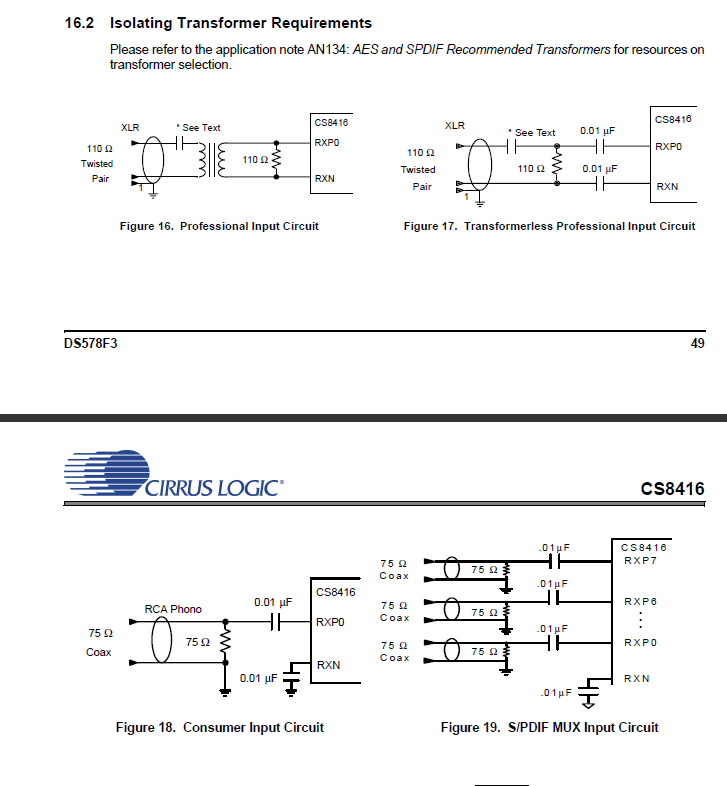

excuse me, Marce in case you missed it in my post, the Schmitt trigger part is already inside the Rx data interface input/s, read up on the data sheet about S/PDIF data input you will see it's not single ended logic levels.
infinia, What does this means for termination? Should I be concerned?
Hi new, not sure what yer Q is?
if yer asking does the input of the schmitt trigger affect the impedance of the termination ? see post 27 /attached (figure 9) of sect 8 of the data sheet shows it's a high impedance, so nothing to worry about. Since it is high impedance both the 75R termination resistor and bypass cap need to close to these pins. Ideally the coax connection or controlled 75 ohm transmission line begins or more properly ends at the top of the termination resistor (fig. 18). Simple stuff really.

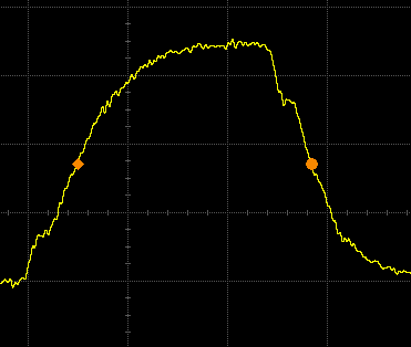

Missed the comment about the differences, the un terminated line shows ringing, this is energy that the transmitter has injected into the line that cannot be absorbed by the load, adding parallel termination at the far end will absorb this energy reducing the ringing, it does the same as the cloth Metalsculptor mentioned above. Though this dose attentuate the wave, unless a.c. termination is used (resistor-capacitor).
A good way of seeing what is happening is using a wave tank or similar with a narrow opening at one end. As the ripples (waves) go down the tank some will travel through the smaller opening but some will bounce of the walls then travel back, interfering with the waves travelling down.
In post #16 the 50mm unterminated line shows no ringing, this is because the wave got there before any returning reflections could interfere with it, whereas the 200mm unterminated line shows the reflections. In #17 both lines are terminated, showing that with the correct termination method, the length of the line can be made almost transparent to the propagating wave (apart from time to travel), as reflections are being absorbed.

infinia, what would be the type and value of capacitor used in S/PDIF termination? I saw on Lampizator's website that he uses silver mica capacitor. So this capacitor is in series or across signal to return?
Also, this covers the termination at receiving end. How do we terminated the transmitting end starting from the chip on PCB?

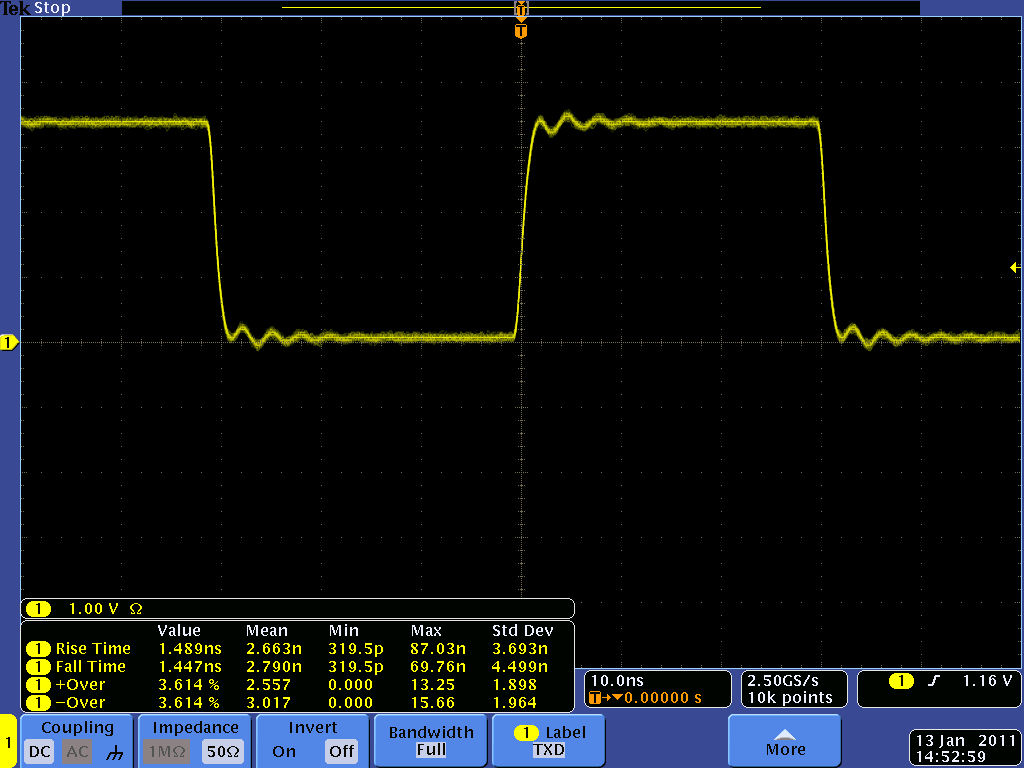

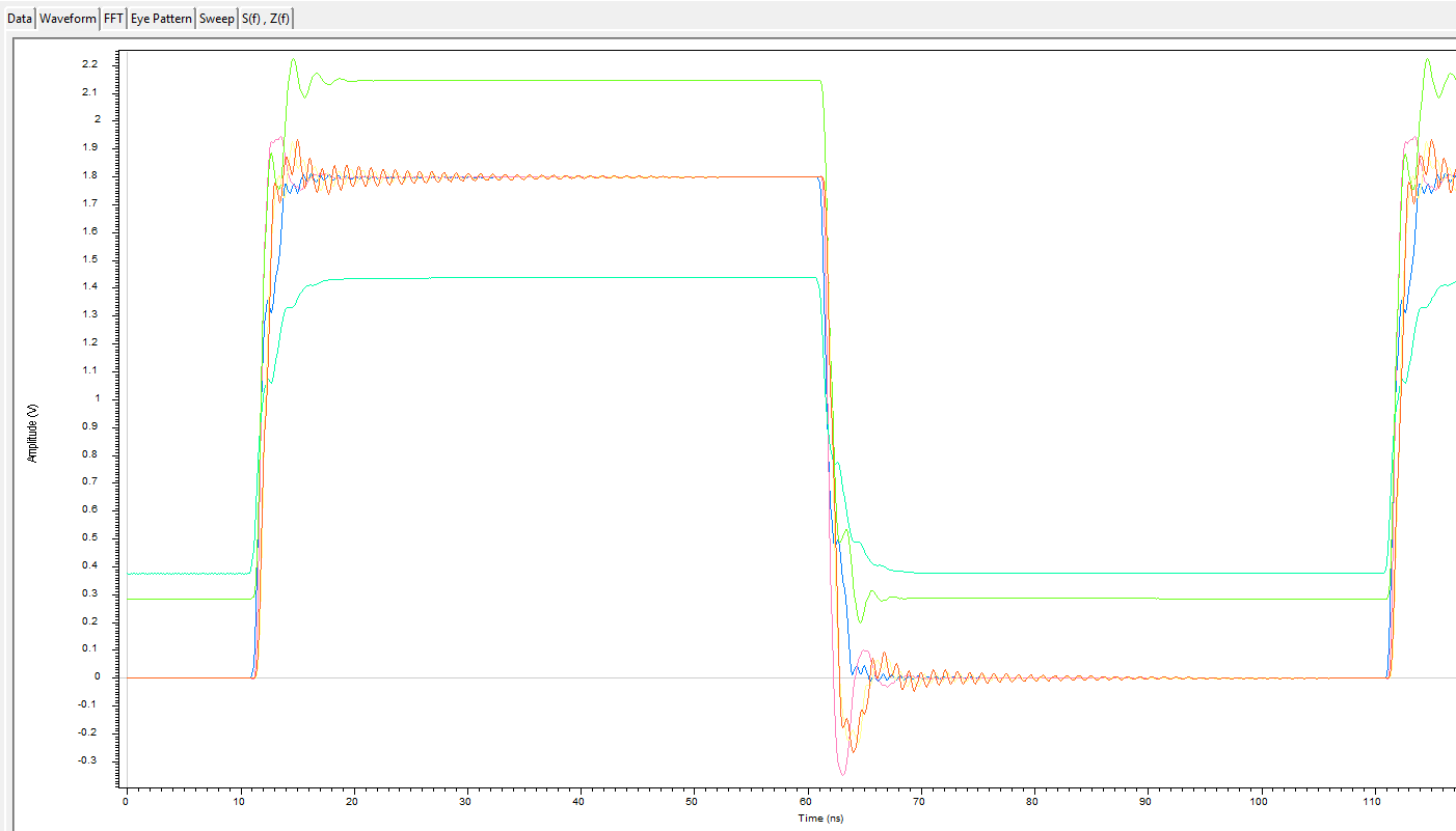

If you need to terminate at the trasmiting end, you would use a series resistor, not paralel termination. This would reduce the ringing and slow the rise time, generaly only one or the other termination schemes are used.
The screen shots show the signal with a 22R resistor and a 100R resistor, the 100R is a better match for the line Zo, there was no reciever termination.
