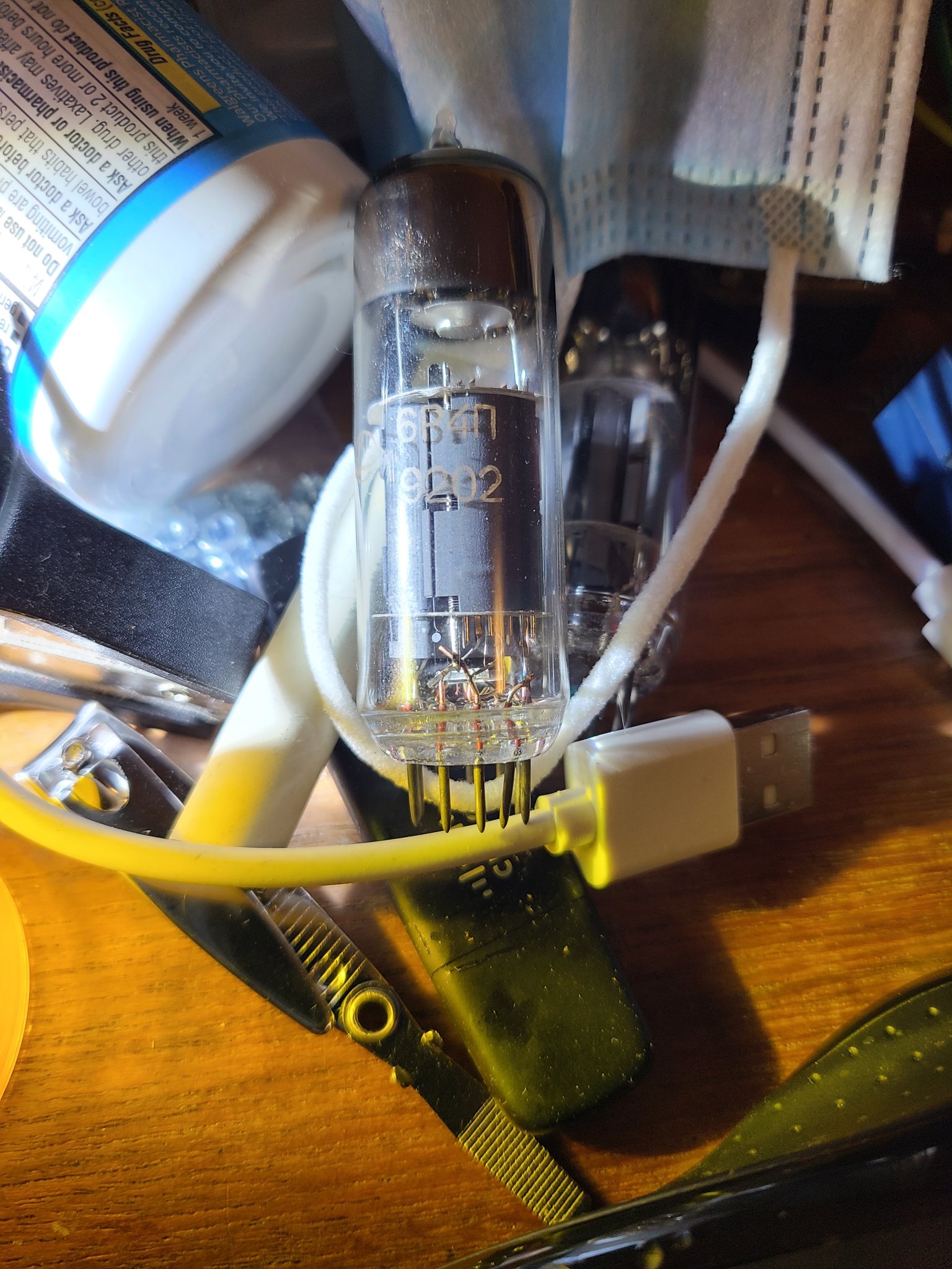

I have a Russian tube that looks like it might be a dual pentode in a 9-pin package, with a husky pentode and what looks to be a lower power pentode. the number looks like it might be 6P4P, though I'm not sure about the cyrillic character at the end. Does this ring a bell with anyone?

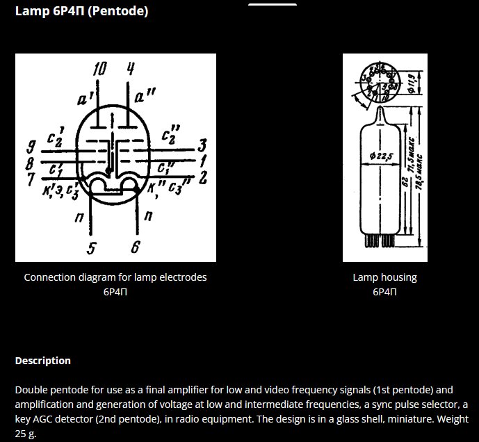

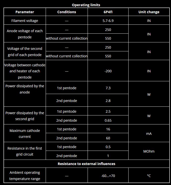

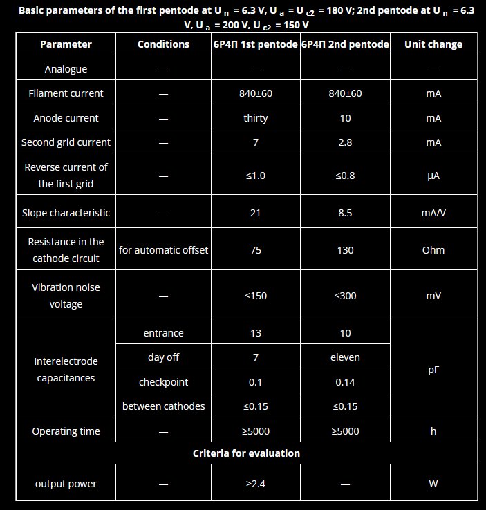

https://rudatasheet.ru/tubes/6r4p/?ysclid=lv0jp8hair548507821
They speak of it like
this - 6p4P is a curve lamp. The curve is firstly that one pentode is powerful, the other is weak. VA caracter is not a gift either. One pentode with a short characteristic for AGC circuits in receiving/transmitting equipment.
Secondly, it needs a 10-legged panel, which you just can't find yet.
It's easier to take . 6Р4П It was used in one TV model. Very ancient.

I was thinking of using this in a headphone amplifiier, but a lot would depend on the characteristics of the small pentode. Both tubes are rather slippery in terms of transconductance (especially the larger pentode, as it appears to be designed for video amp duty), so a partial "Schade" feedback scheme might be a bit problematic without some compensation for the inner loop.

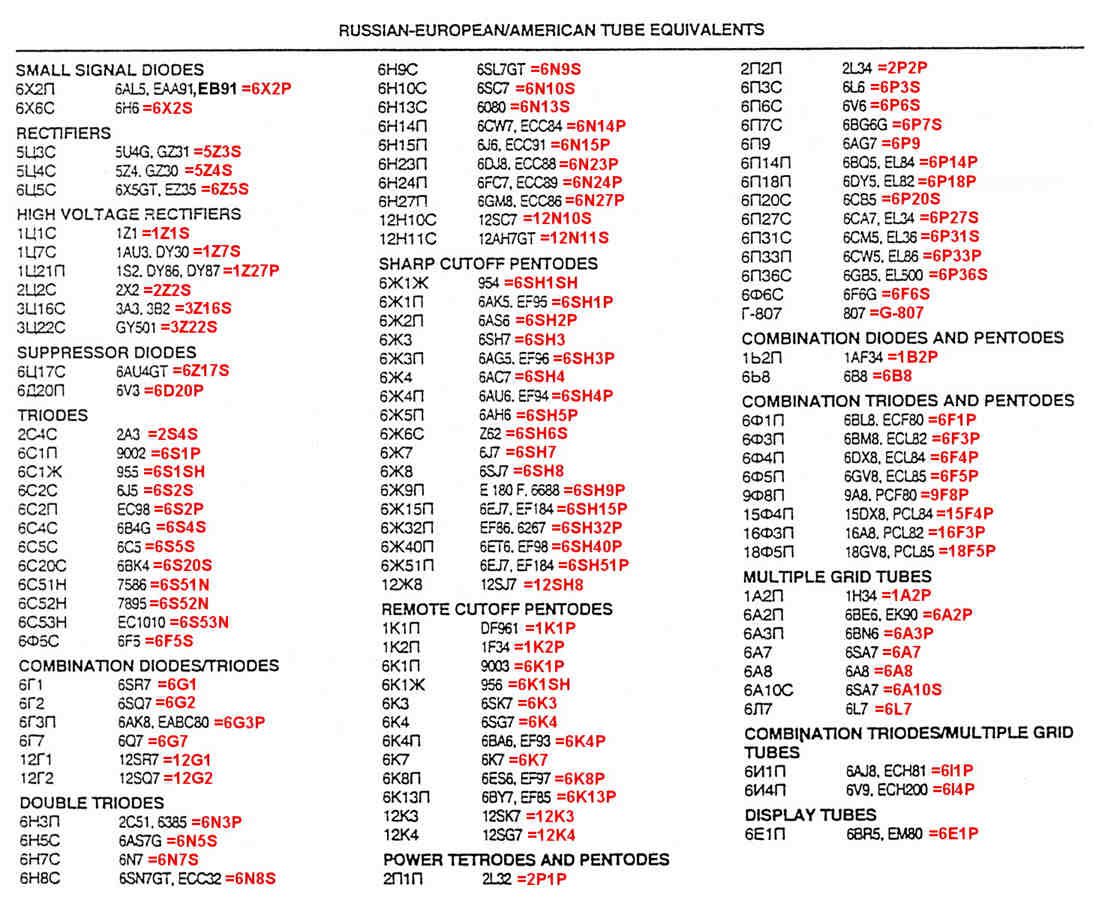

The comparison table in post 2 was published by me in Glass Audio some 30 years ago.
At the time Russian tubes were new to us and it was hard to find cyrillic characters for my
computer (probably CPM or early MS-DOS). It was Volume 7 Number 5 1995.
Somebody added the red numbers. I am not responsible for anything concerning these red
additions.
Edit : this comparison table appeared in a later issue I think.

Probably equivalent to european EFL200 / PFL200
https://frank.pocnet.net/sheets/010/p/PFL200.pdf
although it can be used for A.G.C the small signal pentode is imho not a remote cutoff;
that gm varies between 2 and 8 mA/V between 1 ... 10 mA plate current does not necessarily mean it is remote;
an EF80 behaves similarly
the translated russian d.s. has no curves though ...
