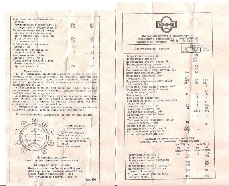

No, OTK is like an usual QC, belongs to the factory. And the OTK number means a personal number of the worker responsible for the quality. Military acceptance stamp is a diamond. "5" in it means it satisfies some very strict military criteria. "9" means it satisfies criteria for nuclear and space programs. There were many different "special conditions". Here is an example, "acceptance number zero". Earlier tubes had "star" military acceptance sign, later it become "diamond".
Yes, change bias voltage and get needed current.
